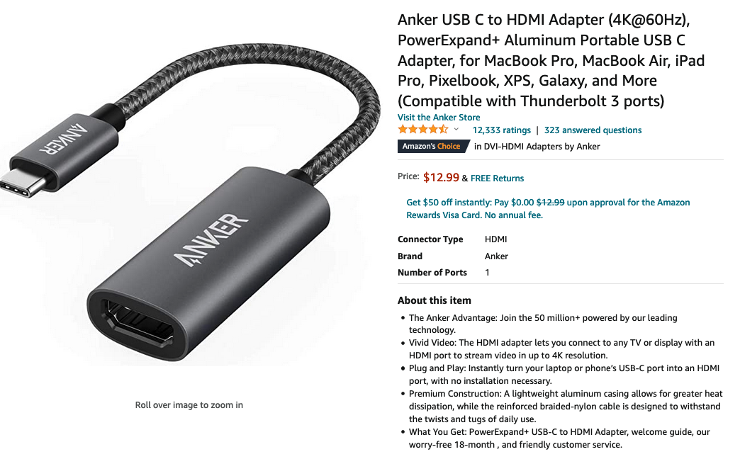

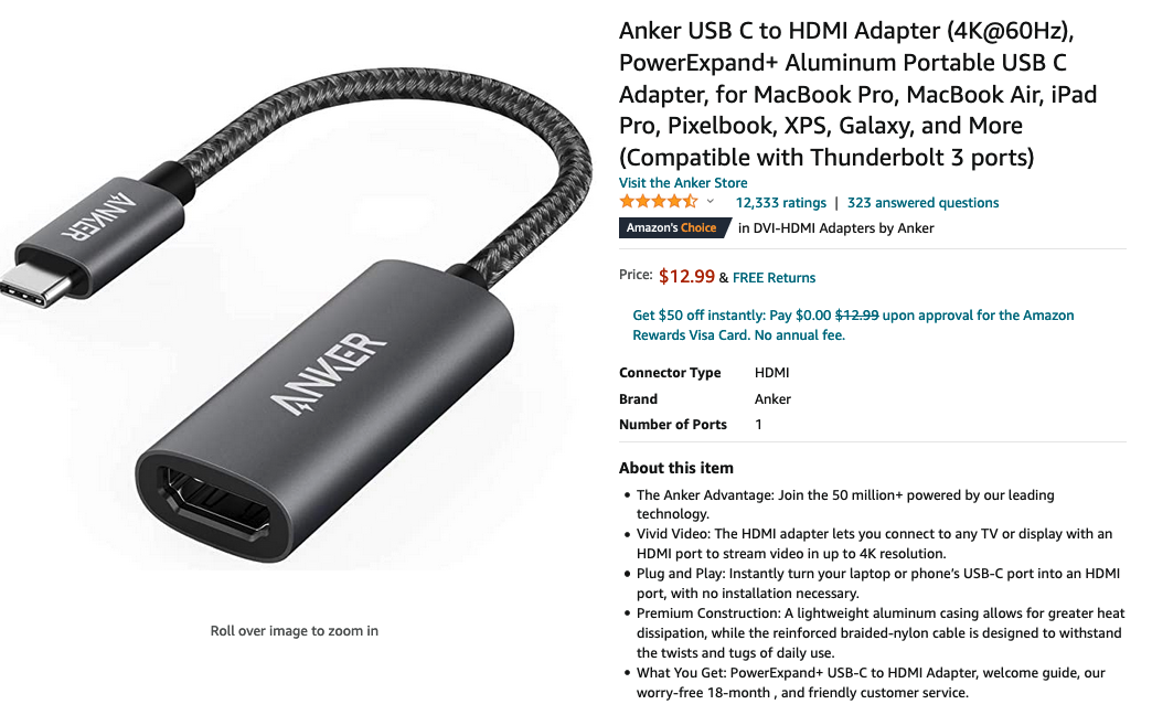

Would this work for the USB-C port going to the monitor?
