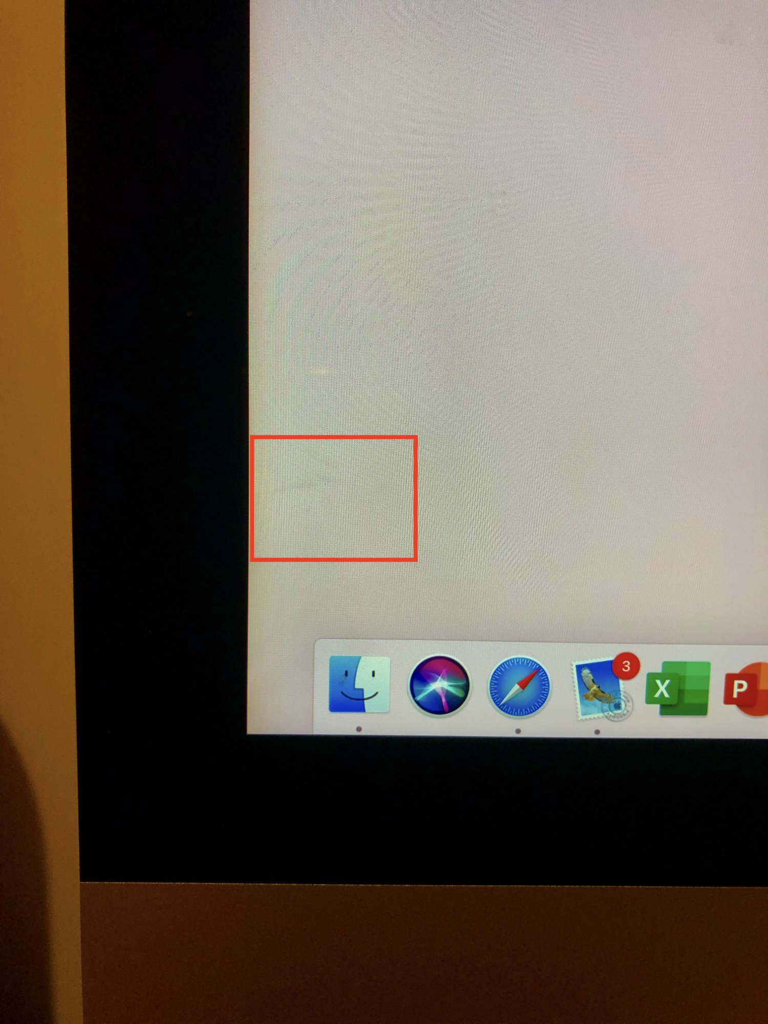

I have a late 2014 27" iMac and I have dust behind the glass, in theory you are correct the laminated displays should be better, but there are plenty of people with dust issues.

Not easy to see taking a picture with my iPhone - but the grey smudge in the red box is dust under the glass. There are a number of threads on the forum about it and it effects all iMacs. The laminated displays in modern iMacs still suffer from it, including mine.

I have never opened my iMac it is from the fans pulling air though the system.
Here is the thread from a number of people who have the issue
I thought so. Opening the iMac had no impact on the dust, it just happened.
I am not suggesting this to anyone, but I wonder if routinely opening the iMac and cleaning out the dust would help prevent issues like yours and others.
This shouldn't even be an issue, but it looks like Apple still hasn't perfected the display lamination even after all these years.
