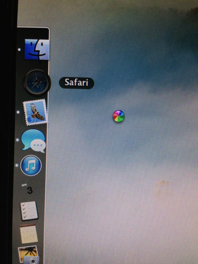

It has been working great but now I've noticed almost everytime after I leave it sleeping overnight or for a long period of time, I'll wake it up, launch safari (anything), it will run for 5 seconds, crash, then the whole Mac freezes. Beach ball to infinity. I've had to hard booth everytime. Force quit won't work.
Is there something I did wrong? Anyway I can fix this?? I have applecare but it is probably voided now after the install 🙁
Also I've noticed everytime right before it crashes the calendar app icon is transparent? Only that one though....
I really hope i didn't ruin my 1500 machine.... 🙁 I even paid the mac reapir guys $150 to do this install because I knew it was kinda challegening and I didn't want to mess it up

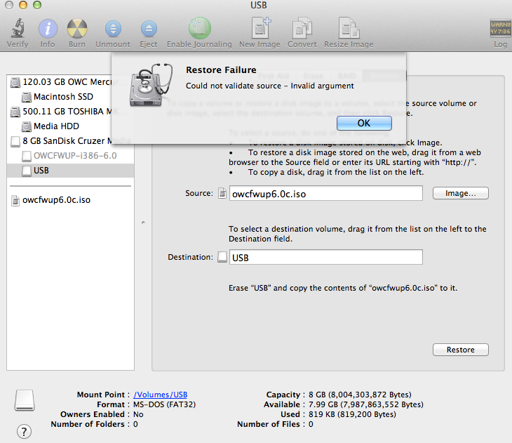

i tired to update the firmware but haven't been able to. I have the .iso file and disk utility doesnt let me create a bootable flash drive out of it... and who has DVD's or a DVD reader laying around anymore?
Why is this, is it giving an Error or what, care to explain a bit more.

Could not validate source - Invalid Argument
I found some instructions online how to create it through terminal, and I did that, but when I reboot and hold option the flash drive doesn't show up as one of my bootable options.
I had that a couple of times, then when I moved it to my Powerbook on 10.5.8 it had no troubles with it, that's why I say Disk Utility sucks now.
If you have Toast try with that.
here's what I see
