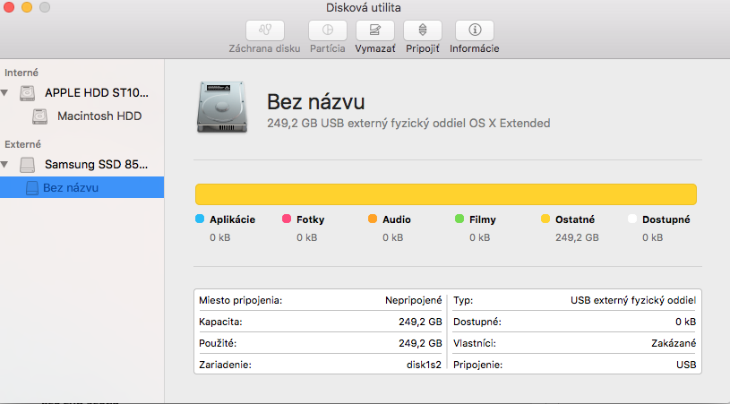

But the main problem is that SSD looks like it does not have any created OS and data partitions. Please see attachment - print screen from the Disk Utility (apple application), where it is seen that there is a partiiton without title and without data. I had a partition with a name and some data there. If I want to boot again from SSD, I have to install the OS again.
Firstly I thought that I have bad SSD or an external box. I reclaim both of that and they give me new pieso from both. But now it happens again. So the SSD and the external box will probably be OK.
Then I thought it could cause TRIM on SSD. But I found it to be quite different and I use TRIM ENABLER.
It is possible that the internal HDD is causing the problem. I can temporarily format it without OS (I have not tried it yet). However, when I used to boot an external HDD, there was no problem. Only when I use the SSD in an external speaker.
Please write me your opinion what I make to do? Thank you.
