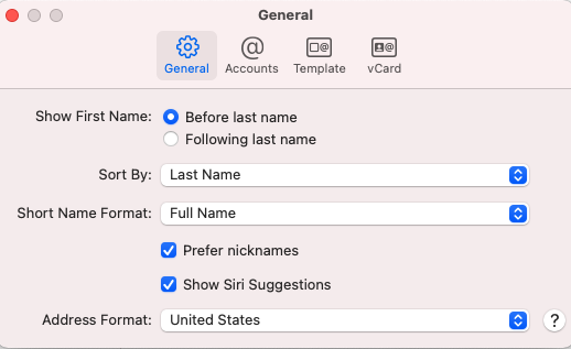

@ApfelKuchen I think they might have removed that in Big Sur. Here are the only options I have in general preferences on my Mac.

It's still in Big Sur, but you do have to have more than one contacts account enabled. If you have multiple accounts enabled, you will have another drop-down box for Default Account. Actually, it works this way on all platforms and versions of iOS and Mac - if there's a single account there's no need to select a default, so the checkbox/drop-down list is deprecated.

Awesome! I turned on a second account, and then set it, and then turned it off. I dont' know why it was defaulting to "local contacts" instead of "iCloud". That option isn't even in the pulldown.

If there's no cloud-based account selected, an "on this device" account will be created - those contacts have to be stored somewhere. Once "on this device" has been created it can continue to exist. If iCloud Contacts are later enabled you'll be asked whether you want to merge "on this device" into iCloud. Once merged, "on this device" will disappear. However, there is not an option to automatically merge "on this device" when you enable third-party cloud contacts like Google or Yahoo. On iOS there's no easy way to move contacts from one account to another (there than the example I gave previously). On Mac, however, you can drag and drop to copy selected contacts into another account.
