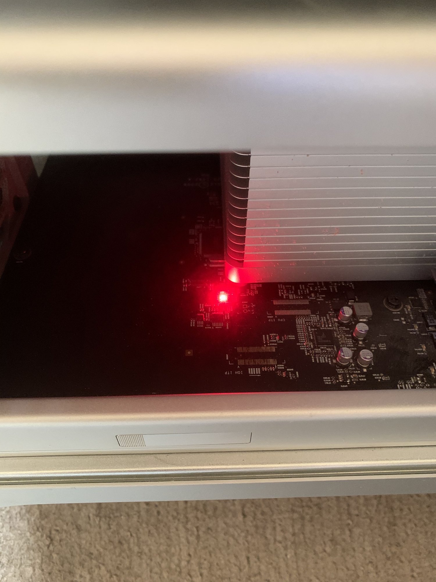

I got a continues red light on the processor tray. Power works, fans turn slowly. This morning (like 20 min ago) changed the processor for the same one (X5670 - 2.93 Ghz - 6 core) but the light still stays on. I'm not that hardware savvy to possibly find out what the problem could be. Read the repair manual (page 30 -40) and the only thing I can find is that the processor isn't there (but it is) or in overtemp state (PROCHOT). Got no video output (which is (I guess), logical. Should I still be able to reset my PRAM with a usb-connected keyboard? I'm sort of lost now, so any suggestion or direction would be very much appriciated

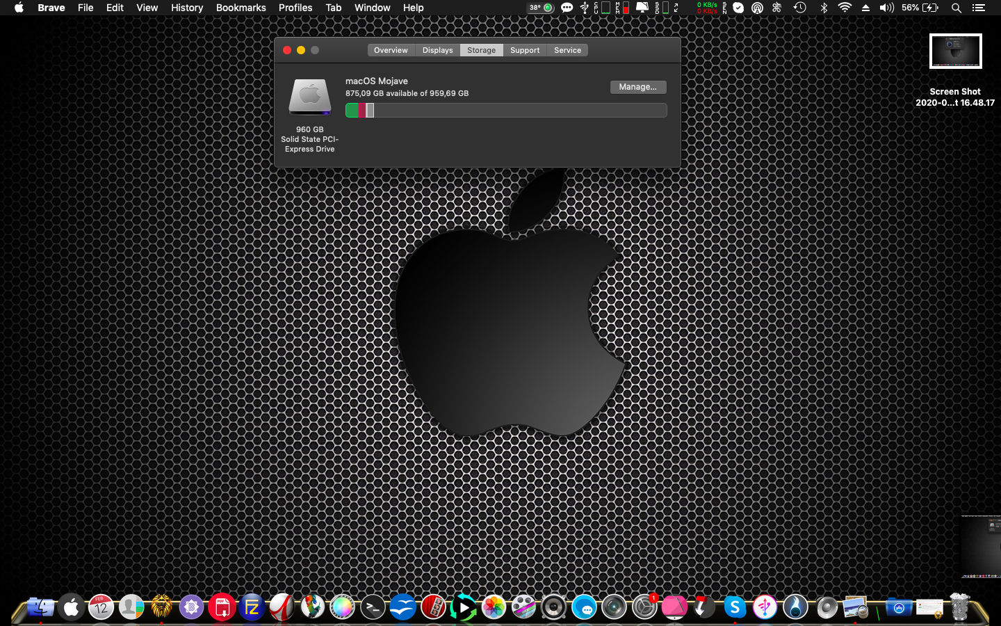

Yes, all the modules worked correctly before this problem. Got a bootable backup on a NVMe in a OWC portable case (checked that on my Macbook Air - early 2015) and that works. I don't hear a chime, so resetting the PRAM is a bit difficult. Bootrom, by the way , is already 144.0.0.0.

zie screenshot
it really is doing me in; could be the backplane? (or whatever you call it) or logic board?

I just received a DP Mac Pro 4,1 > 5,1 in my shop that had this issue . It was not a failed memory module . It was a little piece of metal in the DIMM slot of the CPU Tray . When I cleaned and let dry the Tray , the light went off .
Clean your CPU Tray with compressed air 60 PSI at 6 inches ( 150 mm ) . Blast everything , including underneath the PCB of the Tray and the fins of both heatsinks . A lot of dust will fly out , so don't be alarmed . It's a ten year old computer . Let dry thoroughly for 12 to 24 hours before installing in the Mac .
