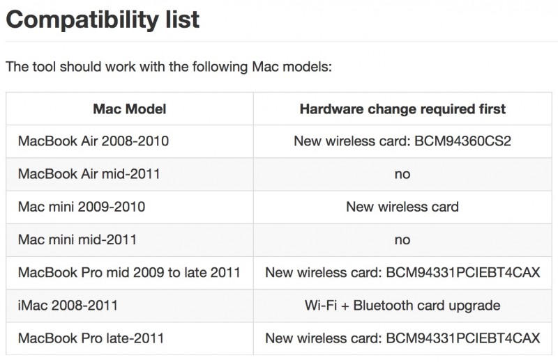

Created by Dokterdok (based on instructions compiled by UncleSchnitty) and available on Github, the Continuity Activation Tool is designed to activate Continuity by doing a compatibility check, creating backups of original System drivers, and disabling a Mac-model blacklist in the Bluetooth code that prevents Continuity from working on ineligible Macs. From there, it also whitelists Mac board-ids within the Wi-Fi code to get the feature working.
The tool can be downloaded as a zip file from Github and is installed by double clicking the app and following the instructions provided on the screen.
The Continuity Activation Tool will enable Continuity on the mid-2011 MacBook Air and the mid-2011 Mac mini with no additional hardware required, as both of those devices include Bluetooth 4.0. That means installing the tool should get Continuity up and running on those machines in just a few minutes.
On older Macs that do not come equipped with Bluetooth 4.0, new wireless cards will need to be installed, which makes it more difficult for casual users to get access to Continuity. USB dongles that provide Bluetooth 4.0 will not work with the Continuity Activation Tool, and a list of wireless cards that will provide Bluetooth 4.0 for each older Mac can be found on the MacRumors forums.
Both MacRumors forum members and Redditors have confirmed that this method is able to successfully enable Continuity on a variety of Macs, including the mid-2011 MacBook Air, the early 2011 MacBook Pro, and the mid-2011 Mac mini.
The Continuity Activation Tool appears to enable all Continuity features when used successfully, allowing older Macs to access Handoff, Instant Hotspot, SMS forwarding, and Mac phone calls without an issue. Some of these Continuity features may work already on older Macs as they use a variety of different connection methods ranging from Bluetooth to Wi-Fi, but the tool is confirmed to get Handoff and AirDrop, both of which require Bluetooth, to work.

This is such a horrible chart! 'No' actually means 'Yes - this device works'
(The macbook airs and mac minis mid-2011 WORK with continuity)
Been seeing some traffic on this. Looking forward to trying on my mid 2011 Mac Mini. My only concern is that later patches may break this, much like some of the tricks for TRIM support, and other Grey hardware.
Will have to watch The threads here, and in the OSX86 communities.
The no, indicates no hardware changes are required, the header defined that in the chart.
I can't seem to find any suggested hardware to buy in the linked article to enable continuity features on iMacs. I have a late 2009 iMac 21.5" and would love to enable continuity features on it but don't know what model of bluetooth/wireless card to purchase 🙁 I realise it's a 5 year old machine but it still works as well as it always has, anyone have any suggestions?!?!?! 😕
You have to find a wifi card on eBay...but it's not trivial to open up an iMac.
