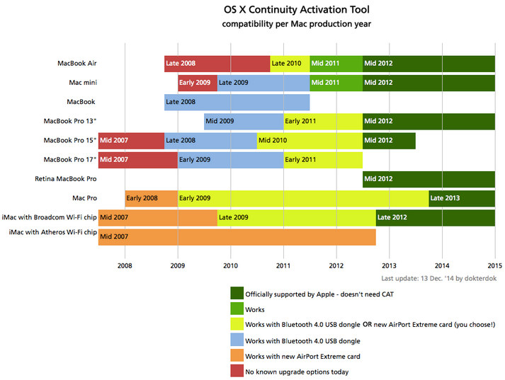

You don't understand the chart, it's a timeline graph, so, even though those are not specifically written in, they are there...it says "Late 2009" and blue line that goes all the way to "Mid 2011" then the color changes to green. Any model in between is on the blue line, so check the blue notes.
--2011 15inch MBP: check the yellow notes.
--2011 iMac, check your system for appropriate wifi chip: either yellow or orange notes.
--2010 Mini: check blue notes.
I have a mid 2010 MBP 13, it falls in the blue line on the chart.

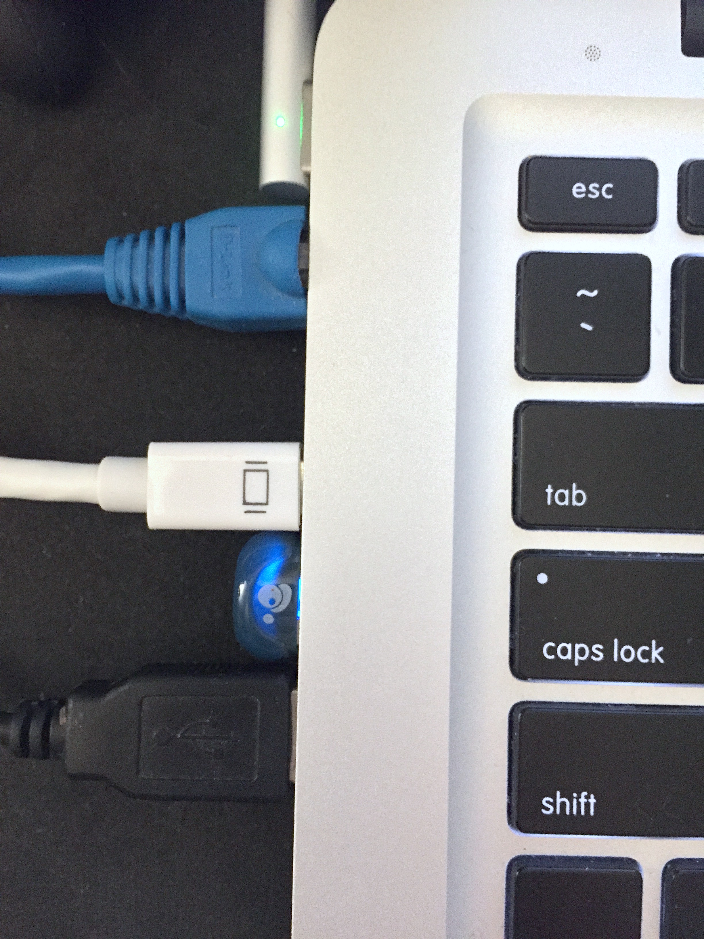

I, received the IOGEAR Bluetooth 4.0 USB Micro Adapter (GBU521) today (paid $12 on amz.). I have to note, before using the activation tool, I popped the dongle in and checked my system and it was seemingly running off the dongle, but, not really, I couldn't get my BT keyboard to work. I did a restart and BT was not working right, and then, using the tool, found it couldn't find the thing, so, I had to pull it out (tight fit) and when I put it back in, it recognized it immediately and ran the tool. (So, I guess it's best to not put the dongle in until you are running the activation tool?) Now, after following the instructions, it seems to be working, though I have not tried everything, but, AirDrop works now:D finally! And everything else looks good, got my "yes"'s, probably smooth sailing from here on, but, if any issues come up I will post in this thread.
-mid 2010 MBP 13" (MacBookPro7,1), stock 4GB RAM, DIY fusion drive, OS X 10.10.2 (14C94b) (latest public beta).
FYI: IOGEAR does not officially support Macs with this dongle, as Apple does not support BT via USB dongles, it only seems to work with the continuity activation tool. This is at your own risk, so, I am not recommending this. I only used the tool because it creates a backup and you are able to revert the OS to it's non-activated state (removes low-level system modifications). And, I am guessing, it would likely be best to use the remove function before updating OS X, then use the tool to activate again after the update. (Let's hope Apple doesn't do something to block the ability to do this in future update.)
So, with that said, I can recommend this particular dongle (see 1st para.), and it's a tight fit, so you can leave it in the USB slot with no worries it will fall out or get knocked out. With my particular MBP, I ended up putting it in the back USB slot, which allows some larger USB plugs to still fit in the front slot, and regular ones are fine, but, if they are bulky, they won’t fit. I have not tried putting it in USB hub, but, I’m guessing that’s not the best idea, but, I can plug most things into the hub. I’ve included a pic so you can see how it fits with a regular USB plugged in next to it (that’s for my hub).

I questioned the developer on the chart as well. The colors bands are inclusive between years. He intentionally only shows changes in type of support to declutter the chart.

With which option? May, 2010 13" MBP model number MC374LL/A, this chart only shows 2009 and 2011. More info on my computer here http://support.apple.com/kb/SP583?viewlocale=en_US I would prefer to update the internal card which would make better use of the internal antenna's but I guess a dongle would work if I had to.

From an earlier post (just above your post on this very page):
Also see post #109 above, I did it with a BT dongle in my mid-2010 MBP 13, works great!
