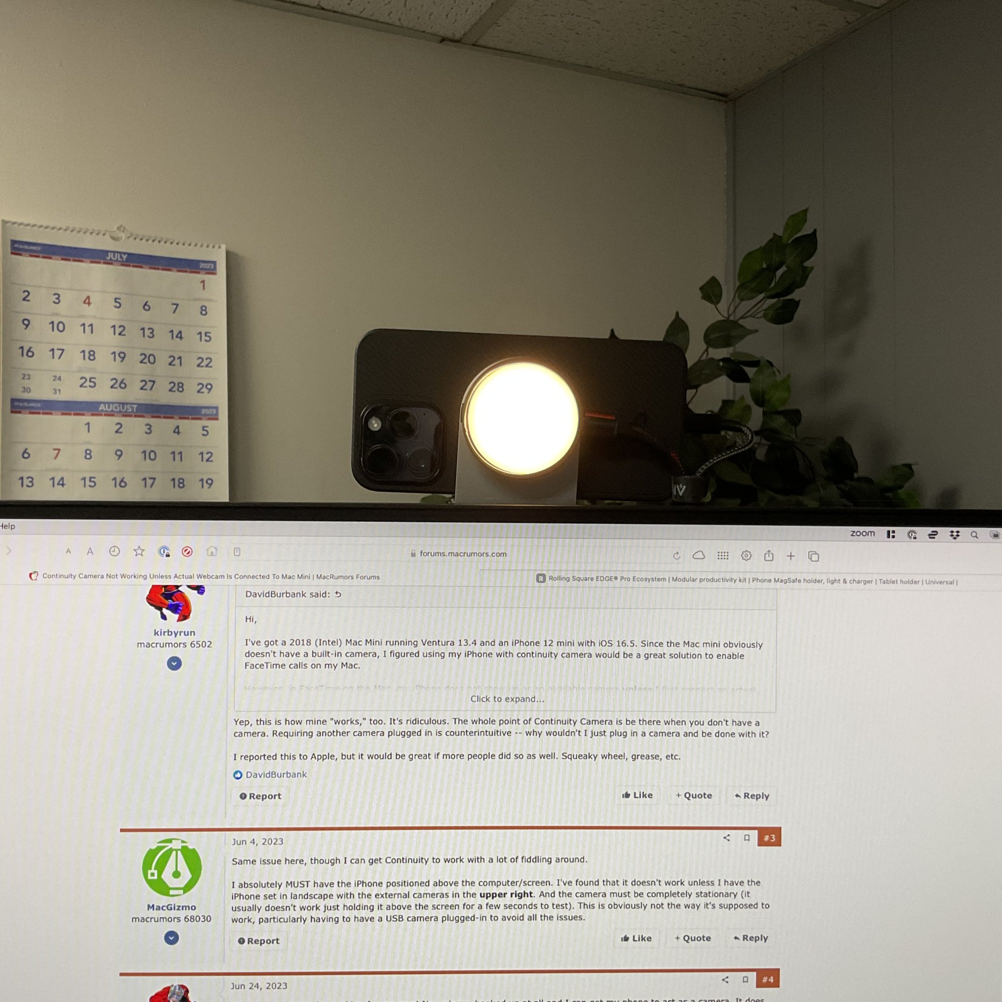

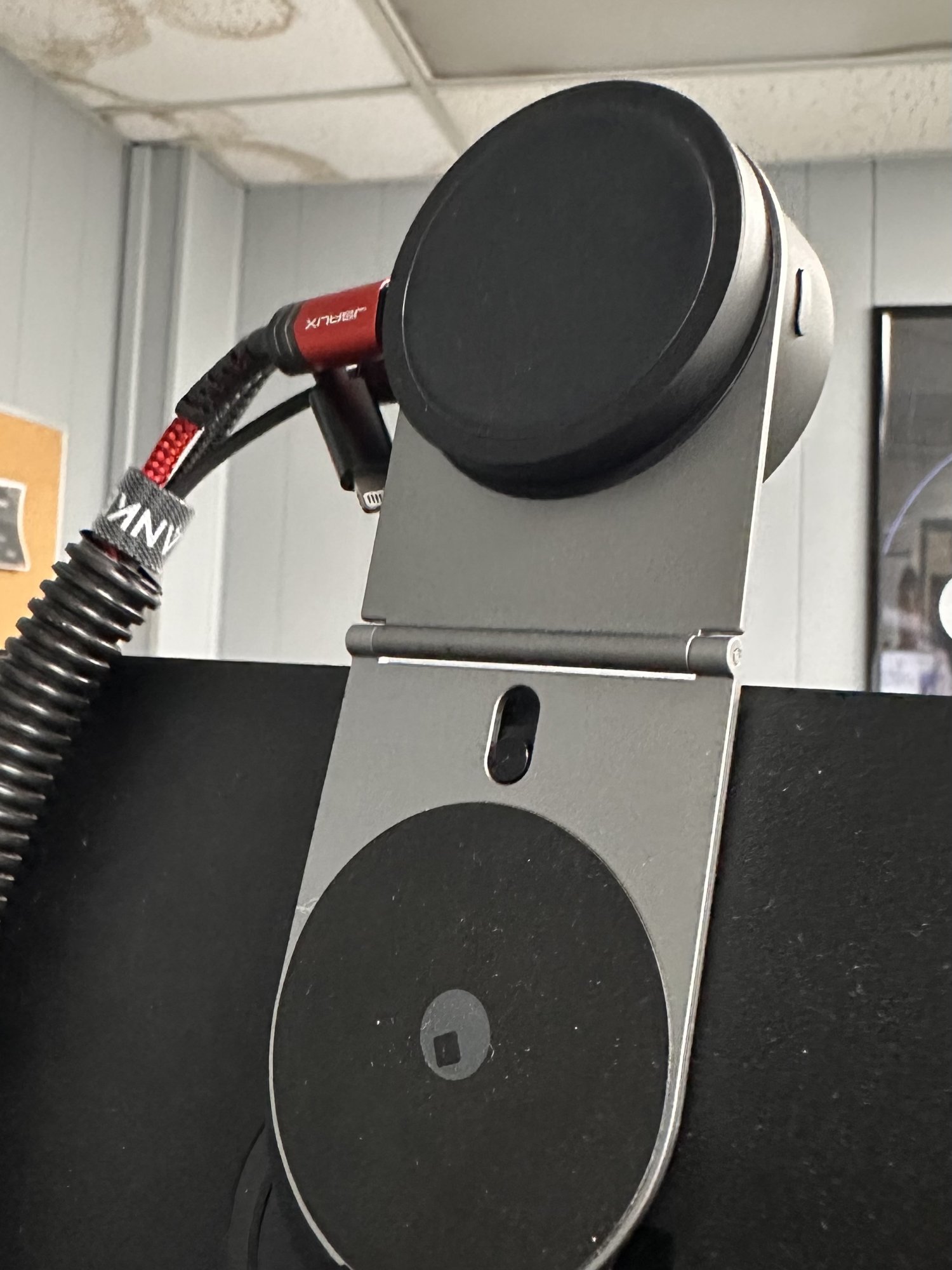

I just cut to the chase and ran a Lightning/USB-C cable to the top of my monitor and plug it in when using continuity. I am using the Edge Pro from Rolling Square to mount it (MagSafe) and provide a light. Works great! A little redundant at the moment since I am using Lightning to connect the phone.
