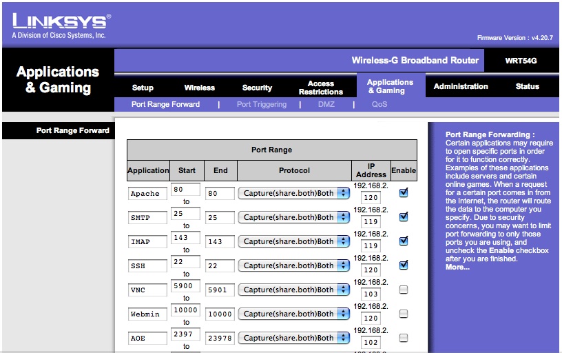

Use Port Forwarding inside your router to forward port 5950 and 5951 to the IP Address of the Mac. (see pic below for my port forwarding)
Then on the Mac, you go to System Preferences, Check off 'Apple Remote Desktop', and in the 'VNC viewers may contol screen with password' put a password that is very secure since this password will unlock your computer to the remote user and save it. (see pic)

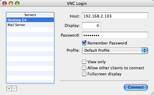

Then on the remote computer, get Chicken of the VNC, and make a new connection, put in the IP address for the home mac and password, leave Display at 0, and log in. (see pic)
You can test it out by doing this at home and just using the internal addresses which start with 192 to try it out before going to study abroad.

I'm just starting to actually do this...
Which Mac do I forward the two ports to, the iMac (the one at home) or the MacBook Pro (the one going everywhere and would be viewing/controlling the iMac at times)?
Do I need to forward port 22?
EDIT The router is a Netgear RT314.
