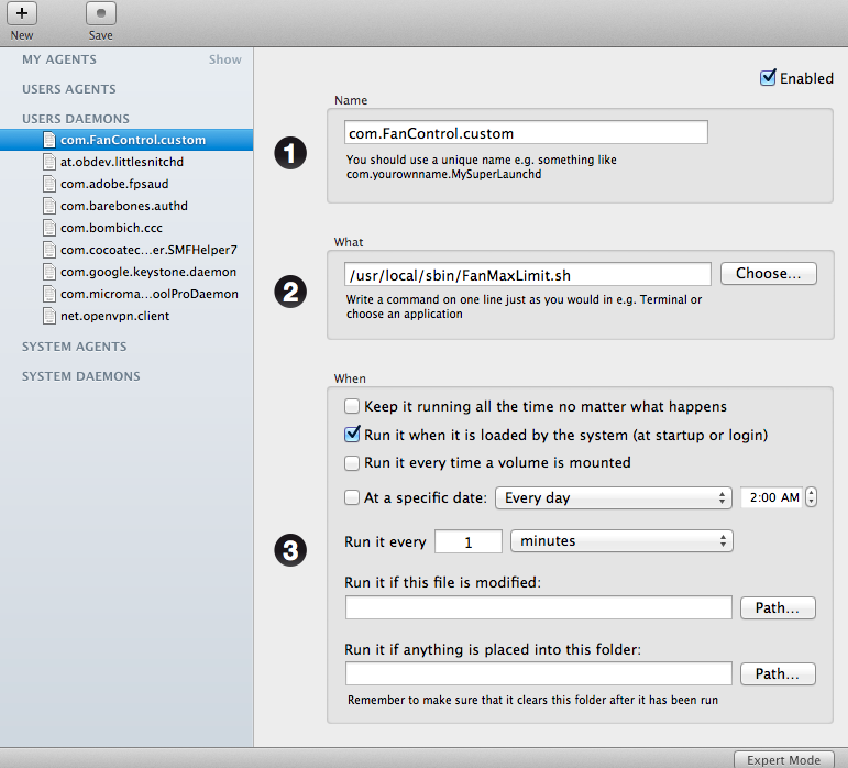

To automate these settings, create a user daemon that loads a .sh file with one of the above options and loop it every minute since waking from sleep will reset it. You can use Lingon 2.1.1(free) to create the com.FanControl.custom.plist. that loads your FanMaxLimit.sh file like this:
attachment.php
Then click "expert mode" in the bottom right and add the following:
