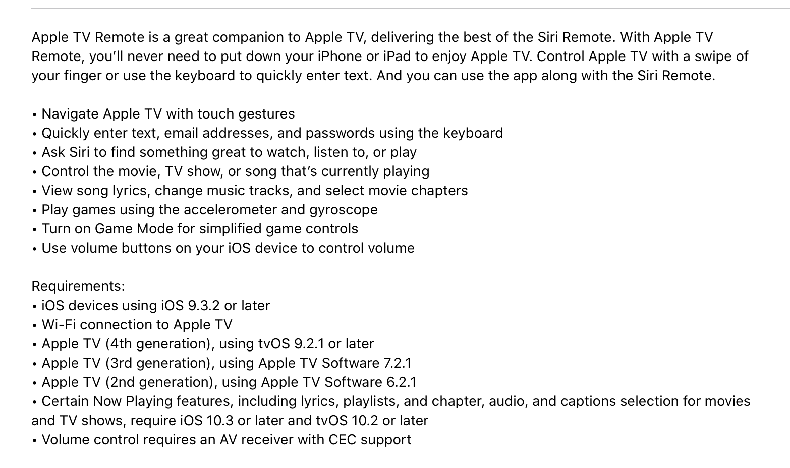

No wait ... in the App Store description, it does mention controlling the volume with your device:
I just found this on an Apple discussion thread:
”Want to change the volume using your iOS device? Receivers with HDMI-CEC volume support let you adjust volume with the volume buttons on the side of your iOS device. You just need to plug your Apple TV directly into your receiver and not into your television.”
But ... it’s not really the same as what the App Store description states.

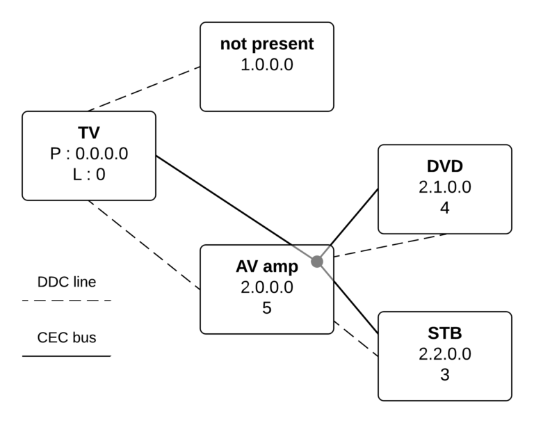

It does not matter which HDMI port is used, because CEC is a single-wire system througout the HDMI network:
Source: kwikwai blog 1 and kwikwai blog 2
