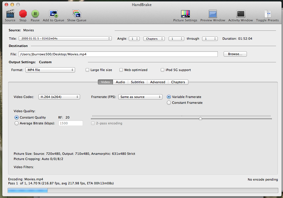

Loaded AVI into handbrake. It only gave me two choices, neither of which was MOV. I selected mp4, waited 20 minutes for it to convert. Would not open with Quicktime. Here is the screen shot of the handbrake converting. Now going back and encoding using MPEG-4 (FFmpeg)
