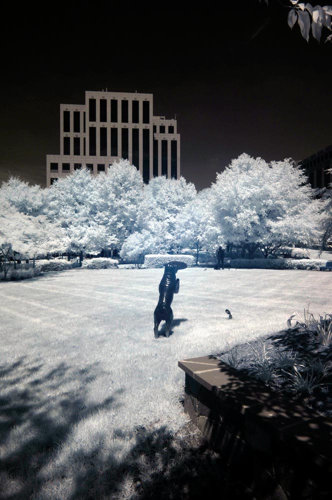

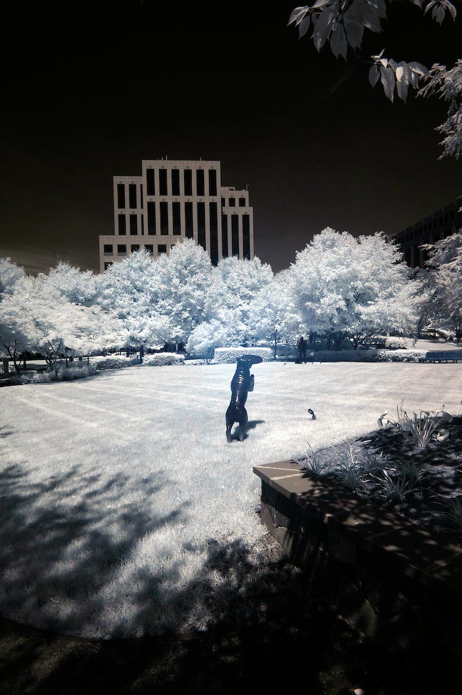

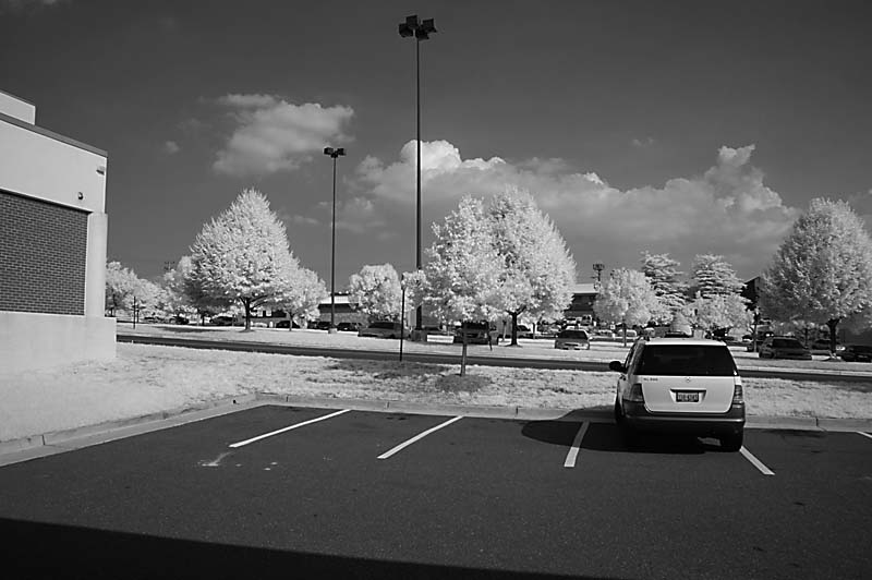

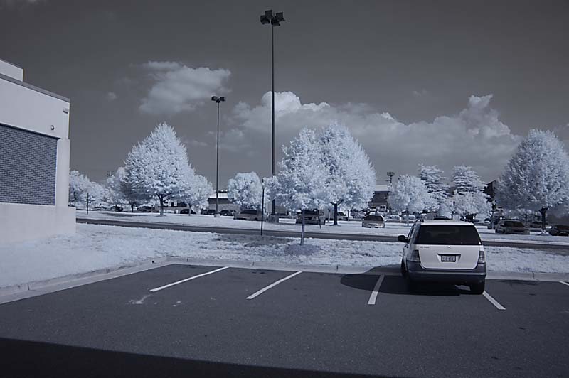

I did some quick tests yesterday to make sure everything was at least working. Today gave me some more time (relative of course). So here are few shots in this post and a follow-up post of what I have gotten so far.
Keep in mind I am on my PB 12" and have not done a monitor calibration on it. I also thought I would just toss out some uncorrected images (other than for some unsharp mask work in PS CS1.
Life Pixel sent the camera back with the WB preset to their preferred method of green grass, and exposure compensation set to +1.7. The first two photos are showing their settings and the same converted to B&W using the PS CS1 grayscale method.
Followed the same methods above, but with a +.7 exposure compensation. Only because the D50's LCD made the images look light to me. The final image was with the auto levels in CS1.
All these first test images were done with my 18-200VR. I have not done tests to see if the focus adjustment they made for the 18-70 is spot on for the 18-200VR. I do have a used 18-70 sitting in the wings if I need more accurate focus at wider apertures. It should be noted that today was one of the DC days of haze and humidity. These IR images show much clearer detail between the sky and clouds.
I hope to test focus further this weekend. Also will try to test the focus with my other lens this weekend too. As well as trying out the IR flash filter that comes with the R1/R1C1 macro CLS kit.

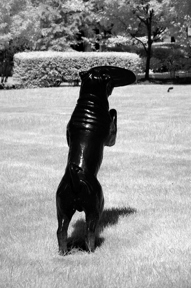

This next series was shot at 105mm, the ones above were at 18mm. Same trio of file settings as the last three.

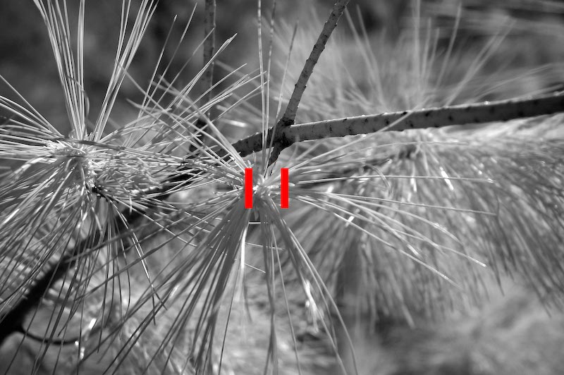

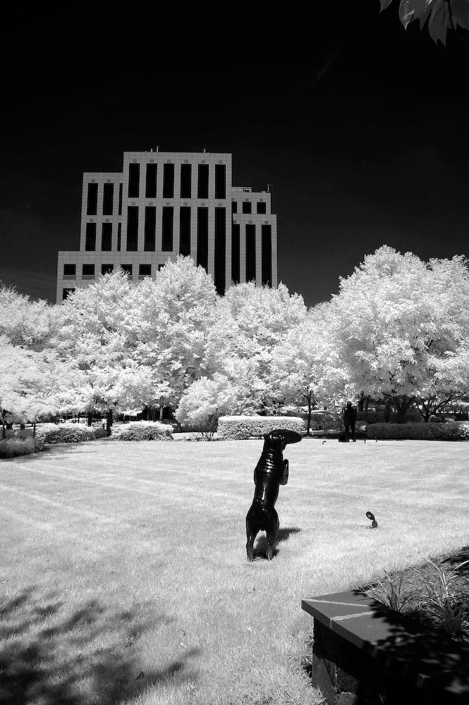

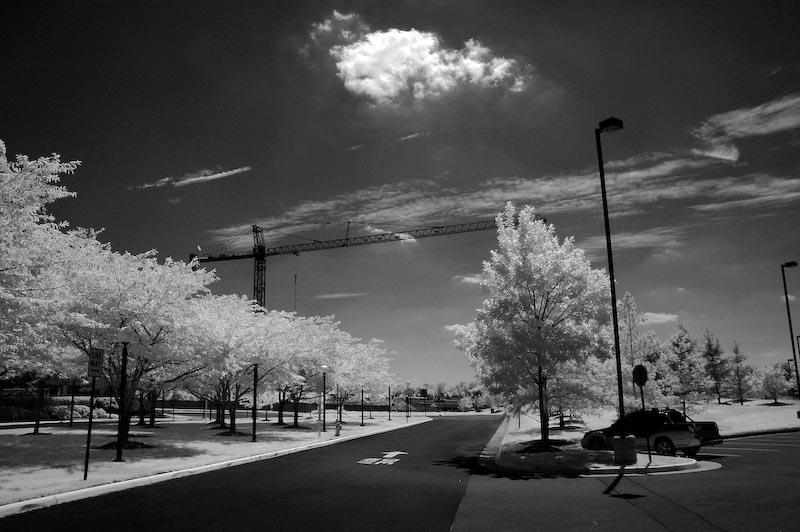

Some recent tests with the Nikon 18-70
Been having a tough summer, so haven't had much chance to go shooting. These are some test shots that I did on Aug 6th.
Still playing around, so I had to do auto levels, and tweaked the sharpness a bit. And converted to B&W via PhotoKit using the 1/2 Yellow contrast filter setting
The Nikon 18-70 seems to be flawless with the D50IR, no hot spots as shown by these images.
The last image shows a slight back focus in doing close focusing with the Nikon 18-70. The red lines shows what Nikon Capture said was the focus point. Given the easy instructions on the LifePixel website on adjusting the focus, I am sure that I could fine tune it if I wanted to. I may try some tests just stopping down more to see how that goes.
Given the quick results that I first posted when the body came back, I did not take the Nikon 18-200VR out for this test. Wish I had. Some further testing is needed with that lens.

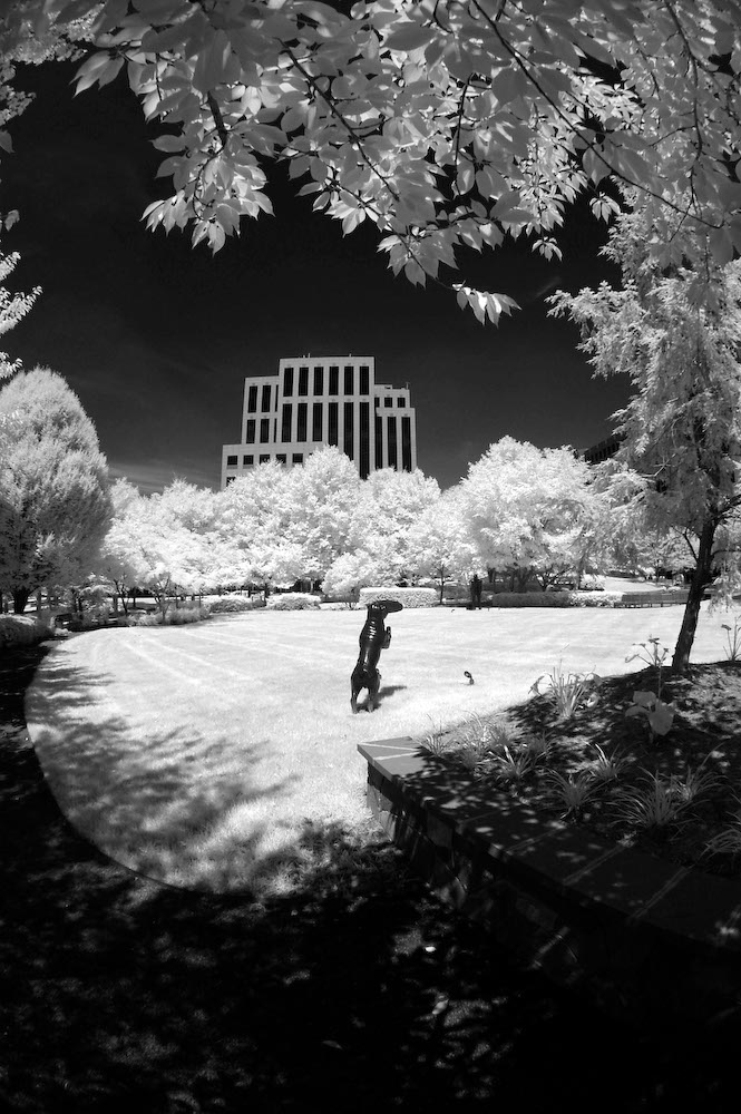

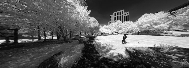

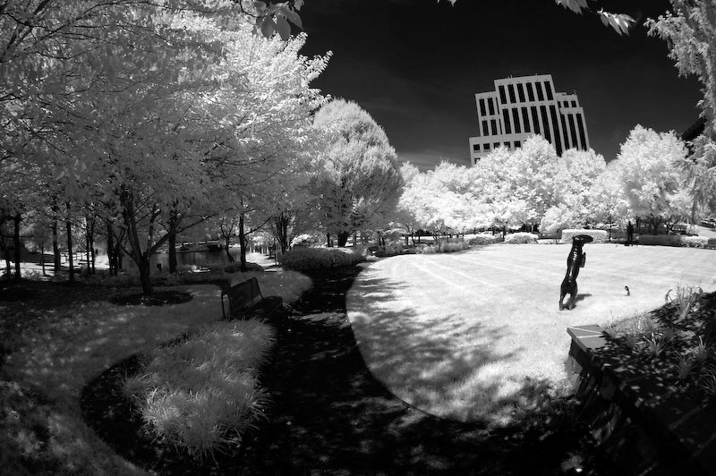

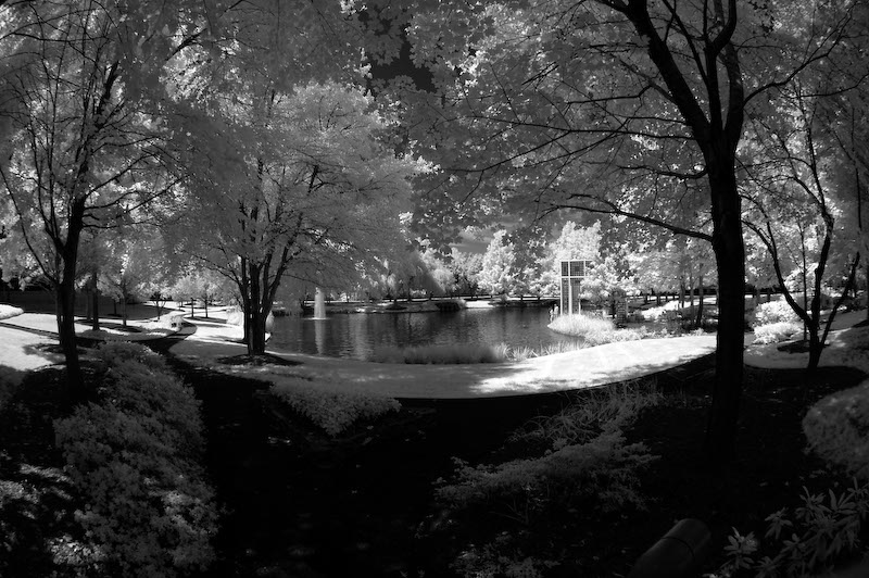

Some recent tests with the Nikon 10.5 fish-eye
It seems that this lens is OK as to hot spots.

Some Nikon Capture 4.x examples of the 10.5 fish-eye
These are some some samples of the original file and the corrections allowed under Nikon Capture 4.x. Very surprised at the results compared to my other fish-eye tests with the program.
