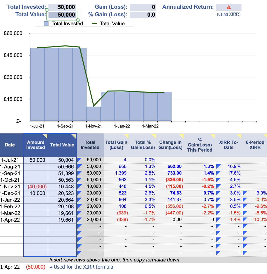

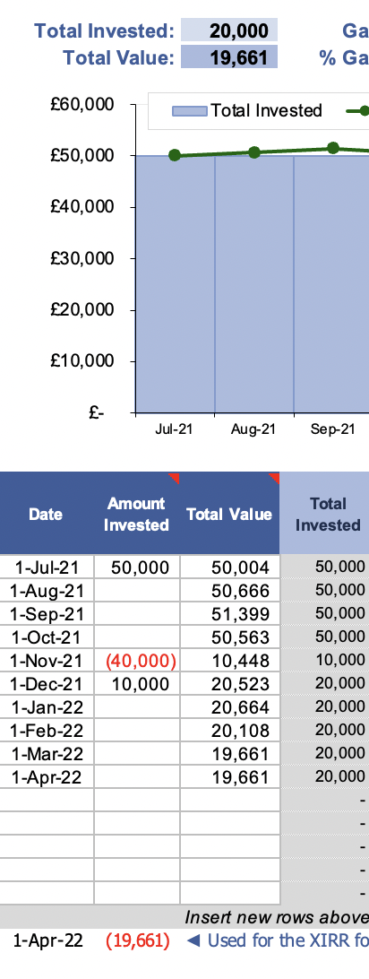

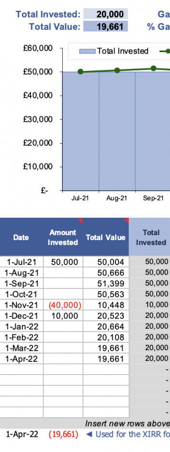

That does not seem to work if you look at the screenshots, numbers seems to return the first value rather than the last.
The “1” in your formula tells it to pull the value from the first column in the range provided in the previous function argument. If you want the data from column D, for example, this argument would need to be “2”.
If you want this value to change based on the current date, then you’ll need to build a formula to calculate which column to retrieve data from for your chart.
