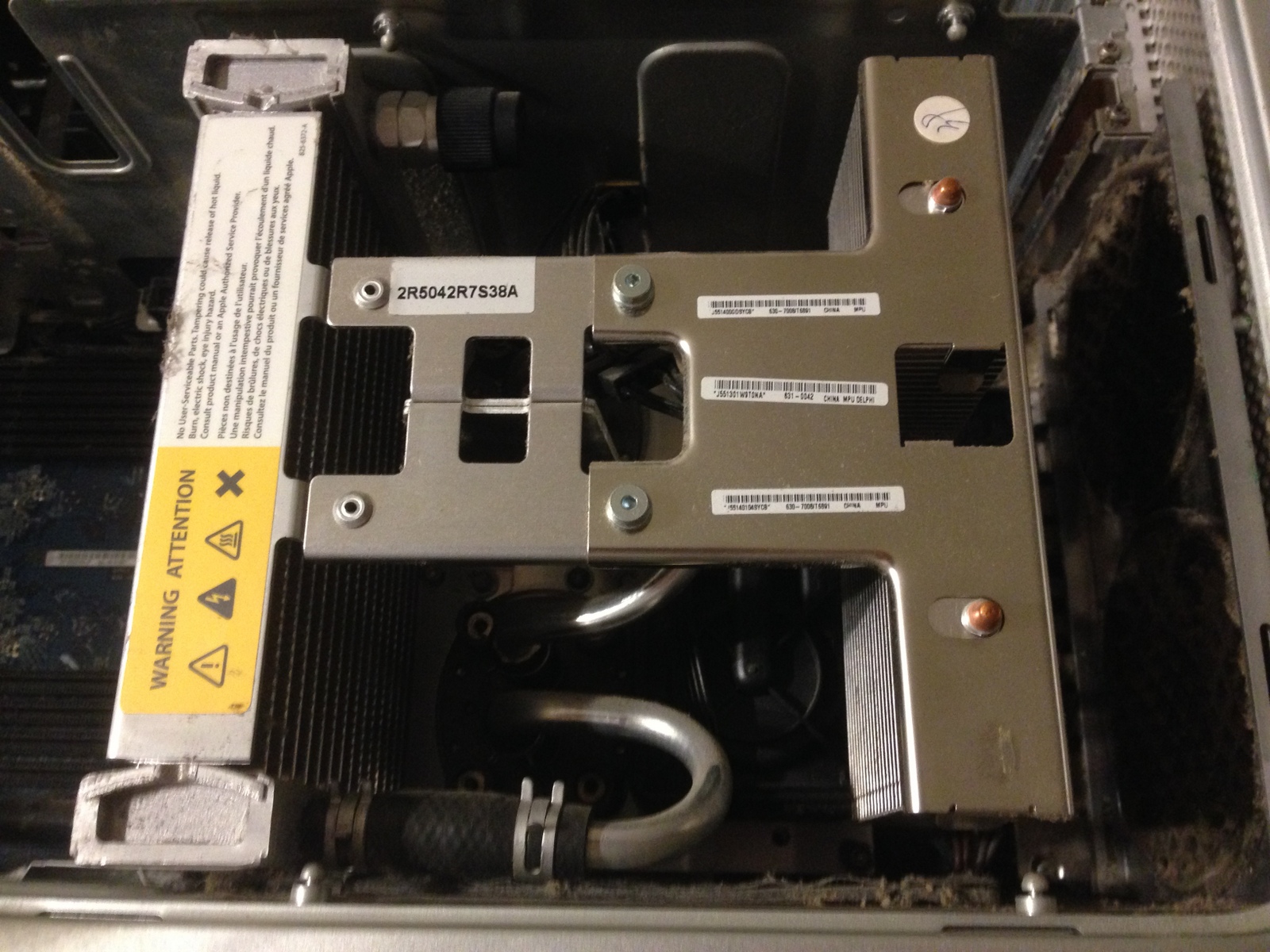

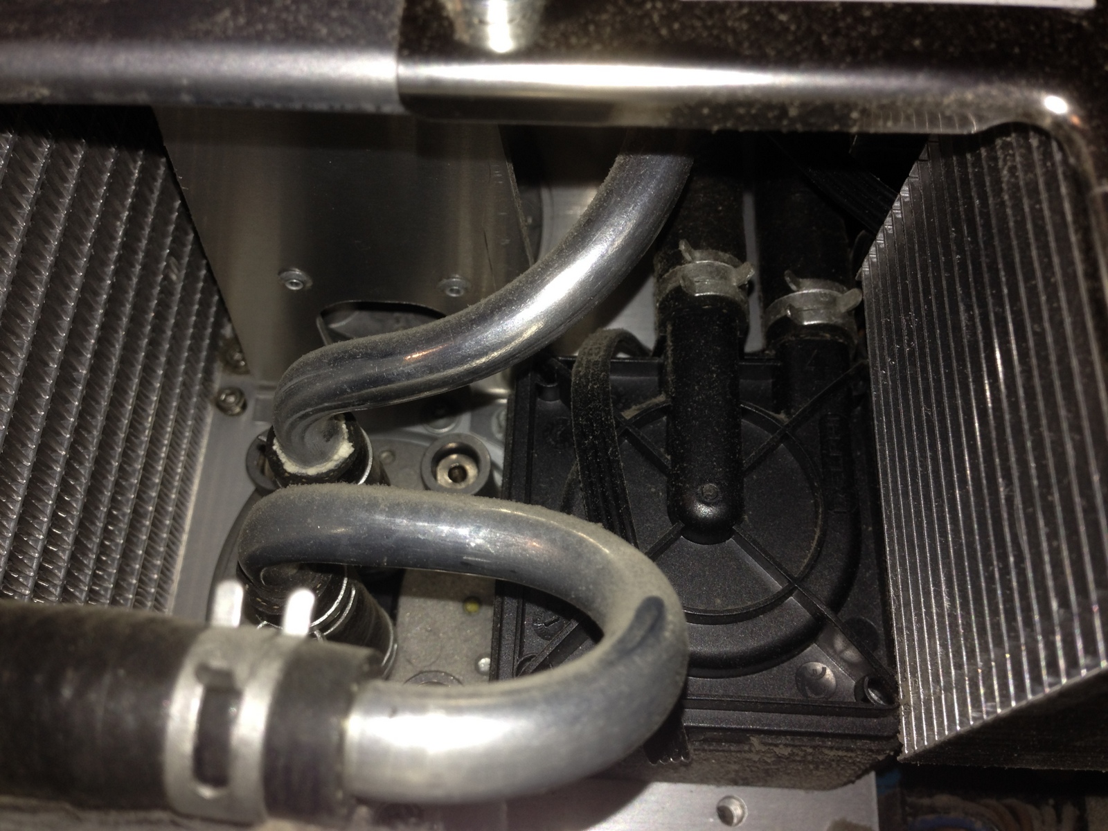

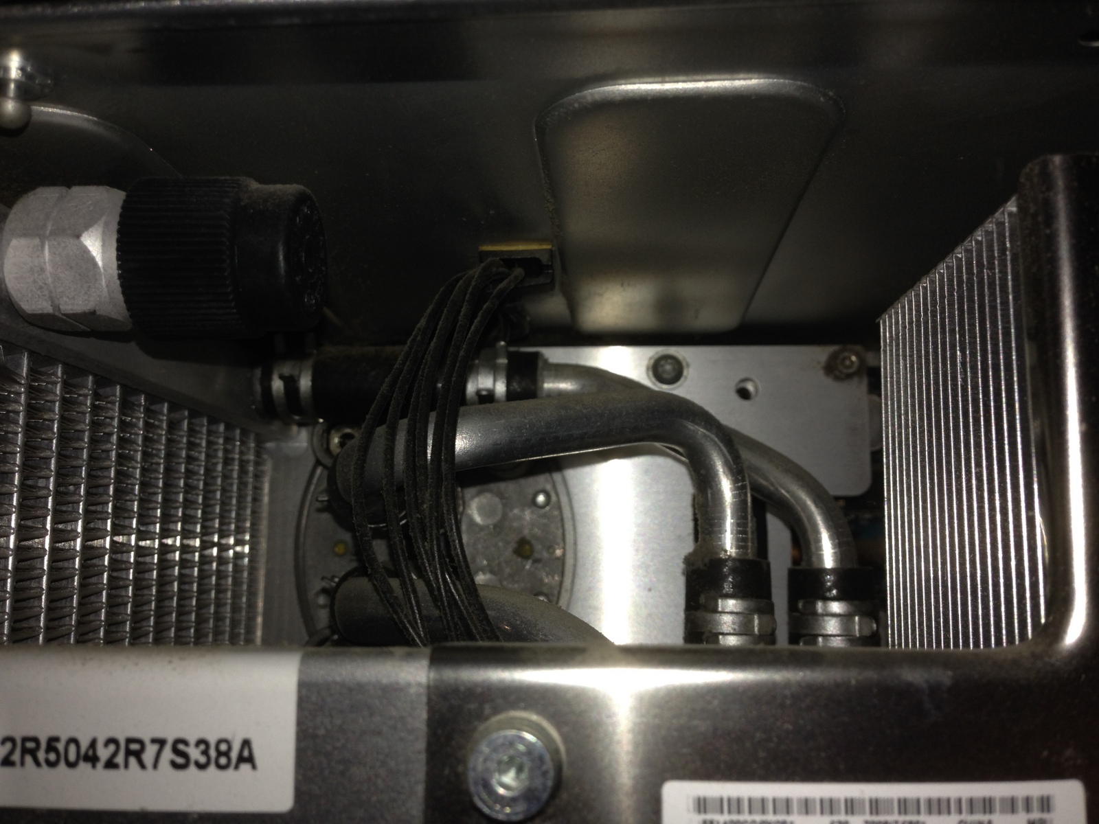

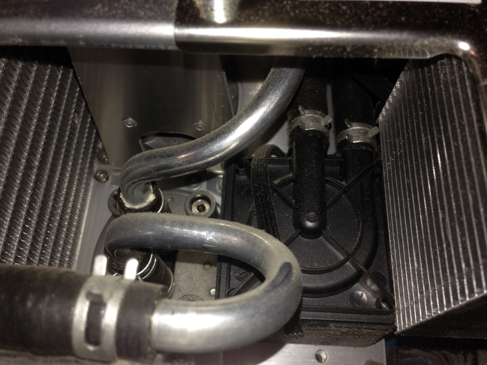

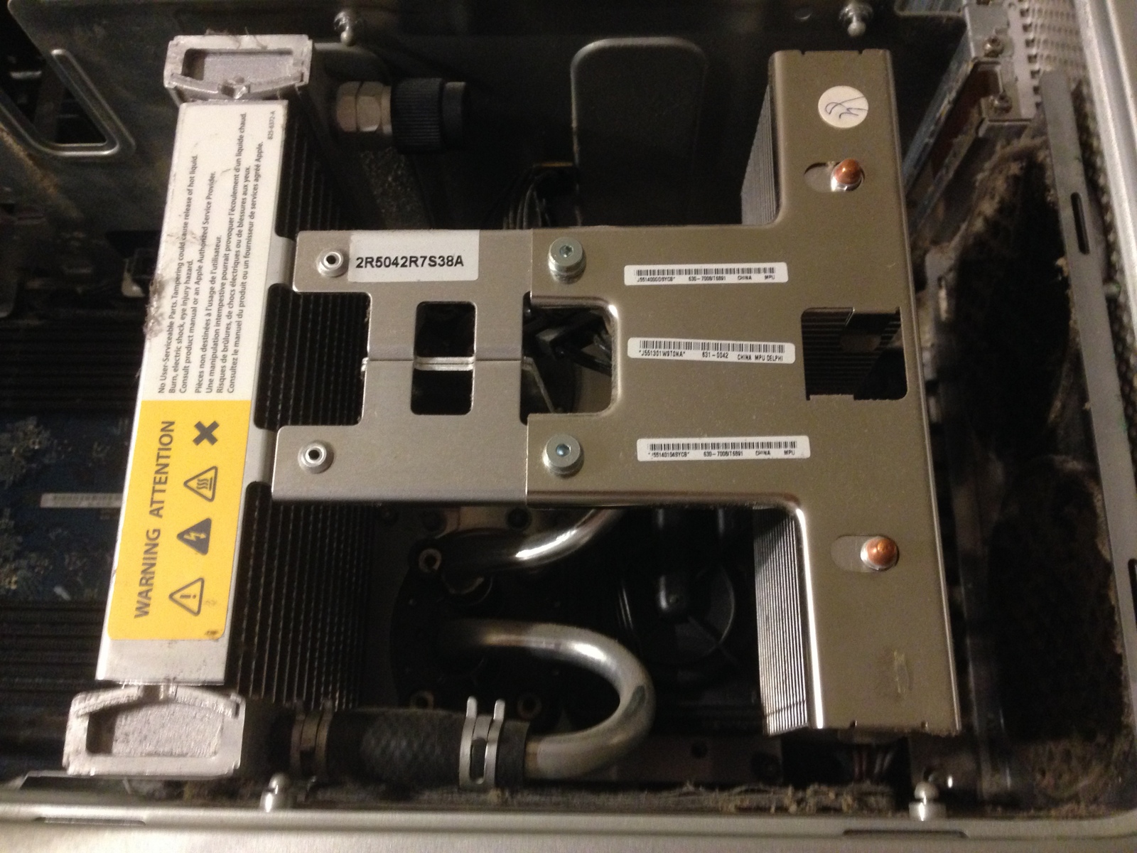

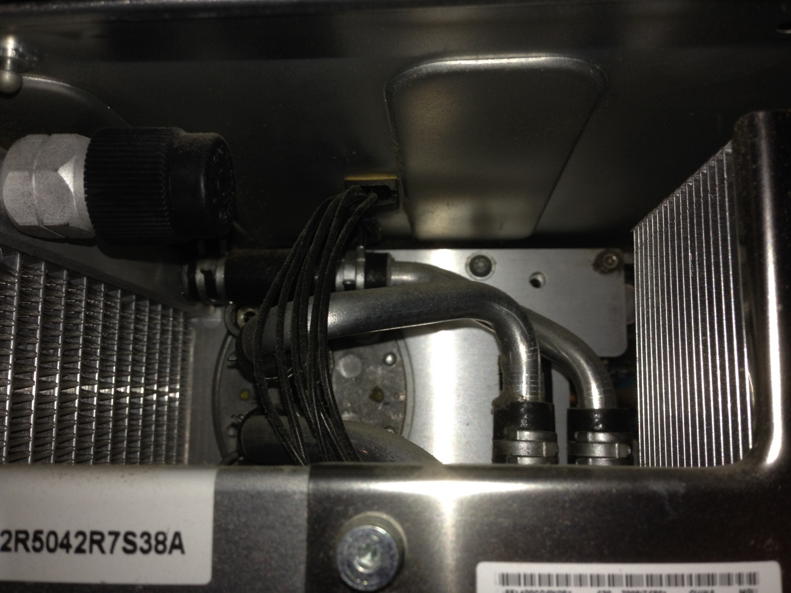

So, today I've been dissecting the G5 (by dissecting I mean I finally got the damn heat sink cover off) and got a good look at the LCS. It looks like Apple may have replaced it at some point. The beach balling probably was due to the processors overheating, but not due to the LCS leaking, no. Just a bunch of crap in the fans and radiators. It was in a very dusty environment.
I will need to take a trip to Sears tomorrow to pickup a long handle T10 screw driver to take the whole assembly off. It does show signs of leaking, although they are not that bad. All I see so far is some corrosion on the PSU (that white, kinda rice looking stuff) and some "rice" build up on one of the connections.
While doing this, I figured I might as well fix the damn thing so does anyone have a good repair guide for a dual 2.7GHz Power Mac G5 LCS? I may try my hand at it. I don't have much to loose (I didn't pay very much for it)
No matter what, a full teardown of the machine needs to be done. It just bugs me to see a computer this dirty, plus its good practice if I ever do get a G5. Maybe this coming weekend (hey my birthdays this weekend!) I'll tear it apart. I'll also check the LoBo while in there for damage. I don't think the liquid went far, though.

Here are some pictures:
