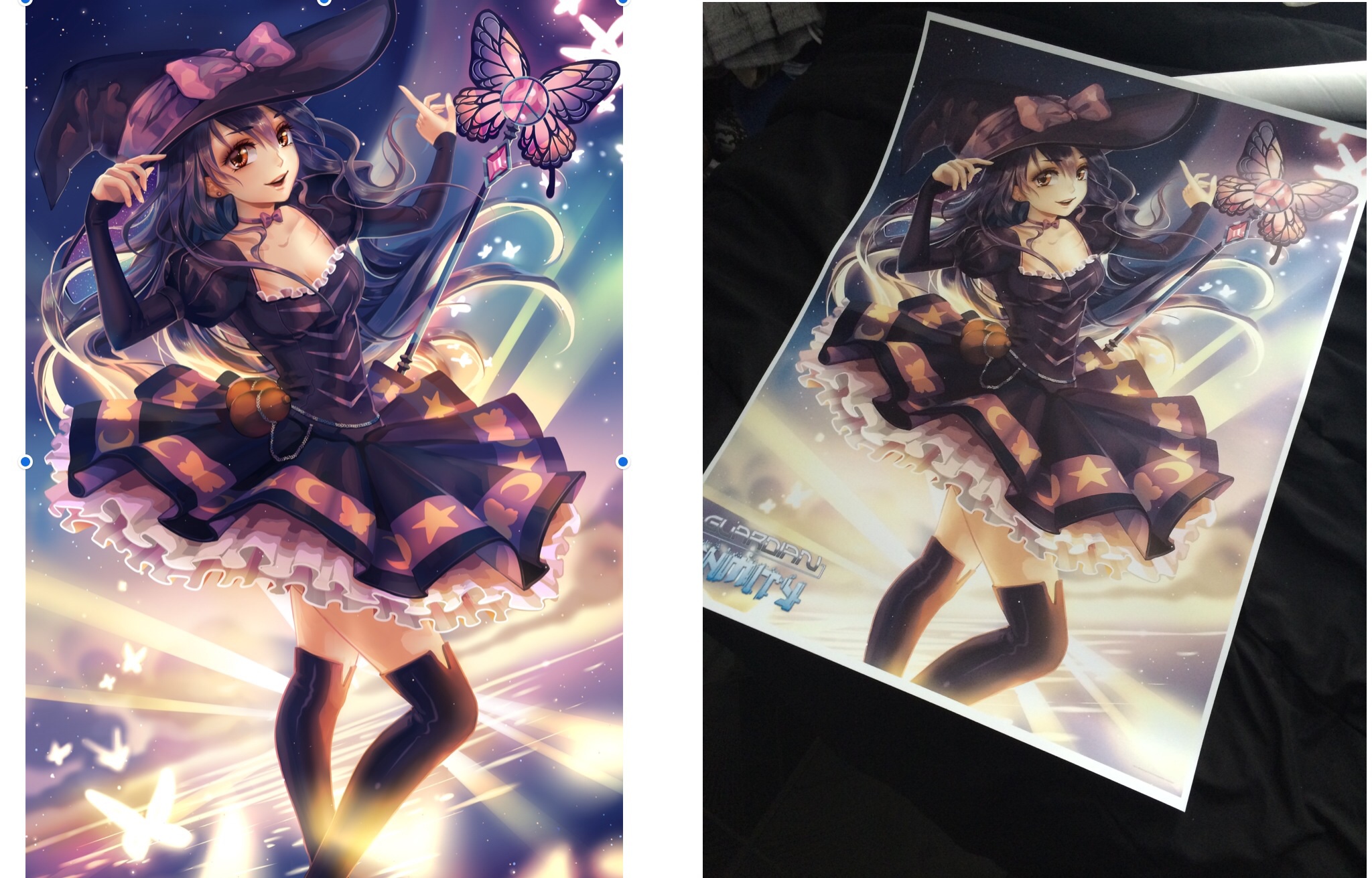

Hey everyone! I'm going to be ordering a big poster print job this week. These posters will be sold and some given away at certain events. The site requires me to have a PDF CYMK file of the image. I'm an amateur pixelmator guy and discovered there's no CYMK, so I used photoshop. I ordered a test print at Office Depot after the CYMK conversion before making the order to see if the image lost quality. The image looks great (I sharpened the image a bit), but the colors aren't vibrant...
I've printed this image before without manipulation, and the colors have always looked great.
Does anyone know how to keep the vibrancy of the image? Or at the very least not so bland? Maybe I can hire someone here who can do it for me?
The attachment shows the original image on the right and the left image is the poster print out.
Greatly appreciated. Thanks!

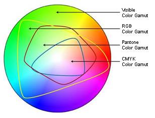

First off you need to know that CMYK is a limited color space.
See that small area in the middle of the graphic?
That's what you have available to reproduce your poster.
But it's also possible that particular printer isn't very good. I think you should expect better results than what you're showing.
I would take the file to other printers—consider a local offset printer who does quality work. They are more likely to have a device that accurately reproduces CMYK.
Find the printer that works best for both the color and the per unit cost.
They are out there ... but you might need to dig a bit.
Did they request cmyk? If they aren't using a four color press they would probably actually prefer the rgb. I've run into this in the past with photo printing companies.
Edit we'll I can't read. But if Office Depot is not where your final print is being made, my input still stands. Office Depot equipment would obviously be completely different from a real press. Expect some dulling though as many rgb colors are outside cmyk gamut.
Paper & print settings are also a big factors. You ought to be able to get a little more pop out of it tho. It's all about trial & error.
You could see if their website recommends any specific input (RGB) and output (CMYK) ICC profiles and use them as your source and destination color spaces when converting your image to CMYK to see if that gives you a better result.
