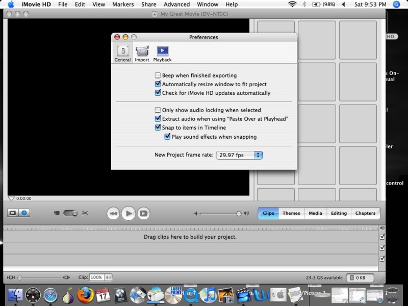

Well, I don't see a NTSC DV option to select in iMovie HD, there is only "DV" and that is what I selected. Is that okay?
Maybe, I'm not fluent in iMovie as I use more advanced editing software.
But NTSC is a Standard like PAL, and DV is more like a tape format, to which one can record NTSC or PAL. Not that it matters here anyway.

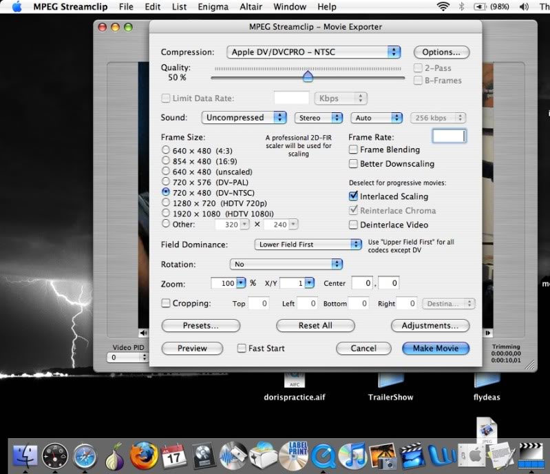

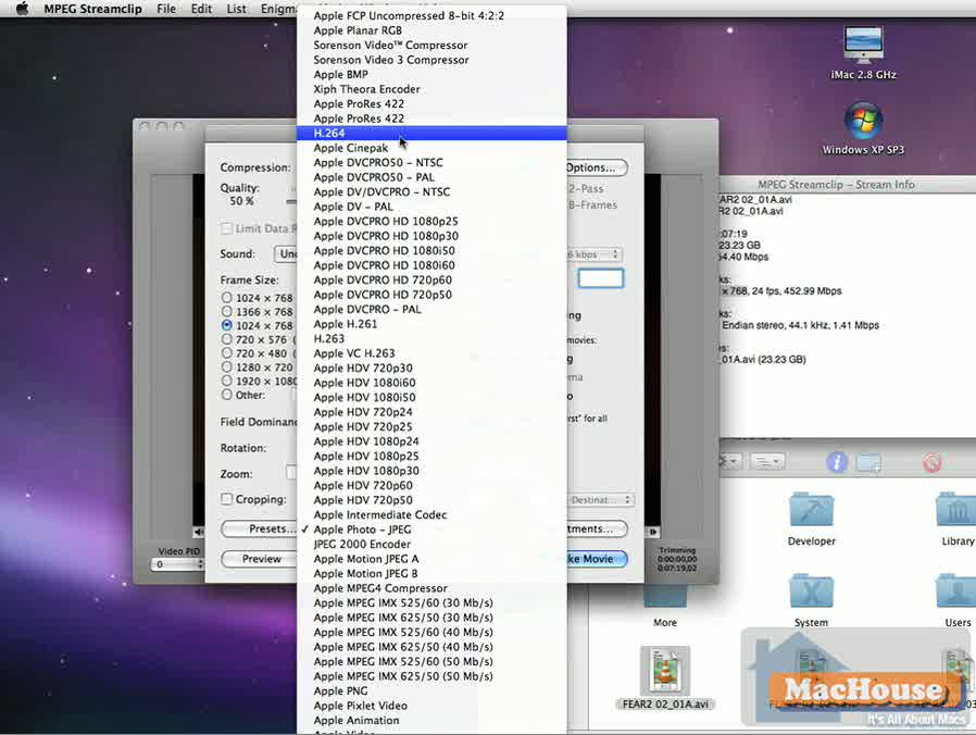

You can use the Apple DV codec here too in the drop down menu:
Or the Export to DV option:

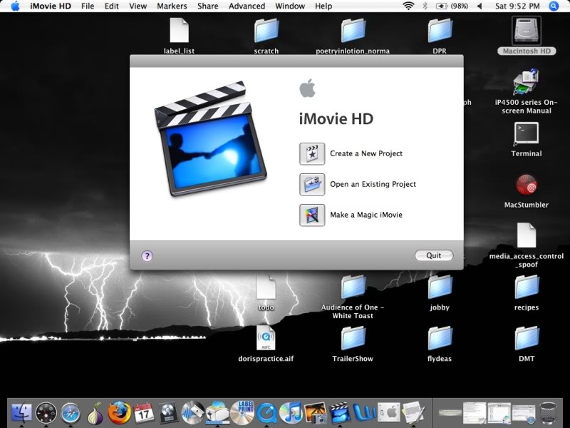

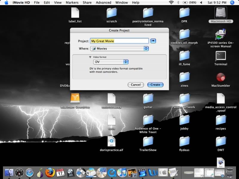

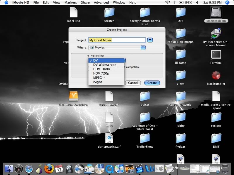

Okay well, when I start iMovie and then select "Create New Project" a screen comes up asking me to type in a title and then a dropdown menu called "Video Format" is there, but there is no NTSC or PAL.
The only options are:
DV
DV Widescreen
HDV 1080i
HDV 720p
MPEG-4
iSight

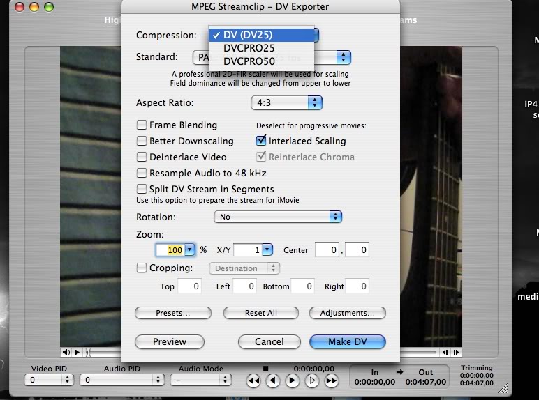

Okay I tried this. First I loaded the .avi in QT and exported it to DV (Export: Movie to DV Stream) then I went into Options and changed the kHz from 32,000 to 44.100. It still changes it from Mono to Stereo though. I'm not sure how to control that.
I played the DV in QT. Choppy. Then I imported the resulting DV into iMovie and same thing. The thing is... the video is slightly behind the audio, though the audio sounds fine. No choppiness with the audio and it all sounds like the same pitch and tempo I recorded it at. It's the video that is out of synch with the audio, I think, and not vice versa.
I was confused by your picture. I didn't know if you wanted me to use "Apple Motion JPEG A" or "H.264" so I tried both. Both resulted in choppy playback like all my previous DV movies.
I am also confused by your suggestion to use these codecs in MPEG Streamclip, because originally you told me to export my .avi to .mov, no?
But If I export an .avi file to DV stream (using QT or MPEGStreamclip), the resulting file doesn't have the extension "mov." It makes a file called "filename.DV," so it is not a .mov file, is it? Am I supposed to be exporting to DV or MOV?
DV
DV Widescreen
HDV 1080i
HDV 720p
MPEG-4
iSight
Thanks for the info. I saw some iMovie screenshots, were there was a DV NTSC or DV PAL setting.
It's not important for this, but NTSC has a 640x480 resolution with 29.97 frames, and PAL has a resolution of 768/720x576 with 25 frames.
Sorry for the confusion, it is a picture I found on the www. I wanted you to use the Apple - DV/DVCPro - NTSC codec.
I am also confused by your suggestion to use these codecs in MPEG Streamclip, because originally you told me to export my .avi to .mov., no? If I export it to DV stream, it doesn't have the extension "mov." It makes a file called "filename.DV," so it is not a .mov file, is it? Am I supposed to be exporting to DV or MOV?
.mov, .avi, .dv, .mp4., .mkv are all containers not codecs. You can use any of those containers with a lot of codecs.
.dv is a special container meant for videos encoded with the DV codec, but there are also .mov and .avi files containing video encoded with the DV codec. The DV codec is meant for capturing and storing footage from a DV tape.

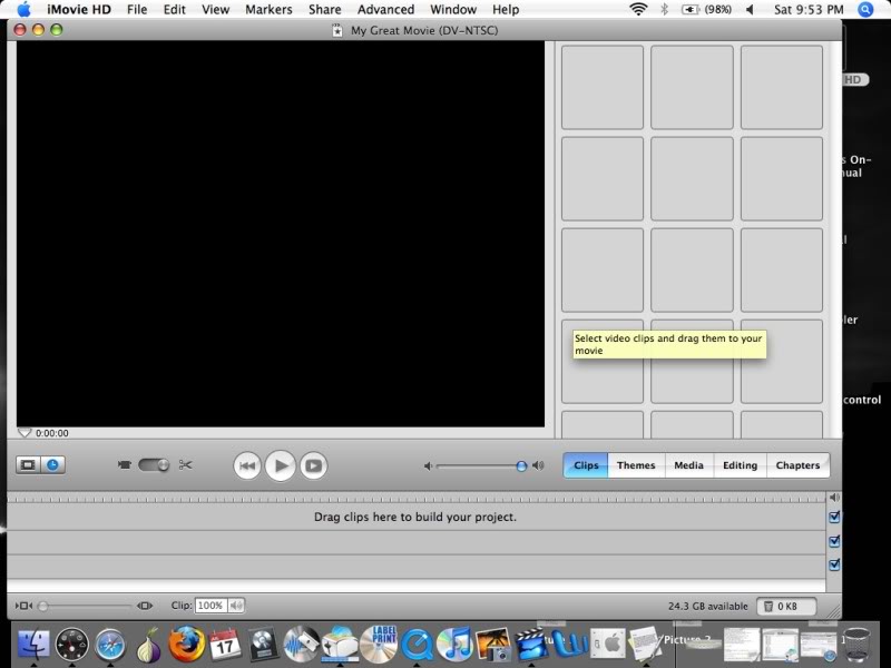

Yes, that's right. I opened iMovie, selected File > "Create New Project" and in the "Video Format" dropdown menu, I selected "MPEG-4." Then I imported the .MOV file into iMovie and for some reason it played perfectly. Everything was in sync.
Right. I just tried this a few seconds ago. Unfortunately, it is the same result. It produces a MOV file, and when I play it in either QT or iMovie, it is all choppy and the video is lagging behind.

Here is the link to my resulting .MOV file when using the "Export to Quicktime" option in MPEG Streamclip with the "Apple DV/DVCPRO NTSC" compression format:
https://rcpt.yousendit.com/696857972/c566be2b84152f9c4ba91d7cca0a6097
Here are the settings I used:

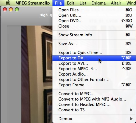

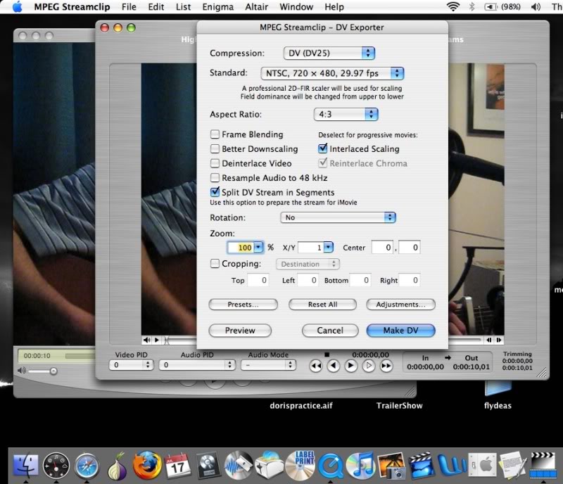

Here is the link to my resulting .DV file when using the "Export to DV" option in MPEG Streamclip (I had to ZIP this one as yousendit didn't seem to like the DV extension for some reason):
http://rcpt.yousendit.com/696863128/e24edca96aa3f78df22b01a7603521ae
And in case you wanted it, here is the link to my resulting .MOV file when using the "Export to Quicktime" option in MPEG Streamclip with the "Apple Motion JPEG A" compression format (the only one that has played back okay for me so far):
http://rcpt.yousendit.com/696860294/43ece4dce9bc7bdac9b634e35cee276c
And here are the settings I used:

As far as I can tell now from the screen shots, the one where you used the Apple Motion JPEG A codec, the video wasn't scaled.
Also you you could try, if setting the quality slider under the codec drop down menu to maximum will help any kind of export.

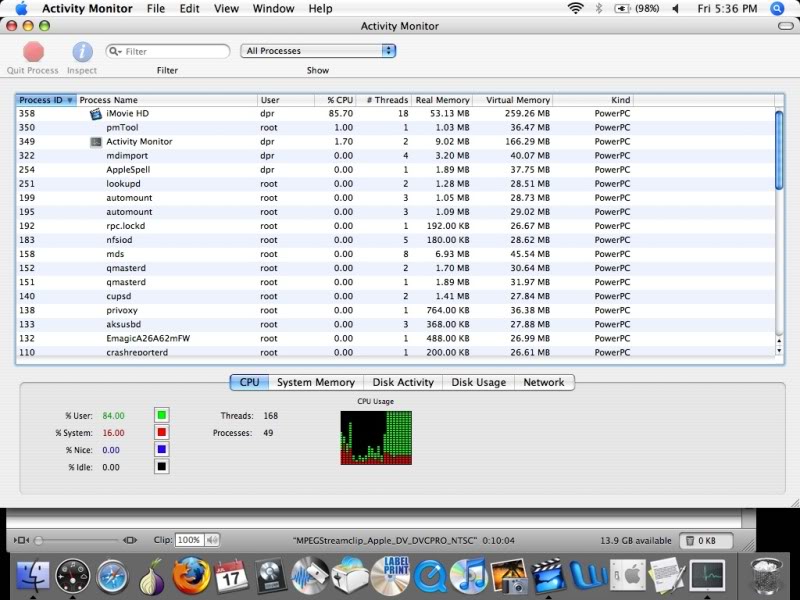

What springs to my mind now, before I further investigate is using a software called XBench to test the speed of the drive, where the file is playing from and post the results here. Also have a look at Activity Monitor, when you play the DV/DVCpro encoded files and/or in iMovie.
Maybe the CPU is really busy.
PPS: Don't forget to show All Processes in Activity Monitor.

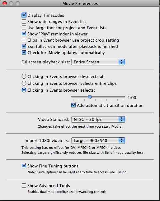

Ha, I couldn't go to bed.
So here is what I did.

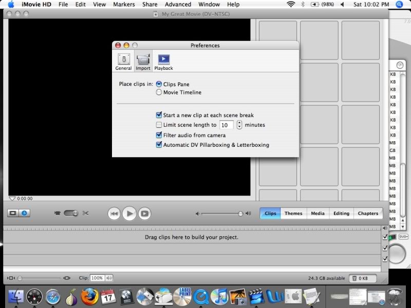

I opened iMovie '08, created a new project (4:3), set it to NTSC in iMovie's preferences, went to File > Import Movies > choose your original .avi file, it took my computer (an MBP with 2.53GHz) around 13 seconds to import it, and it plays just fine without choppiness or out of synch audio.
I think the root of your problems could be your PowerBook and depending on how fast/slow it is, its capacity to handle that video.

I tried this with the DV/DVCPRO compression, and the .MOV played back even more choppy than before on QT and about the same amount of choppiness in iMovie.
PS: I took a quick look with the QT Player at the videos, and none played choppy.
All videos had a frame rate of 15 frames, except the one encoded with the Apple DV/DVCPro codec. Also the bitrate was 50Mbit/s, which means 6.25 MByte/s. A PowerBook should play such files with ease
Yeah it looks like it! That's really weird. So my powerbook is just too crappy to play back these movies? That sucks. I thought it would have no problem since I use Logic Pro to record and edit music all the time ??
But it looks like you're right. It's in the eighties for User when I'm playing the .MOV file in both QT and iMovie. I'm guessing that's not normal, right?

PS: Here are the setting I used for the iMovie '08 project.
New Project window
iMovie Preferences (CMD+,) > Video Standard
See I don't have any of those preferences. I guess we have different versions. Mine says it is: iMovie HD 6.0 (233) in the "About iMovie" section.
When I first launch iMovie, this is the screen I get:
And then after selecting "Create a New Project," I get this:
And then after selecting one of the 6 formats, it fully opens to this:
This is the Preferences section:
Maybe I need to upgrade to '08 version?

Also I used the DV preset when the project was created, and in the Preferences you can change the frame rate, which I set to 29.97 frames.
Maybe, as this is surely not meant for being played back via a TV station, you could try it with 25 frames/s.

Cool. Well I googled how to do the "Repair Permissions," and I think I did it right. I just went to Applications > Utilities > Disk Utility and then hit the "Repair Disk Permissions" button. Didn't take long. Now I did this with "Macintosh HD" highlighted, but there is another one above it called "74.5 GB TOSHIBA." Should I repair it for that one too?
Anyway, it didn't seem to do anything. I tried to play the DV that I exported with MPEGStreamclip in QT and iMovie, and both were the same result. My lips are still out of sync with the singing and hand is still off with the strumming.

Also editing with either the .dv file or the .mov file should be fine, but why don't you just use the .avi and import it into iMovie, one compression step less in the whole process?
And if you use MPEG Streamclip the DV25 preset will work fine, DVCPro is made for Panasonic DVCPro cassettes for recording the DVCPro standard and DVCPro 50 just takes up twice as much space.
Oh right... since they are all containers it doesn't really matter right? I'll just use AVI then to minimize any loss of quality. But do I still select "DV" as the Video Format at the beginning when I create a new project?
