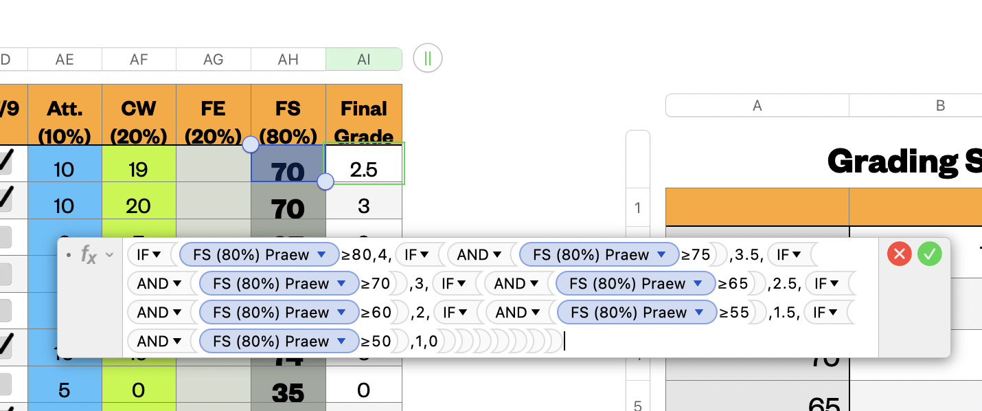

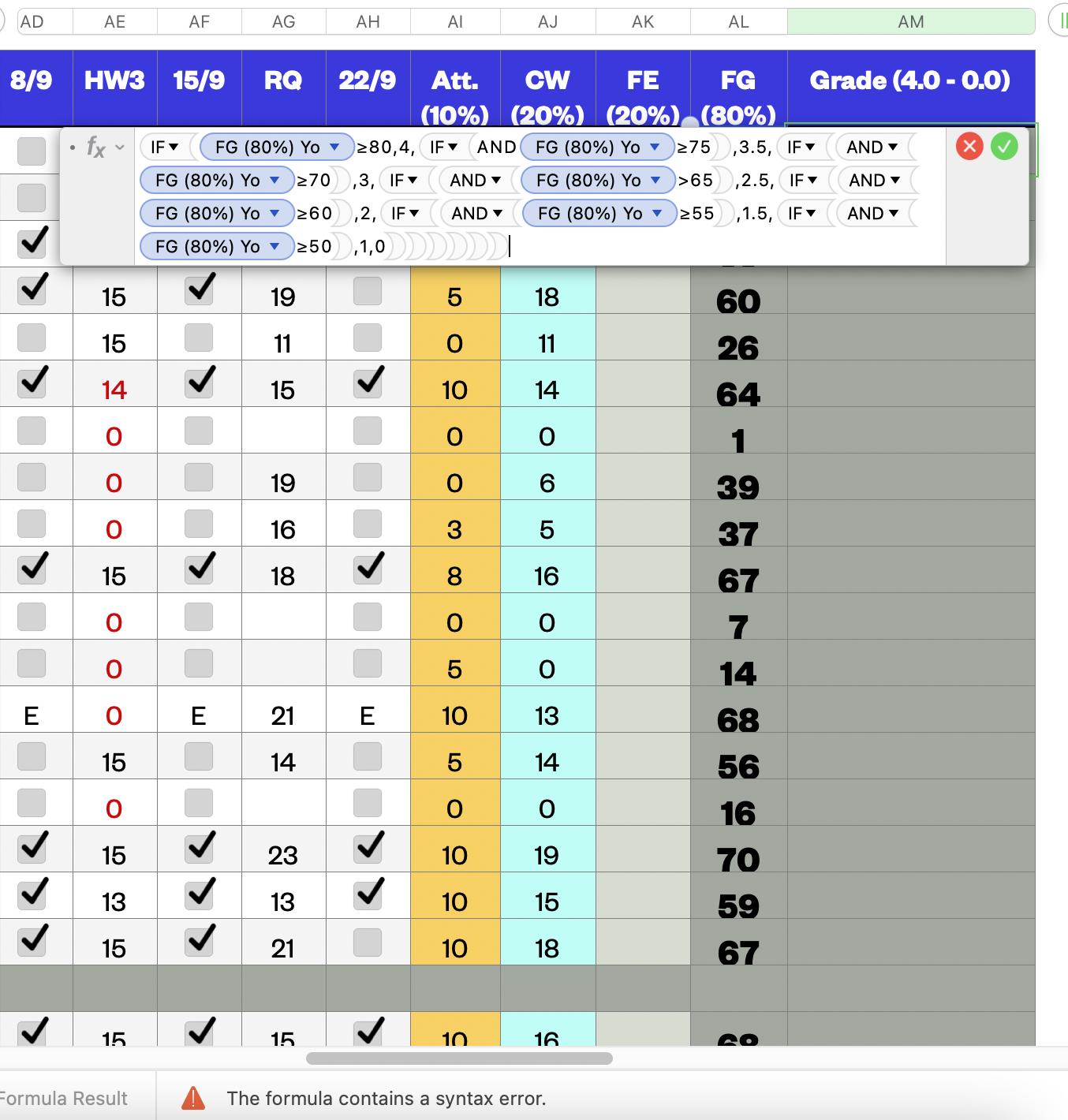

I just tried it but it came up with a syntax error. Here's the screenshot.
Edited: Sorry my bad. The first 'and' was not inside that 'thing' lol. Your formula worked! Thank you so much.

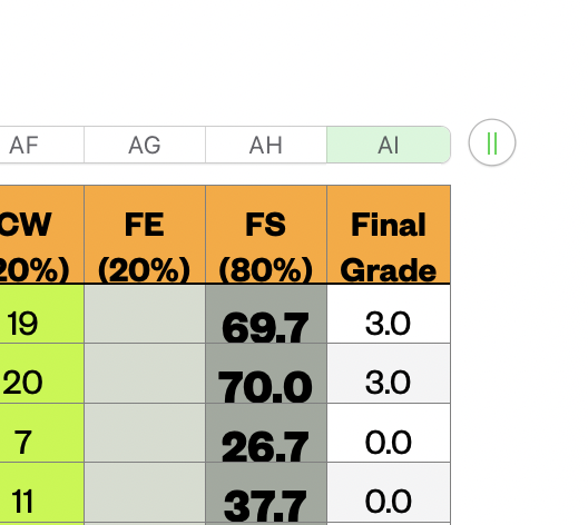

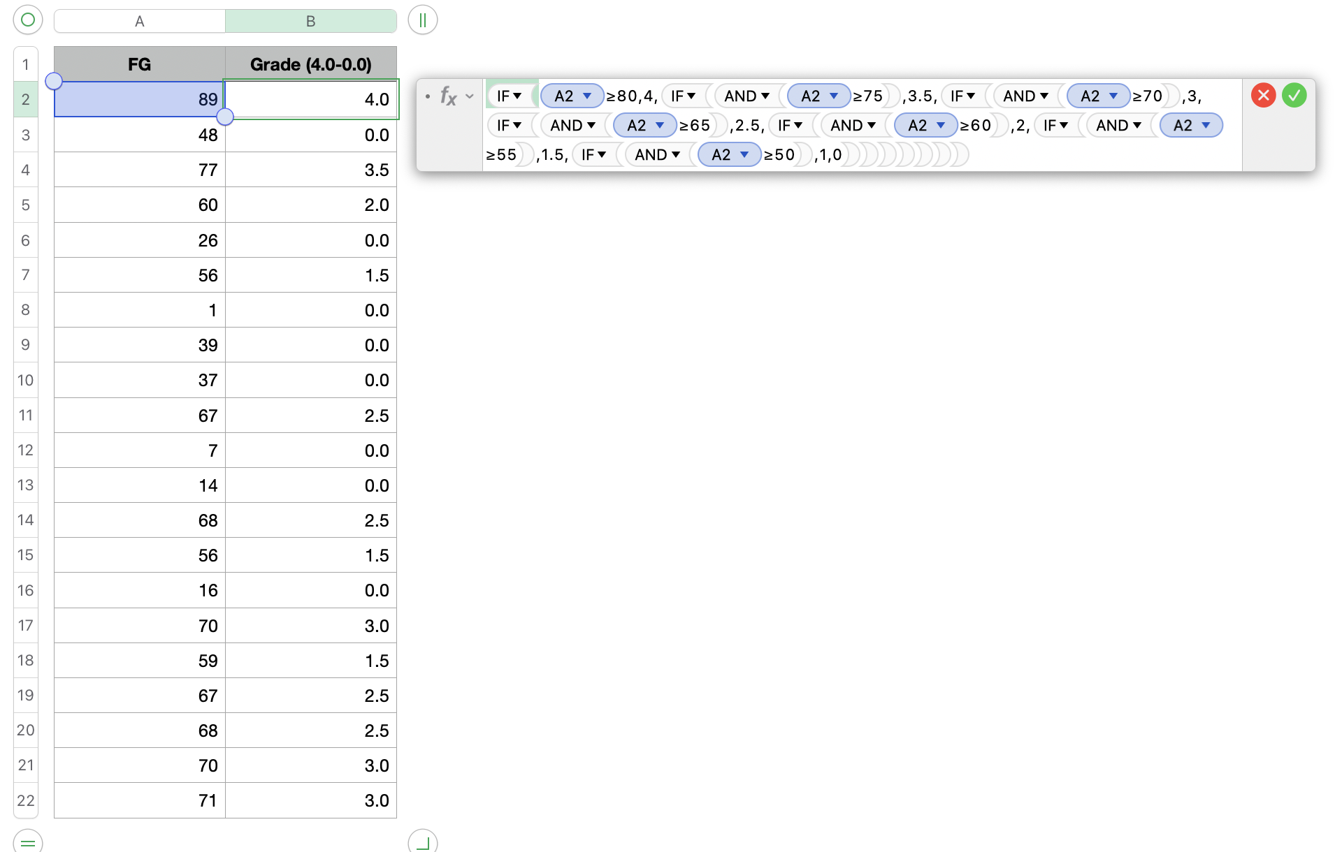

Another issue came up. Both 70 but different grade? Here's the screenshot.

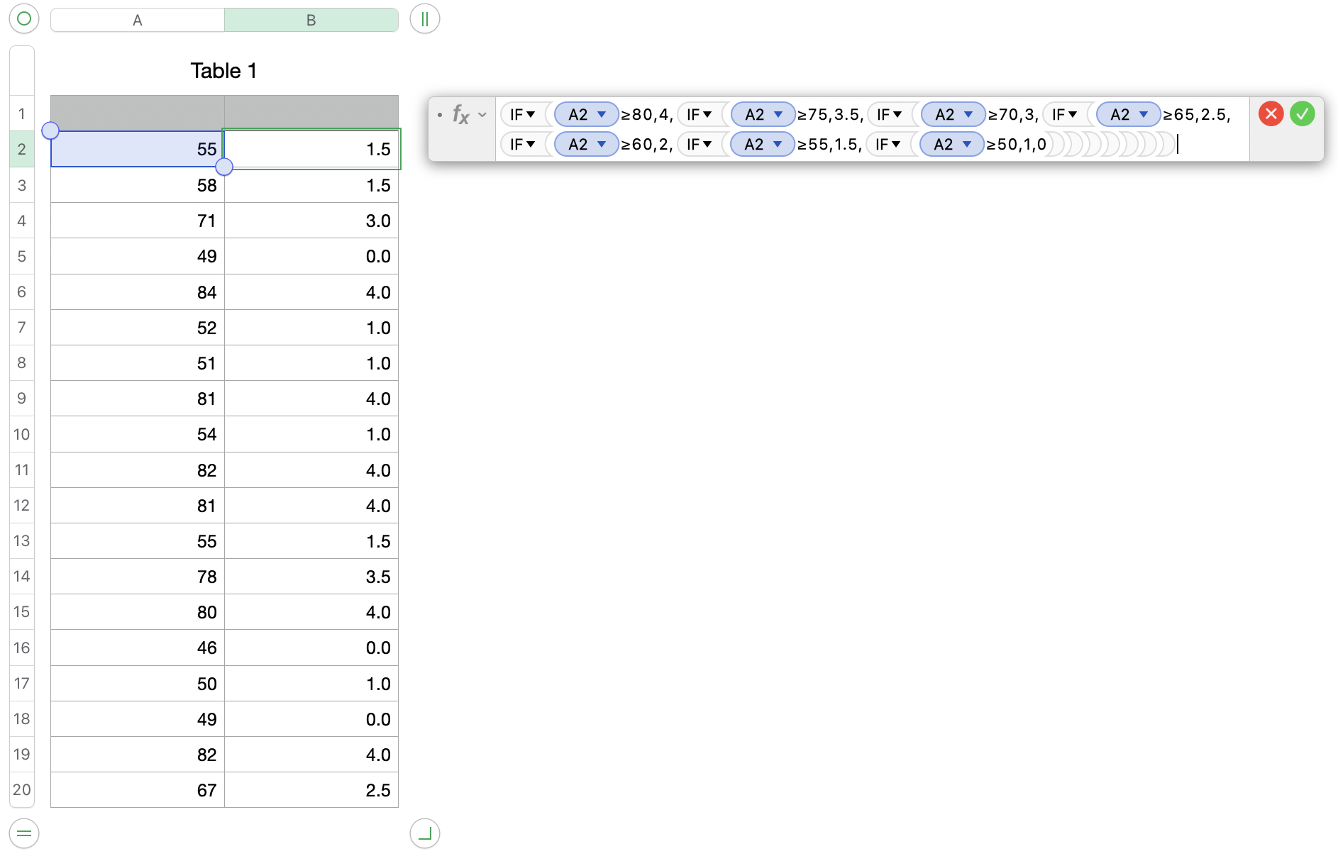

My guess is that you have a typo in the formula, but I don't see it. Also, taking another at this, I don't know why used the AND formula. It's not necessary. Try this simpler formula (I'm putting it in the text here so you can copy and paste):
IF(A2≥80,4,IF(A2≥75,3.5,IF(A2≥70,3,IF(A2≥65,2.5,IF(A2≥60,2,IF(A2≥55,1.5,IF(A2≥50,1,0)))))))
Another reason you might see the same number return different results is that you don't really have two 70s. The format isn't showing any decimals but you might have some hiding behind those figures. Use the ROUND formula on your final grade column.

I know now what causing it. I rounded their final score to zero decimal. When I rounded it to one decimal, it showed their real score. Here's the screenshot.
