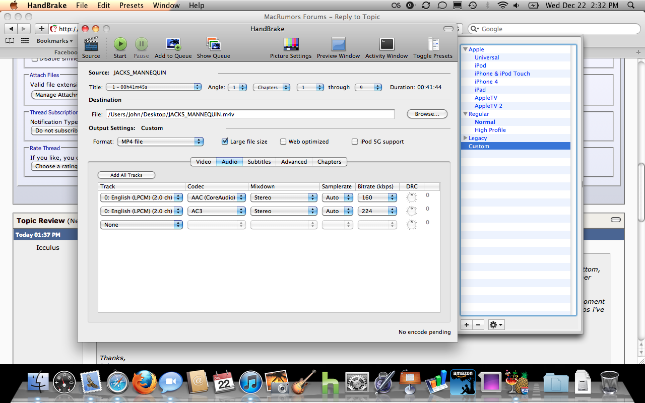

I use the same settings, and I have already done over 600 discs using this preset and I think it kicks ass! So as for the video format, and why its different...I got nothing on that. Are these blu-ray or standard discs? As for the audio once you get everything else set for this preset, click on audio tab and you should see at least 1 audio track, maybe 2. The way I have it setup is the first audio track is AAC (CoreAudio), mixdown is Stereo, Sample is Auto and bitrate is 160. The second track, which you might have to create, needs to be codec of AC3 PASSTHRU and mixdown as AC3 PASSTHRU. Then save the preset and be sure to use picture size custom and make sure picture filters are checked. You can always test your preset to make sure its right by loading a source file once, selecting your preset and then loading it again because it will reload the preset. The reason I say this is because I thought my preset was golden until about ~60 dvd's in and realized it was not saving the picture settings correctly. So always test. Any other questions please ask as I have been in handbrake hell/heaven depending on the day for the past several weeks as I was in your boat of re-encoding all my discs using this new preset.

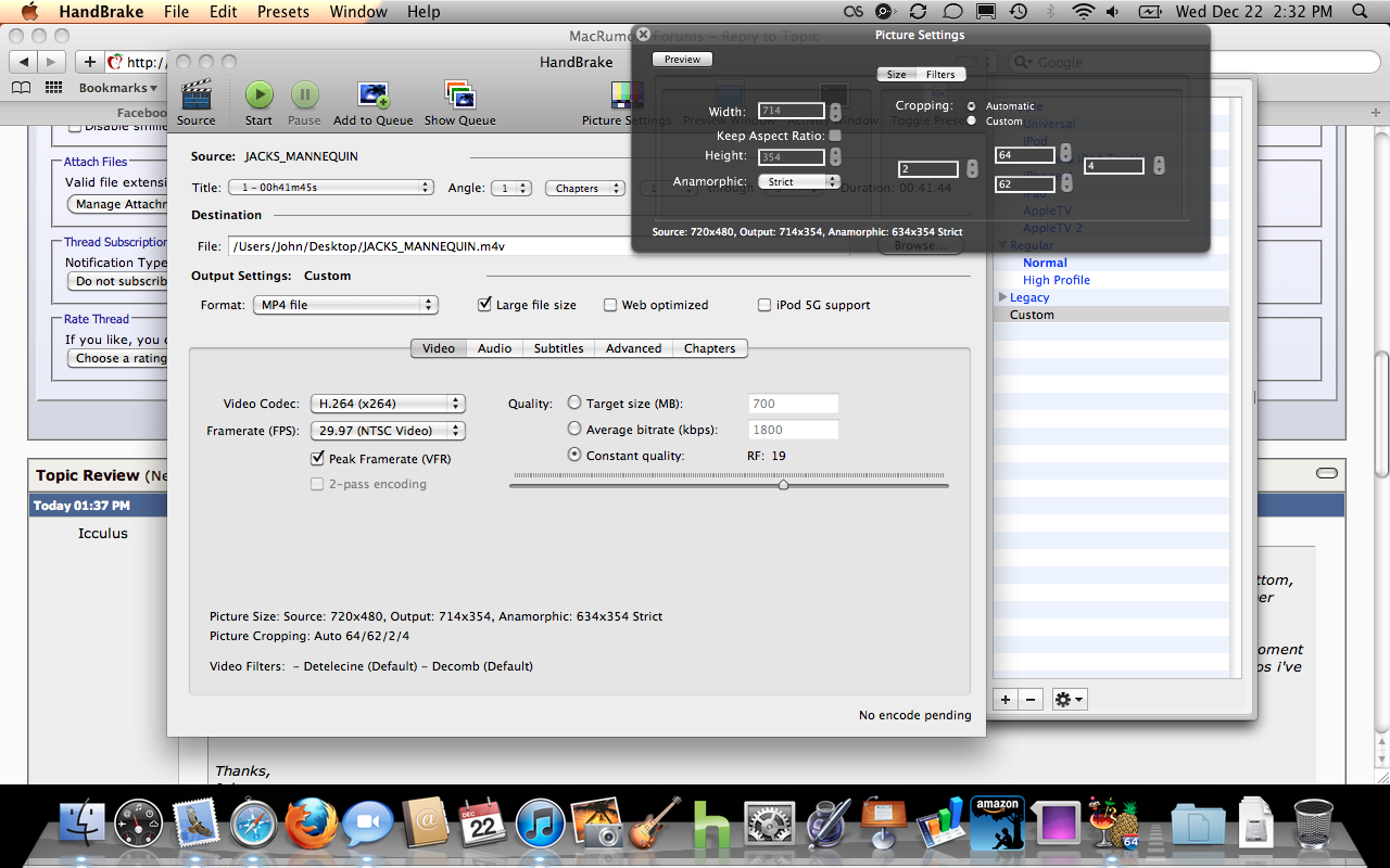

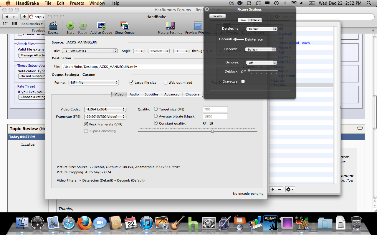

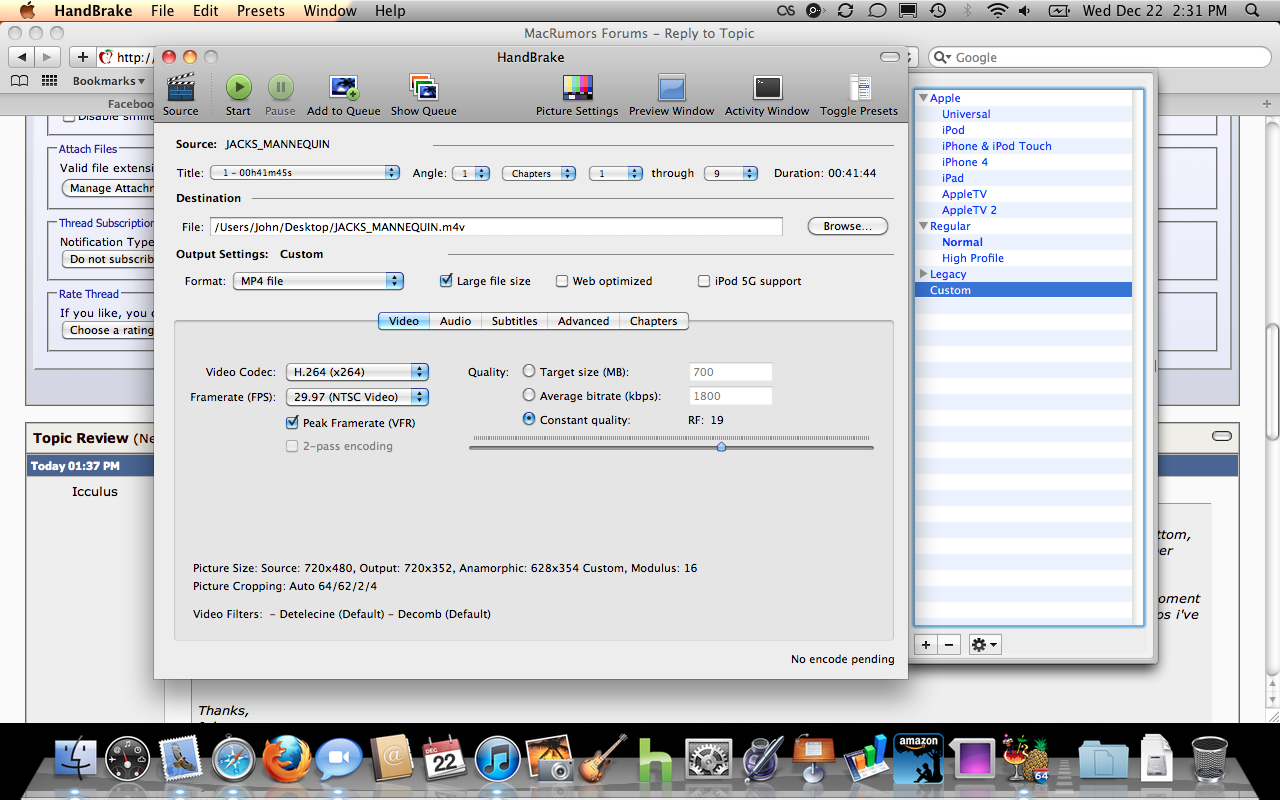

Thank you for your help. I have attached screen shots of how I have my settings with a DVD in. I am only doing standard DVDs. I don't see that option in the audio drop down. Perhaps there are different options depending on the DVD? When the audio bitrate is at 160, is that the same as an audio file? I usually encode audio in 256. Hopefully the screenshots will help explain what I should change. (I am using last nights build.
Thank You

Well looking at the Audio settings, it looks like the DVD you are encoding does not offer an AC3 Passthru option, because the codec is set to AC3. I would try a few other discs and see if you can see the option for AC3 Passthru. When do you do make sure you set it correctly and save your preset again. This way all the discs that have Passthru w/AC3 will get it, others it will go to where your setting is currently.
I do all my audio at 256kbps, but I am not sure how that translates into video. I just kind of figured since no other presets I have seen go above 160, I just leave it the way it is.

OK, I'll try to explain ... but keep in mind, I'm not an expert.
The resolution of standard TVs is 720x480 (NTSC). So DVDs are encoded in NTSC, so that's why your DVD is showing up as 720x480. Keep in mind, the pixels are not square with NTSC, they're actually rectangular.
Now, depending on the movie/show on the DVD, the actual display resolution will depend on the aspect ratio. If the movie is 4:3, the player will decode the information and pinch the output to 640x480. If the movie is 16:9, the player will stretch it to 854x480.

I do think you're making this hard on yourself. If you just choose the AppleTV2 preset, you will get results that are essentially the same as your custom settings, particularly as you are only doing standard DVDs. It will automatically create the necessary sound tracks both for surround sound and plain stereo. If I am correct about the dates, the person whose advice you have been following wrote his recommendations before Handbrake added the AppleTV2 preset. The only suggestion I would add is that if you are converting DVDs of TV programmes, you sometimes have to look out for interlacing in the original source. Those that are made from HD broadcasts are usually fine, but older TV show disks often have this issue.
