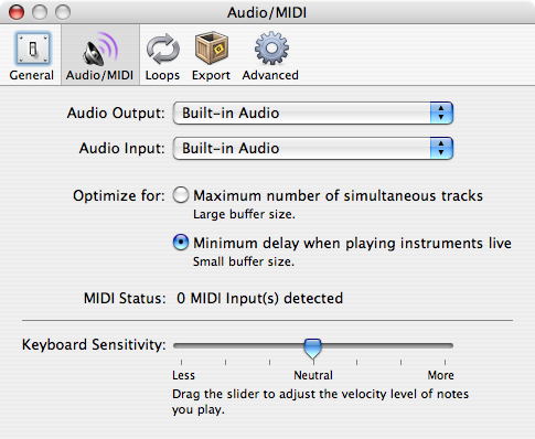

Each app has it's own input settings. Check all the preferences.
For example, in GB:
