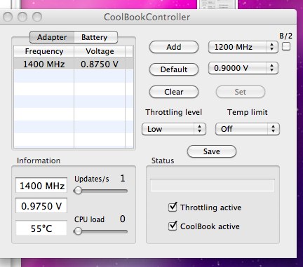

When my computer is under heavy load, the voltage shoots up to .9750(the highest one) even though I have mine set as a max of .8750. I have clicked save and have restarted my mac. here are my settings (same for battery). 2010 mba

Is it just the saving of settings that doesn't appear to work, or does it also fail to "set" the lower voltage when you ask it to?

I click save and it asks to perform a test, which i agree too, and then it goes through the testing phase and completes. Yet sometimes my voltage goes above the selected voltage. So coolbook doesnt maintain the settings or something.
In your signature line it's says you have a 2011 MBA, true? If so, Coolbook will not run on the '11 model, because Sandy Bridge does not support undervolting.
