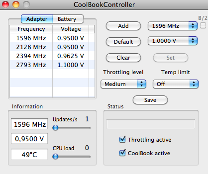

Hi! I decided to start this thread do exchange some info about best config compared to default throttling .
MBP mid 2009 - 2,53GHz
Adapter
1596MHz -> 0,9250V
2128MHz -> 0,950V
2527MHz -> 1,050V
Battery
798MHz -> 0,9250V
1064MHz -> 0,9250V
1596MHz -> 0,9250V
Throttling Level = High
Thanks! 😀

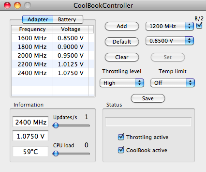

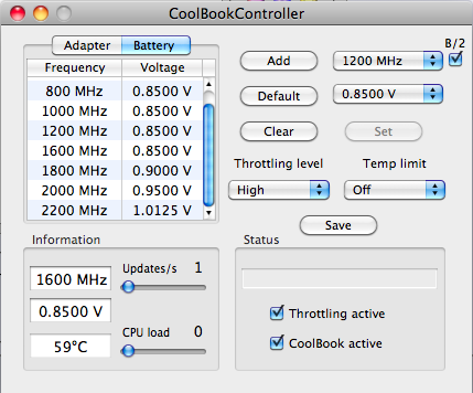

Good idea. Here are mine (MBP3,1 15")
WoW!
I dont have the 0,85 setting 🙁 . Would love to
And I'd love to have the battery life of your 2009 MBP. Coolbook has been great for this old machine though (which, regardless, has served me well these past years).
Still playing around with my settings (mostly by reducing the steps and capping the battery at 1600mhz). Will update your thread when I've settled on something.

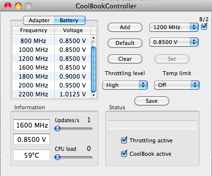

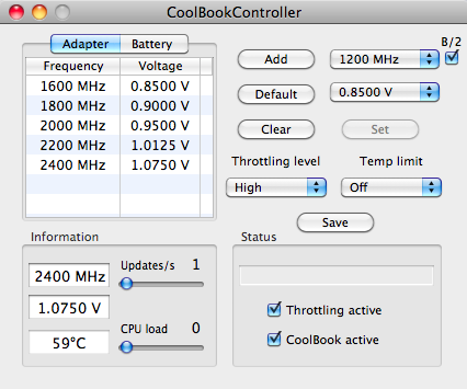

Late 2008 Macbook Pro 2.8 Ghz
