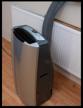

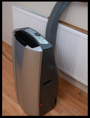

Sounds to me like you have to shut-down the flow of air from the main house, then perhaps go with something like this, If you have the room in there.
I've got one of those portable aircon units for my little office.
Very handy on really hot days - do work well. Couple of issues with them you might want to consider before you rush out and get one. The hose length is limited - needs to be sat under a window. Also - the hose just sort of hangs out of the open window. You really need the window open a bit to lock the hose exhaust in place. Mine did get a little sort of baffle that's meant to fit and block the window opening but it just fell out all the time.
Oh - one other thing - this is a bathroom? I don't know your situation, but here, we're not allowed wall sockets etc in bathrooms because of electrical safety. Don't know if that applies..?
That's easily solved, with a small piece of painted plywood, with a dryer vent in it for the hose to fit in.
Make it look pretty. 🙂
