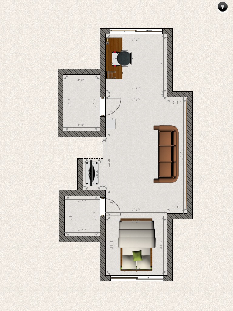

I live in a shared house and the landlord has decided to redo the attic. New windows, electrical, lighting, etc, and I get first dibs on the place! Woot!
There is one problem. My current air conditioner is only 5,000 btu and will likely do squat up there. So a bigger AC is in order, but I really doubt I can fit anything useful in those narrow windows. So I suppose I stuck so with a portable air conditioner. They are expensive though, and I have never owned one before. Looking online, people either love or hate these things, so I don't know if I can afford to find out I loathe it.
Have any of you used one before? What are your opinions?
This should give you an idea of what will be cooled. It's long and pretty narrow

I could just barely fit an appropriately-sized unit in there with the original window. The new ones will take a few inches away because of the edge. These old ones are literally glass in a wooden box.

Idea. Two box fans, one on each side blowing outward, and an open window at the landing. Cooling with negative pressure. It's cheap, but might only be moving hot air around. It's Ohio, but still, hot attic is hot.
If the landing means the stairs, you will probably only moving hot air out of the main levels.
I would block-off the stairs, and have one box fan blowing in, and the other out. Bed area for the in, as that end will be cooler.
