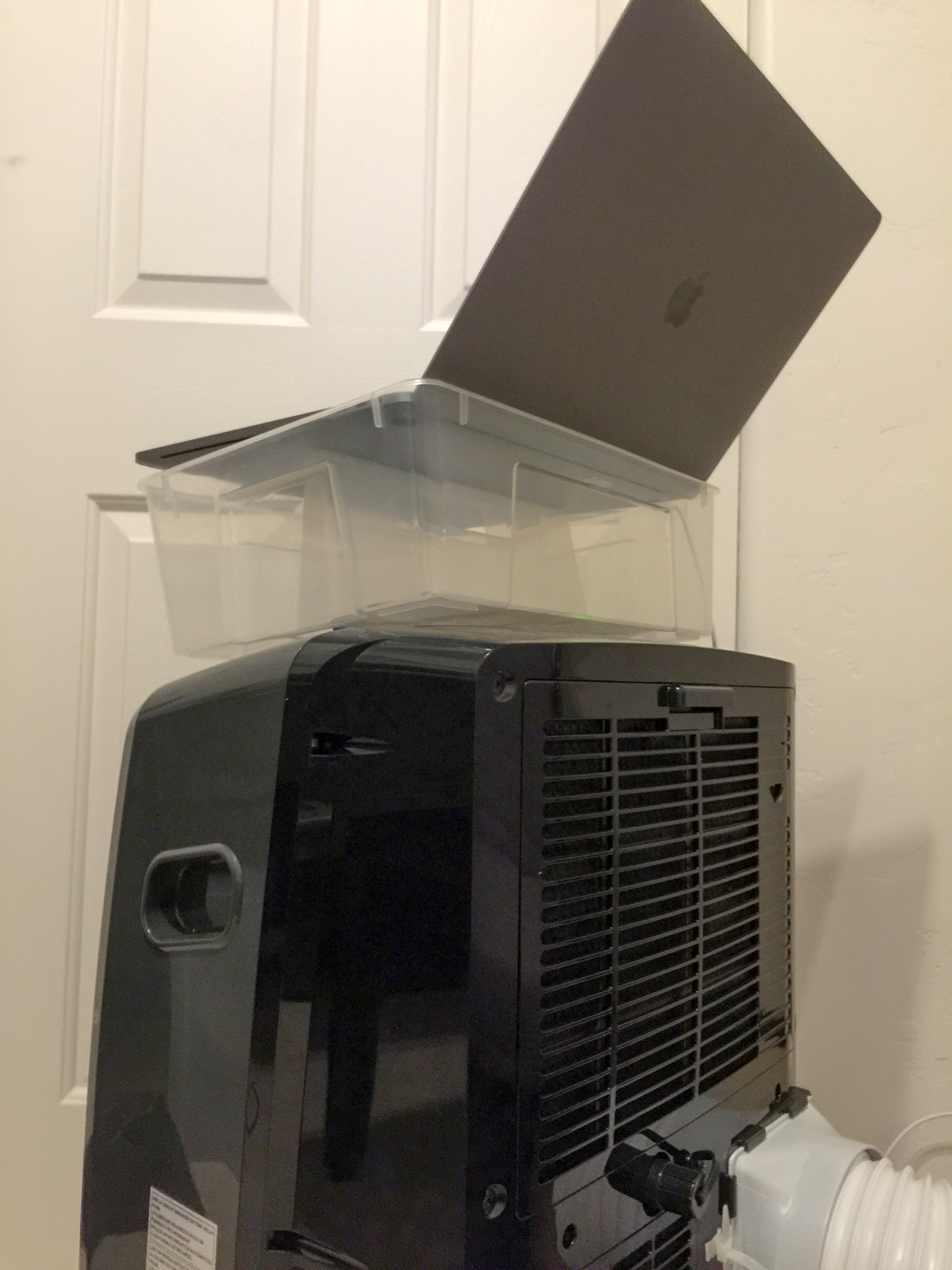

Anyway, I decided to cool the MPB by placing it on top of an LG room air conditioner (set to max cool 60F) blowing on the underside and side vents of the case to see if it made any difference. Surprisingly, the MPB doesn't speed up much. And it never seems to make the 30W mark on Intel Power Gadget.

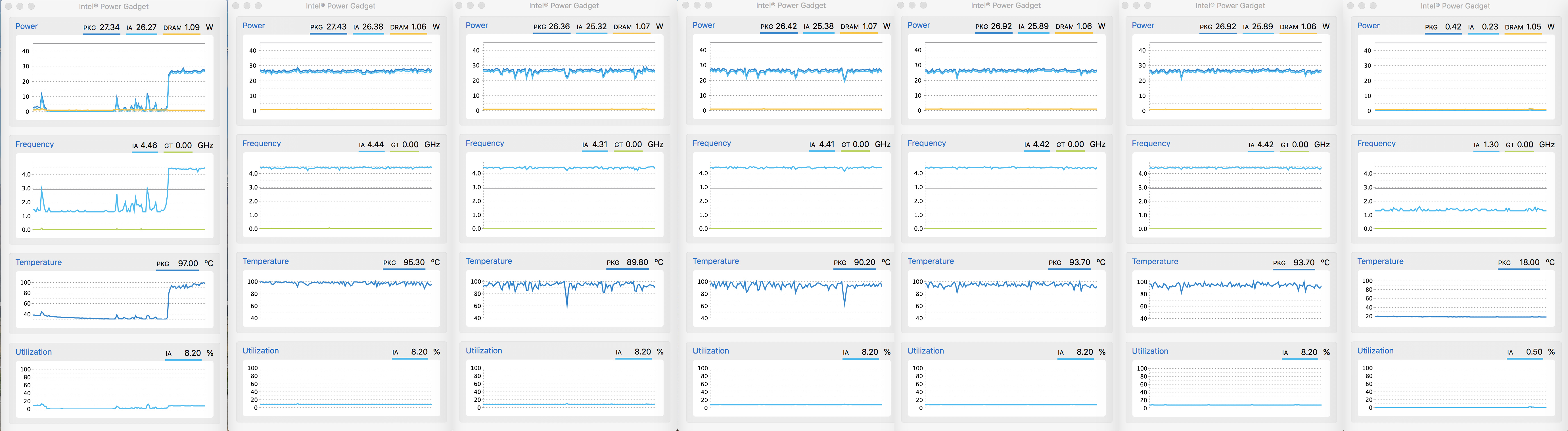

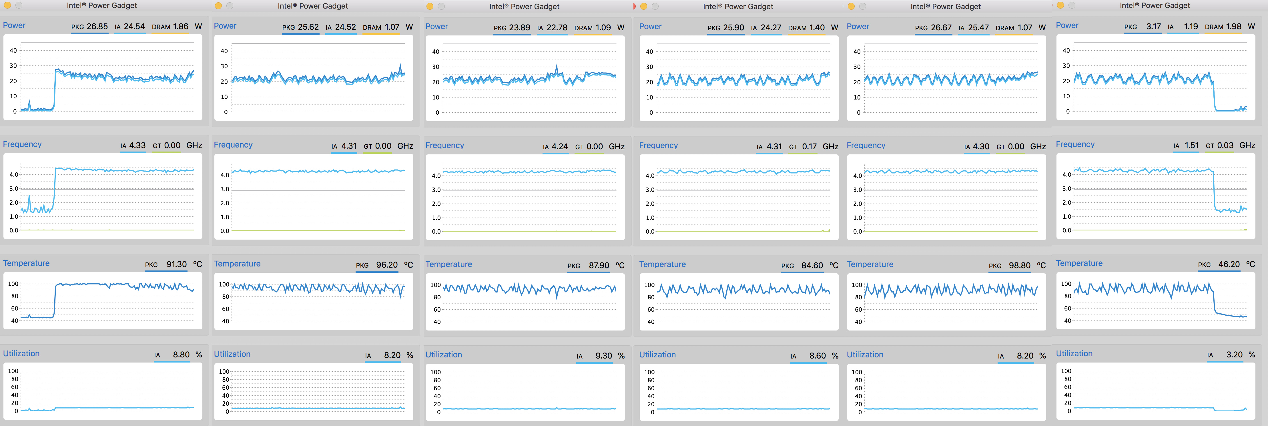

Looking at Intel Power Gadget (latest version), the comparison between the two MBP i9 runs, is quite different in terms of idle temperature (e.g. after the run is done), e.g. 40C vs 18C. But during the run they're very similar, and so the difference in speed is small.
Here are sample snapshots. On top of desk with small air gap between surface and bottom of laptop:
On top of airconditioner:
[doublepost=1536720873][/doublepost]The test cooling setup. I normally use this air conditioner as a supplementary airconditioner to chill a room for treadmill running. It's vented to another room obviously.
