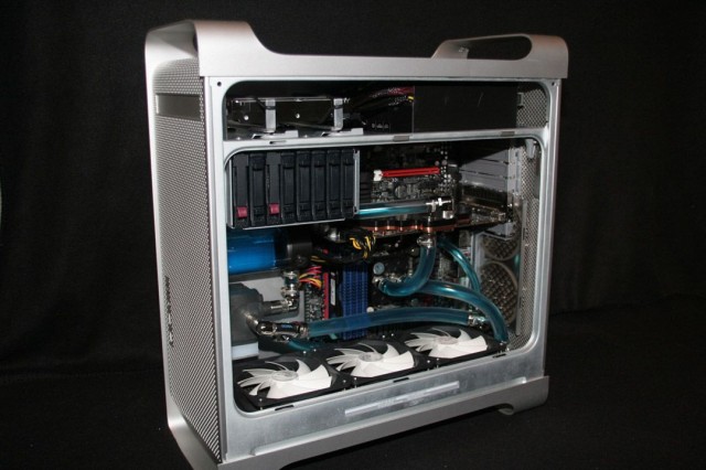

there's videos of water cooled macpros on YouTube, looks like a pain but can be done.
you can also mount gpu's with water loops in to a macpro and stick the gpu fan next to the pcie slot fan.

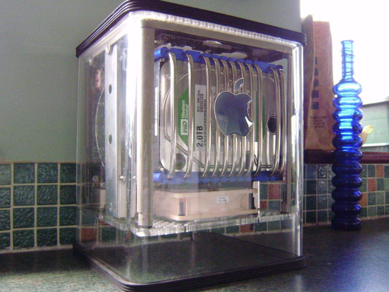

on tonymacx86.com you can find some rely cool hack's, my fave are in macpro cases, you can get a G5 cheep then stick a hack inside ^^ or even something older like a G4 case.
this one looks nice :D
and this one :D
i did love the G4 cube https://www.tonymacx86.com/threads/water-cooled-cube.98231/
and anther cube https://www.tonymacx86.com/threads/...ded-edition-my-2nd-hackintosh-case-mod.78479/ i do love them

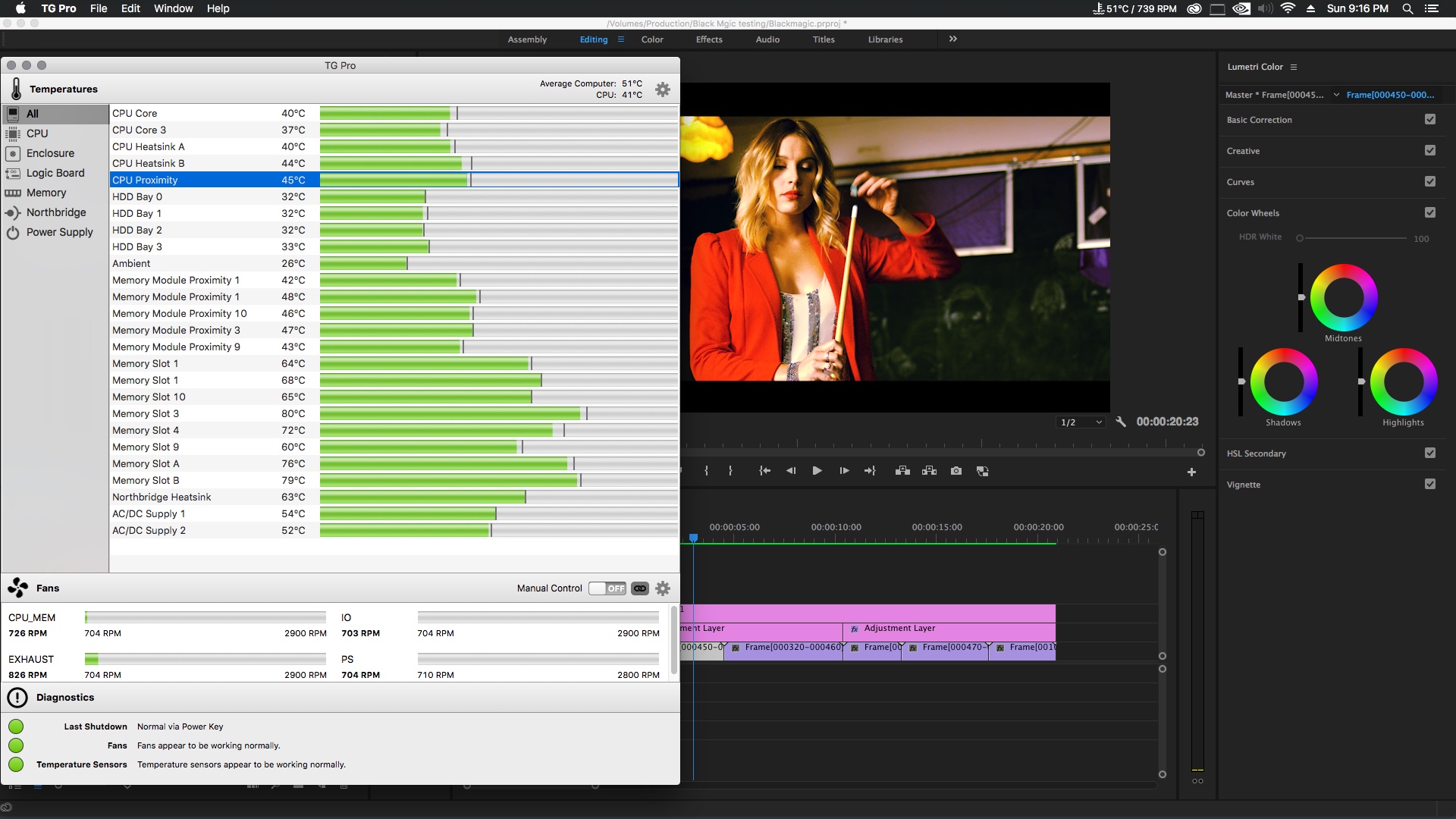

I do Music recording and Video edit. I need my mac pro low noise as possible. That what. And My cpu heatsink temp seem a to high when I edit video.

I do video editing on my 4,1 as well, the fan is not that noisy, CPU core temperature stay at around 73-76C, heatsink usually around 60C. If your heatsink temperature is high, which is a good sign that the CPU's heat can actually transfer to the heatsink. And as long as the heatsink is clean, the fan shouldn't need to work too hard to cool down the CPU (unless you have dual 130W CPU, that may require the fan to work harder than normal). My single W3690 system rarely need to spin up the fan to >1500RPM. And even though I won't call my cMP silent, but sure is a very quiet machine (even under stress).
The native fan profile may be a bit noiser, but you can always setup your own fan profile to reduce the noise and avoid overheat. I personally setup a profile that evenly spin up all fans, rather than heavily rely on the boosters. Let the intake / exhaust fan spin a bit faster and avoid the booster run at high RPM works very well on my 4,1. When my cMP under stress. The intake / exhaust spin up to about 1100RPM, and booster around 1300. Which is audiable, but not bad at all.

if you can say what the temps are or post a screenshot it may help
44-45°C isn't high.
Try Macs Fan Control for keeping fan speeds down. You want to keep CPU under 60-65°C and RAM under 85°C.
You'll probably find that the stock fan settings ramp up a bit more quickly than necessary. Exhaust fan usually has less effect on noise than intake areas, since it's further under the desk.

his fans are on almost the slowest setting, if the sound is relay to loud then some sound proofing may help temps look fine
