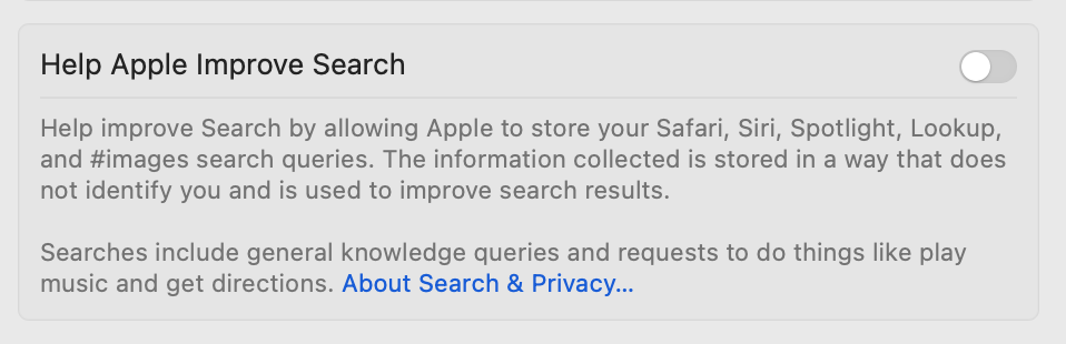

thank you for your time, I still confused but yes maybe something related.
I disable this on spotlight (attachment) but I don't know...

That setting is unrelated, I was referring to disabling actual spotlight indexing (e.g. excluding a directory). But generally i would not worry about date added being set to unix epoch (-ish) when restoring from backup. Basically assuming APFS behaves same as HFS, it's not an attribute that is tied to the file itself.
Date added would be meaningless when doing a bulk restore anyway, because all files would have the same date added (current date), because that is the date the CNID was allocated on the HFS volume.
