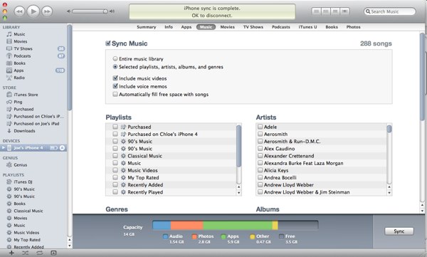

Not my picture, but here is what it looks like after you select to sync:
You could even to genres and just sync your soft jazz genre.
Of course you'd have to go in, and make sure all the songs you consider soft jazz would actuall be tagged that.

Yes, if you click "remove and sync" on the second screen shot, you'll get to the boxes where you can check artists, album, genre,...

No longer seeing the Warning from above screenshot links. I now have ability to sync individual Albums, Artists etc.
