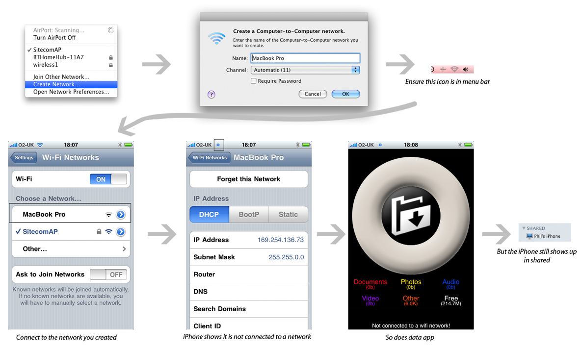

try this, still might not work though
philgilder, thanks for all the effort on this, pic and all 🙂
But still to no avail. Everything as you showed in the pic with the exception that I don't get the 'dot' where the wireless symbol would be on the iPhone, it just shows 3G. Also the address info in DHCP displays and disappears in a regular cycle, probably trying to connect then giving up. My iPhone apps don't see any Wi-Fi, and I never see the iPhone shared on the MBP. With the exception of the last three images, everything is golden up to that point. It's just not making the connection. Bummer ;(
