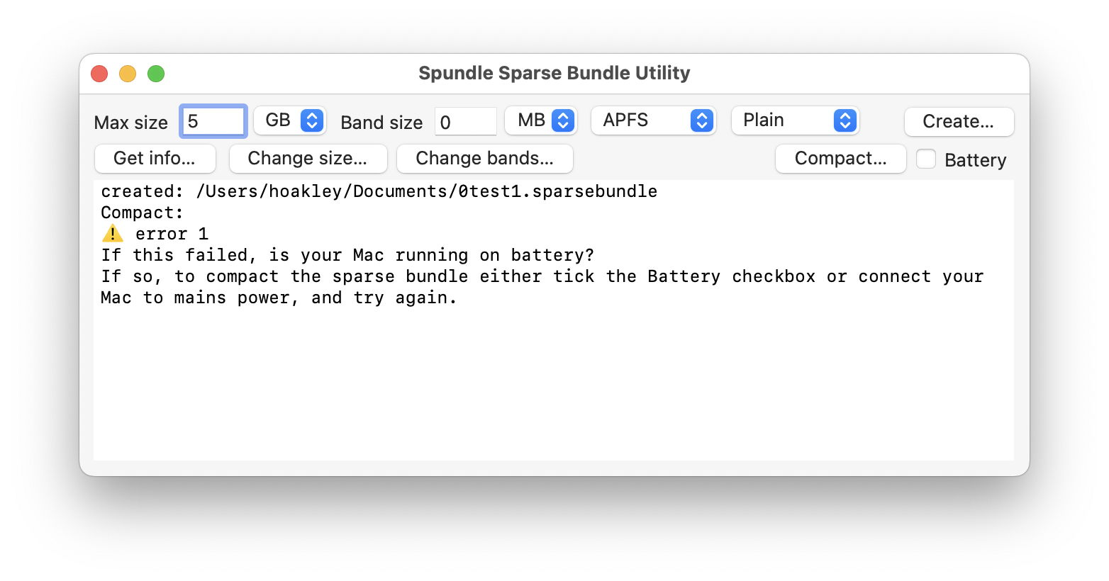

Slow spinning external HHD (not SSD) + older USB spec + sparse bundle ... I think it is what it is... fyi on sparse bundles
