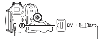

According to the Panasonic site for your camera it has a MiniDV (IEEE 1394) port that you can use to transfer via mini firewire, kind of a rectangle port probably labeled DV IN/OUT.

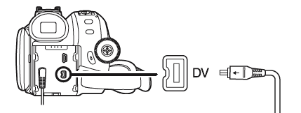

Looks like your connection is underneath the battery. (found this in the manual)

OK, so it seems like all you need to do is visit a store and grab a cheap iLink cable! Search ebay maybe and you'll find lots!🙂
Yes, you can buy the cable you need on the internet somewhere, or you can get it at the Apple Store online under "cables" for Mac accessories. You will need a 6 pin to 4 pin cable.
Thank You !!!!
Wow, so simple - I feel a little stupid actually, but I did not see that under the battery !! You all are awesome, I can't wait to download my camera now!
