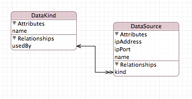

I have a Core Data model with 2 entities: DataSource and DataKind. It looks like this:

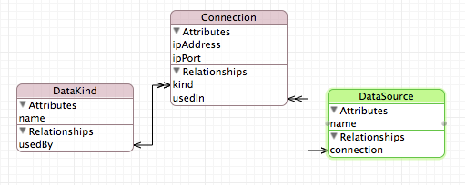

This is all happy, but now I need to have 2 associated IP Address/Ports per data source. I think creating a new version is the right way to go, so I've added a version to the core data model, extracted a couple of attributes and the relationship from DataSource into a new entity, Connection; version 2 of the model looks like this:
.This is all happy, but now I need to have 2 associated IP Address/Ports per data source. I think creating a new version is the right way to go, so I've added a version to the core data model, extracted a couple of attributes and the relationship from DataSource into a new entity, Connection; version 2 of the model looks like this:
