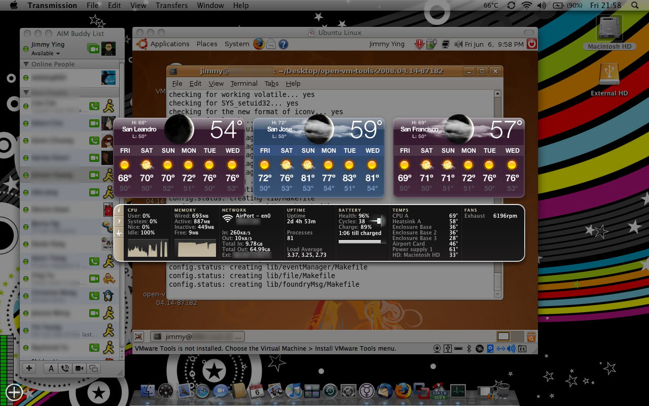

Okay, Im currently running the following programs:
iChat w/ 2 Conversations
iCal (Running in the background)
Preview (Running in the background)
iTunes, playing 1 movie, MP4 file.
Quicksilver
Mozilla Thunderbird and Firefox (9 tabs opened, none of the tabs have flash running)
VMWare Fusion running Ubuntu 8.04 @ 256MB
Transmission w/ 4 torrents
Activity Monitor
Temperature is:
61-71 deg C for CPU
55-60 deg C for Heatsink
36 deg C Enclosure Base 1
36 deg C Enclosure Base 2
28 deg C Enclosure Base 3
45-47 deg C for Airport Card
60-63 deg C for Power supply 1
33 deg C for HDD
Fan speed of 6200rpm stable.
My set up is MacBook Air with internal screen at 1280x800 and external screen connected via DVI at 1680x1050. Movie is playing on the external, VMWare is on the internal screen.
I'm getting intermittent(?) core shut downs. I don't know why, the temps are low and stable, fans are at max. I noticed this started happening after installing 10.5.3... but I can't be entirely sure. Currently, Im inclined to agree with bad X3100 drivers thats causing this. I am playing a video in the background so its possible thats whats causing the shut downs. I can run 2x yes > /dev/null/ without any core shutdown, but im running a simple video with nothing but an idle VM and it shuts down?
