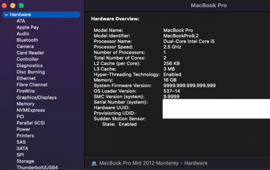

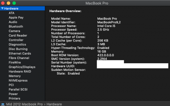

Just updated to 422.0.0.0. on my Mid 2012 Macbook Pro, currently running Monterey beta Open Core Legacy Patch (OCLP 0.24) will show spoof firmware and SMC version.
OCLP 0.24
