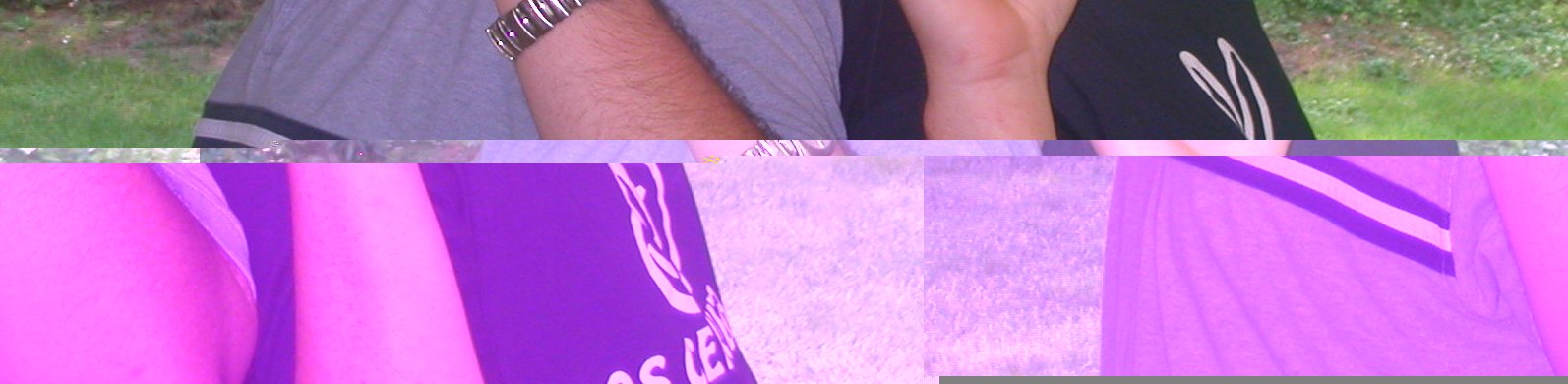

I've started to notice that pictures on my mac slowly corrupt for some reason. I am 100% positive that these pictures were fine when I put them on my computer, and in fact I have intact copies of them on my external. But every so often a couple of pictures get screwed up. I've put an example of what happens. In almost all of them, bottom 3rd of the photo gets discolored and shifted over. I've cropped the heads in this photo and only the problem area is shown.

That's pretty loony. Have you considered removing iPhoto and reinstalling? What about moving the photos to another Mac (or PC) and viewing them. Still having the problem?
is it the photo as it displays or the actual files being corrupted?
Are you only viewing through iPhoto? If so try opening up the file in a browser to see if it appears correctly. I have never heard of this issue before, modifying and saving .jpg's will reduce quality, but going bad with no manipulation is odd.
That particular photo was not in iPhoto, it happens to pictures both in iPhoto and out of it. It shows up like that in iPhoto, finder, preview, photoshop, etc. The files seem to be totally corrupted, when I transfer them to my iBook, they show up the same way. Could some jpegs be inherently corrupt? It's weird though since it happens over time

While it is certainly possible that the OS is corrupting files, and you may want to do a reinstall anyway if your first install was an upgrade from a pervious version of OS X instead of a clean install, it might be a hardware problem. I'm glad to hear that you've backed up the images on an external drive. I would however take the time and burn some DVDs for safe keeping as well.
Before reinstalling the OS, my two suggestions are to look at your RAM and HDs. I would first use disk utility to check the HDs for bad sectors and repair any errors if present. If a significant number of problems are found you should probably replace the drive. Second I would use memtest OSX to check your RAM for errors. I recently had a problem with corrupted files due to a bad ram stick. As time went on these errors multiplied and eventually brought down the system. You can test one stick at a time to isolate the bad stick.
Just some ideas to find the problem. Unfortunately you won't be able to repair the corrupted files. Good luck. 🙂
I just ran "verify disk" on disk utility (not permissions), and it gave me an error 🙁. The button for repair disk is grayed out though.This is the error:
Volume Header needs minor repair
The volume The volume sh HD needs to be repaired.
Error: The underlying task reported failure on exit
1 HFS volume checked
Volume needs repair
Doesn't sound so pretty. I guess I'll check my ram out and see what that does too.

You either need to a) Boot off the OS X Install Disk 1, and repair the HD then, or b) Boot into Single User mode (command-S) and run fsck (how-to on Apple support site).
Yep, it sounds like the drive at best needs to be repaired and at worst replaced. 🙁 The repair button is greyed out because you will need to run disk utility from the OS X install disc to do an actual repair. Start up your mac with the install disc in the drive and hold down the c button. Here is a website with information on what to do and what to look for.
http://www.thexlab.com/faqs/repairprocess.html
There is some other information here that is probably not be pertinent to your situation. You are right that the ram should also be checked just to be sure, however I think you've found the main reason for the picture corruption. If your drive has failed and you are still under warranty (1 year for Apple, longer from the drive manufacturer some are as long as 3-5 years check on their website) it can be replaced for no charge. 😎
Well I booted up from an external firewire drive, repaired the internal volume, and disk utility says all is now well with my hard drive.
Now I just cross my fingers hoping that I don't see any more corruption...
Thanks a lot to all of you.
