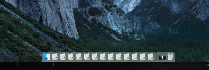

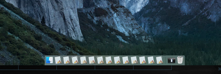

Oh - and we can't open the terminal enric0 - none of the applications appear in the broken account. Utilities do, but they icons are screwy and none of them will launch.

One thing to note: if you wait long enough (like a minute per file), the applications or files start appearing, but only ever with their base icon (i.e.: all applications are there with the App icon (you know, the paper with the pen, pencil and ruler make the letter A)) and they are non functional, i.e.: you can't run any apps as they will crap out saying that they are missing or incomplete.
Other fun fact - in my All My Files bit, I did indeed see Apple's idea of all my files... and I saw a Word doc. For fun, I double clicked it and, hey presto, it opened in Word! SO, in fact, everything is there and it all works (otherwise the machine would not boot, and I would not be able to log in to my account) but my account isn't seeing any of it properly. Finally, the other accounts on the machine work perfectly!

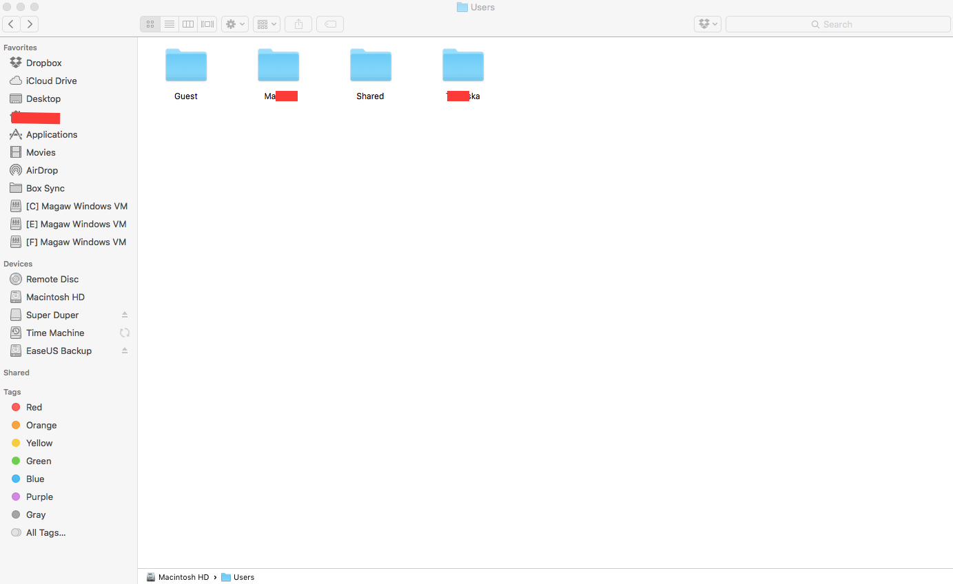

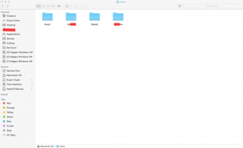

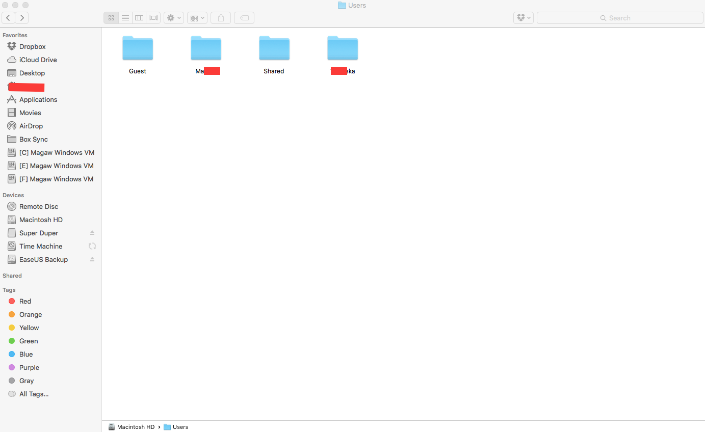

So I was about to try Enric0's idea but thought I would do a test first. I created a new Admin account and saved a pdf, contact and Word document in that account. Then I went back to one of the other Admin accounts and deleted the user as instructed above and left the User folder as it was. Then went to look to see if the deleted Users folder was still that and it is not. So I created the new test account again and logged into one of the other Admin accounts. The new test account Home folder isn't listed in the Users folder. There should be folder called "Test" in the screen shot. There is nothing relevant in the "shared" user folder. Why would I not be seeing the newly created users folders? I'm afraid to delete the affected user account because of this.

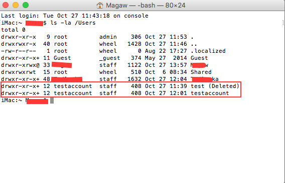

I’m sorry, I don't know what's going on with your Mac but it seems that your newly created user's home folder is hidden for some reason or maybe a third party app (that I’m not aware of) has moved the Users path to another drive / volume (if you didn’t do it yourself, and I don't think so, something wrong is going on here).
Try this: open the terminal and type "ls -la /Users" (hit enter) a list of all the directories contained in the Users folder will be displayed. If you can find your "Test" directory then it means it is hidden and you can try this: "sudo chflags nohidden /Users/Test" - you have to input your user password to execute the command and after the execution the "Test" folder should be visible also using the Finder.

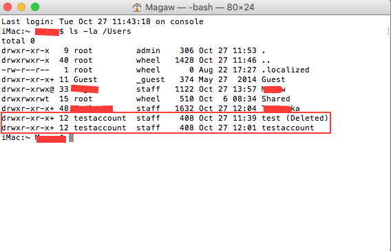

Well, I ran the first command and did find the test accounts. I believe the screen grab shows the account that I deleted and the new one I created that hasn't been deleted yet. When I ran the second terminal command, it initially asked for my password but kept rejecting it. Now its not asking for my password and is instead just saying that there is no such file or directory. Neither user folder is visible yet under Users.
You have a "test (Deleted)" folder (as of my explanation, the system had not deleted it but renamed it) and a "testaccount" folder that belong to your second account created and both are hidden indeed.
So you have to run this command < sudo chflags nohidden "/Users/test (Deleted)" > and this one < sudo chflags nohidden "/Users/testaccount" > to make both directory visible in Finder. Type the command inside <> including the quote marks. When prompted to enter the password, you should input the password of the account you are currently logged-in.
