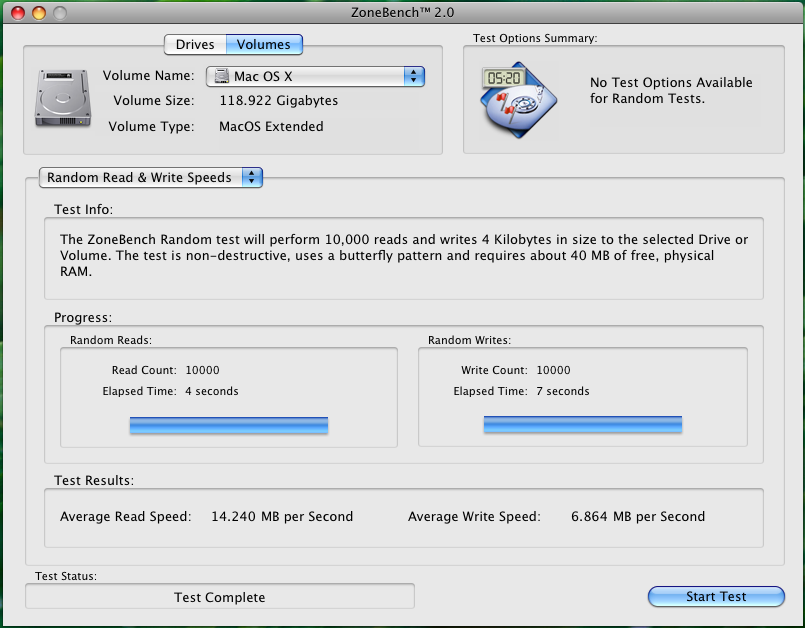

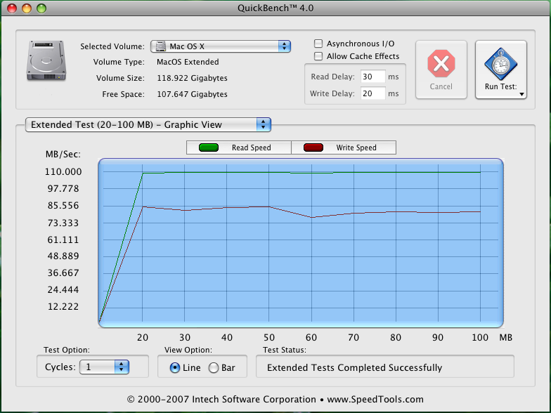

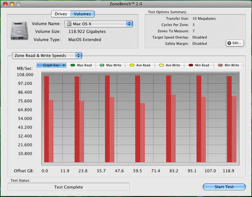

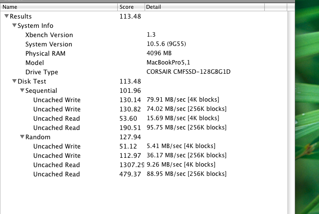

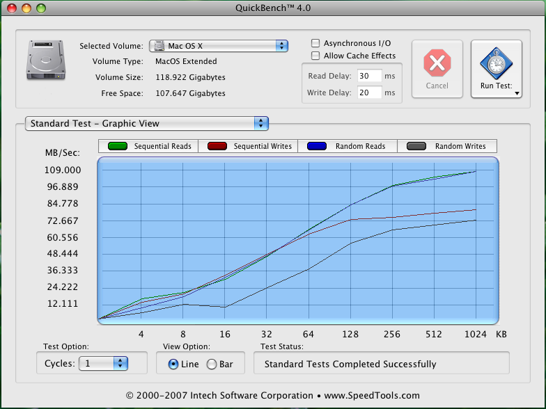

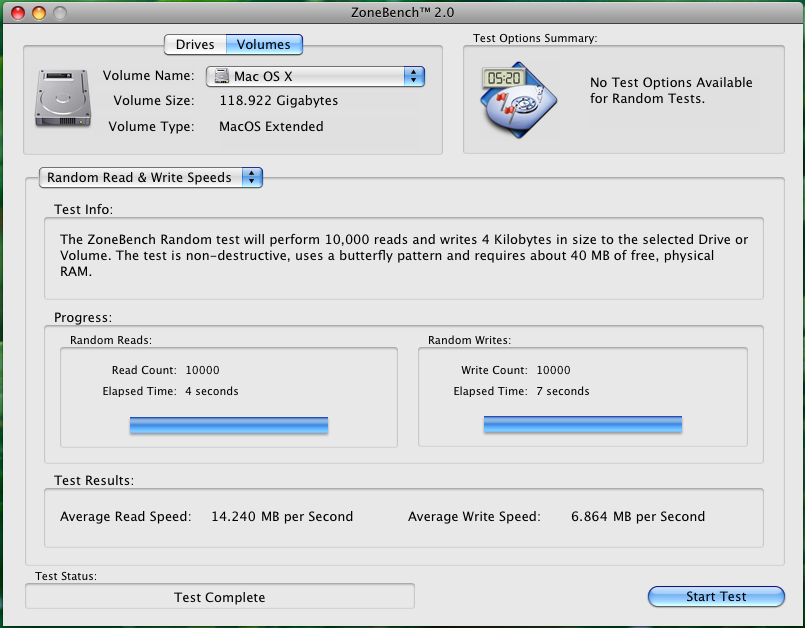

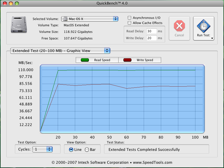

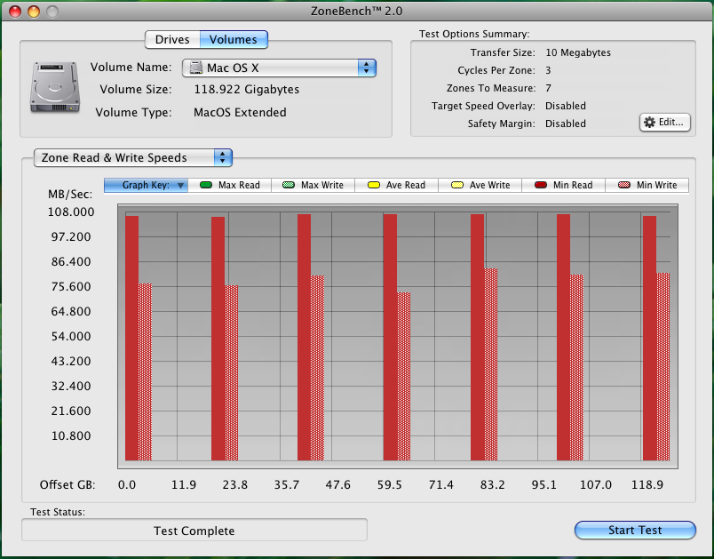

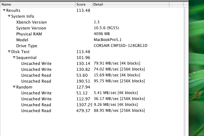

Hi. I've just installed the Corsair 128GB SSD in my MBP. This is basically a rebadged samsung mlc. It is rated for 70MB/s write & 90 MB/s read. It should be identical to the upgrade you can currently purchase on a unibody MBP in the Apple store. But according to my benchmarks it outperforms its specifications.
It seems to be 80 MB/s write and 110 MB/s read!!
Unlike the power hungry OCZ apex/vertex and G Skill Titan this only uses 0.4W in operation. I think this is probably the best performance/capacity/power balanced SSD on the market right now.
Anyone else got this drive yet?

1) Does bootcamp work on it? Did you experience any stuttering?
2) What is your MBP spec?
3) What was your previous HD?
4) How big of improvement did you notice from previous HD?
Yes bootcamp works fine, no stuttering as the samsung controller can get ~1700 IOPS @ 4kb. Most of the jmicron ssds (ocz/g skill/patriot/etc.) can only get 4 IOPS @ 4kb hence stuttering!
2.4 GHz unibody Macbook Pro / 4GB Ram
Stock 5400 rpm hitachi
Big improvement overall. Boot up/application opening/loading photos/loading pdfs are all miles better. Parallels desktop VMs load very quickly. Whole computing experience much smoother. This proves that raw sequential transfer speeds are not the biggest factor to consider. I guess if you were constantly duplicating large files (>10MB) then other SSDs may be better for you but I rarely do anything like.

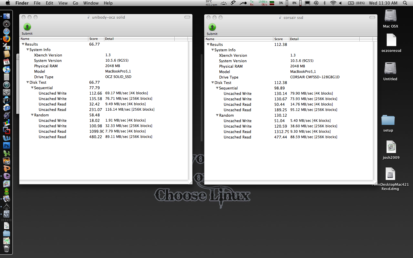

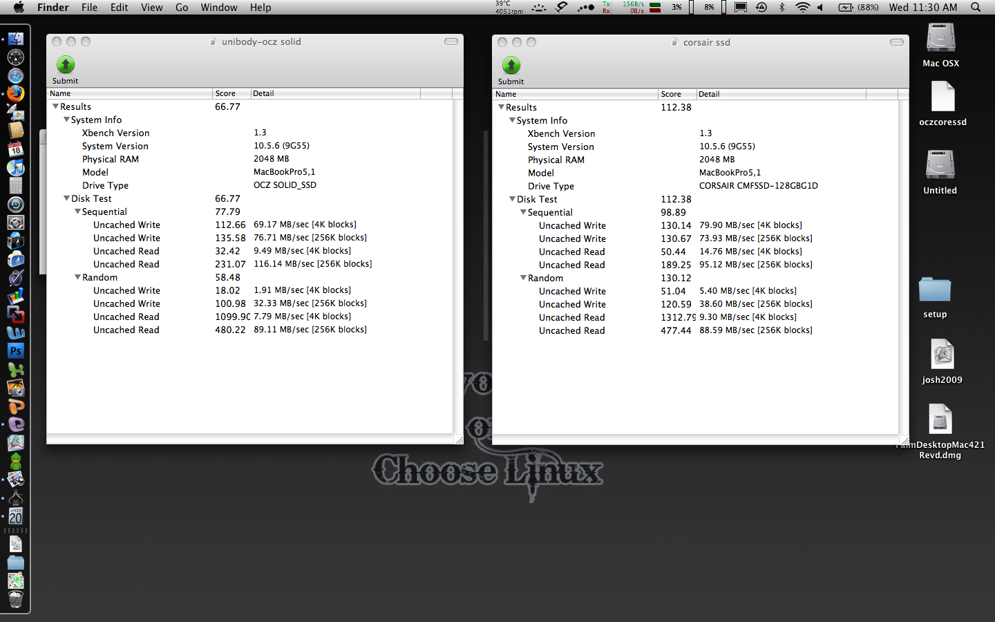

hi,
i too have the 128gb corsair ssd in my unibody 2.4ghz mbp
the drive is very very fast, xp boots great , vista boots great , windows 7 i cannot get working.
i had a ocz solid in here before. which i have benchmarks for and will post shortly. and of course the new benchmarks with the corsair...which match the other posted.
definitly worth the price.
bench's
hi,
here are the benchmarks i have
