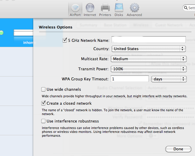

You need to open the airport utility app and change the wireless network name for 5G to something other than the regular wireless name.
Like this :
