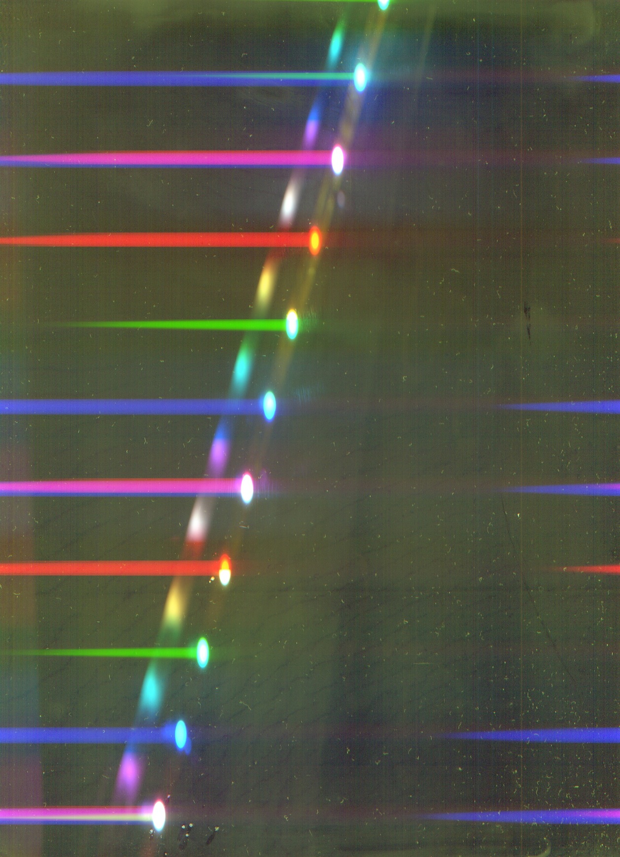

About a year ago, I used an Epson Perfection 1250 scanner to capture a strip of color changing LED lights from about 2 feet away. What I got was the uploaded image.
I recently tried to re-create the effect with an Epson Perfection 1600, yet I was unable to get the streaks of light that I achieved in the original.
What was going on in the original scan to make it come out like it did?
It's caused by the way the scanner works. A scanner is a bit like a camera - it has a sensor to record the image, and a lens (or mirror) combination to focus the image. The difference though is that the sensor records a single line instead of a whole scene like a camera does, so it has to 'scan' down the page taking lots of one-line images as it scans the page.
If you hold something far away from the scanner, it's effectively 'out of focus'. On a camera a point of light (like the lights you were holding) turns into a blurry circle when it's out of focus, but the optics in a scanner are different - quite often they focus in a single direction, meaning when it's out of focus you get a line. This is what you captured.
