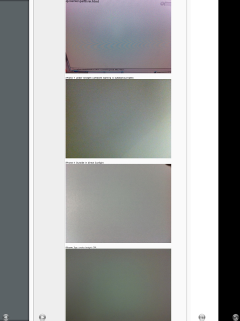

I've been doing some thinking about that GreenBlob affect that's plagued some iPhone 4's.
Could the lens be sensitive to the light spectrum that is CFL lighting (and light from LCD screens, maybe?!) that it would cause a type of 'burn' on the lens and thus creating the error?
I wouldn't ask anyone to do this, but I'm just wondering. If you have 2 iPhone 4's and one is experiencing the GreenBlob affect and the other is not. Take the none affected iPhone and take a picture of a CFL light, like in some office buildings, hallways... (think about the ceiling lifts at a Wal-Mart store) and see if this would recreate the issue.
I have a hunch that it might.

It's been explained many times. It's the relationship between the flickering fluorescent lights and the slow electronic shutter. Basically the lighting and white balance are not consistent during the exposure.
Similar problems can be shown on any camera. With a more sophisticated camera you can avoid the problem with a higher shutter speed, change in ISO, lighting etc. With a simple camera you can only change the lighting, location etc.
Change the lighting or the location. Use incandescent lighting, turn on the flash, open the windows to let the light in etc. There are a lot of solutions.
