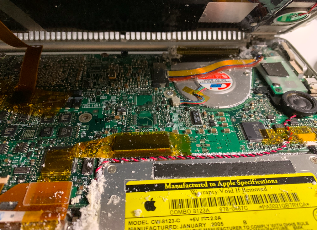

Hello, I picked up a PowerBook 15" and nearly fainted from the vinegar smell emanating from the PowerBook. Screen is all yellowish-green with no images. There's quite a bit of white gunk on the keyboard and inner chassis.
I opened up the innards to find this - especially the lower left corner (between the hdd and the cd reader). Dried Liquid Crystals from the display?

Ick! I’m sorry you’re having to deal with this.
By the look of it and also by your description, it appears this PowerBook was stored in an extremely humid, hot, and possibly coastal environment for a long time. This isn’t uncommon in places where the conditions can be sub-tropical or tropical for long spans of the year (like southern Japan, the southeastern U.S., and so on).
Laptops kept in constantly steamy, hot storage can destroy not only the LCD, but it can also increase the reactivity and volatility of other chemicals (like solder) on the PCBs, the battery, and other components (and is why tech specs typically list the limits of storage conditions in terms of both temperature and humidity). The crystals are probably various salts which precipitated out of the humid air and bridged between metal (a conductor) and the semi-conducting board.
Whatever you do right now, don’t power it up!
The LCD will undoubtedly need to be replaced, as will the battery. The rest might be salvageable. Keep reading.
You’re going to need to completely disassemble this entire system and clean out every component as well as you can. This is going to be a multi-day process, so set aside time and space for it.

First step: rinse and soak disassembled components in deionized/distilled water for a few minutes at a time. You should probably do this for a couple of hours, at minimum.
Next, you’ll want take a toothbrush and very gently remove the now-diluted, softened crystals. Repeat this until all visible residue is removed.
To dry the parts completely (over a couple of days), pour out the large bag of cheap rice into a large rubbermaid-type container and submerge all the just-wetted parts in that dry rice. (Rice is hydrophilic, so it will suck out moisture in tight, tiny places you might not be able to see.)
Next, using the cleaned out rubbermaid container, put the board and other connecting pieces in a bath of 91% or 99% alcohol (I prefer 99%, if you can get it) for about a day. Cover it. About halfway through (12hrs), open the container and gently agitate it side to side to release any dissolved oxidation/rust.
After a day, take out each part, inspecting them thoroughly, and use the cleaned toothbrush, soaked in fresh alcohol, to remove any stubborn areas remaining (again, very gently!) This stage is when you’ll find out whether any transistors/capacitors/resistors have lost their solder points. It is entirely possible some may fall off (which would portend that the board is ruined). Let everything dry thoroughly, maybe up to a day.
If, at this point, nothing has fallen off and nothing in your visual inspection revealed broken solder points or other unfixable corrosion, you should be able to reassemble everything (with a replacement LCD or connected to an external display).
Thank you so much for your advice! I had bought a replacement LCD for this, definitely vastly underestimated the amount of cleaning up to do. You are right, I'm near the the coast (high humidity). I do see oxidation on one of the screws holding the logic board to the chassis.
I have some questions:
  1. Plastic toothbrush - Will this kill the logic board? I'm uneasy with this cos I've previously killed a Windows laptop, with a plastic brush attached to a vacuum cleaner. I'm assuming it was killed by ESD with the plastic brush. I'm in a high humidity area but freak events happen (i guess)
  2. Do the FPC (ribbon cables) go into the distilled water (and through the entire cleaning routine) as well?

You will want a soft bristle brush, like the kind for sensitive gums (avoid the ones with rubber “bristles”, like the ones used for massaging gums).
The idea here isn’t to be scrubbing your board so much as having the brush handy to help remove stubborn clumps which are already wetted/softened. When you use the brush, you want to be extremely gentle, especially around solder points. A good way to imagine it is the pressure you might use to clean a fresh abrasion… with a soft-bristle tooth brush: as lightly as possible.
As for the ribbon cables, I would inspect each one for signs of crusting. At the minimum, any residue should be pre-wetted first, even if you aren’t submerging them (much of a flat ribbon cable is and should still be sealed by the plastic polymer and, hopefully, unaffected by external environment). What I would do with all cables — with all electrical parts, in fact, is — during the alcohol cleaning stage — to submerge them in the alcohol and let them soak.
For something like a PowerBook, the aluminium shell itself shouldn’t need any alcohol, just a distilled water cleaning and thorough drying (in the rice). The stuff I would let soak in 91/99% isopropyl alcohol, in separate rounds, would be the logic board and also the topcase assembly, as there are a lot of contact points in the latter which, at a minimum, will have had direct exposure to the external elements. It will also probably settle out old dirt and grime from prior use.
After the alcohol baths (in effect, what they are), let these dry for a couple of days, just to be certain (sometimes, after a day, it can be good to rotate them to let out any places where residual alcohol might have pooled up. If, after all of this, you still see residue on the logic board, particularly around solder points, DC-in board, etc, perhaps wet a q-tip with alcohol and gently work those areas.
And, of course, get a good thermal paste before reassembling and powering it on (the GPU may use a thermal pad, but I have had success with the 15/17" PowerBooks just using fresh thermal paste. Hopefully, after all this revival work you should have a system which will power on again and still work.
