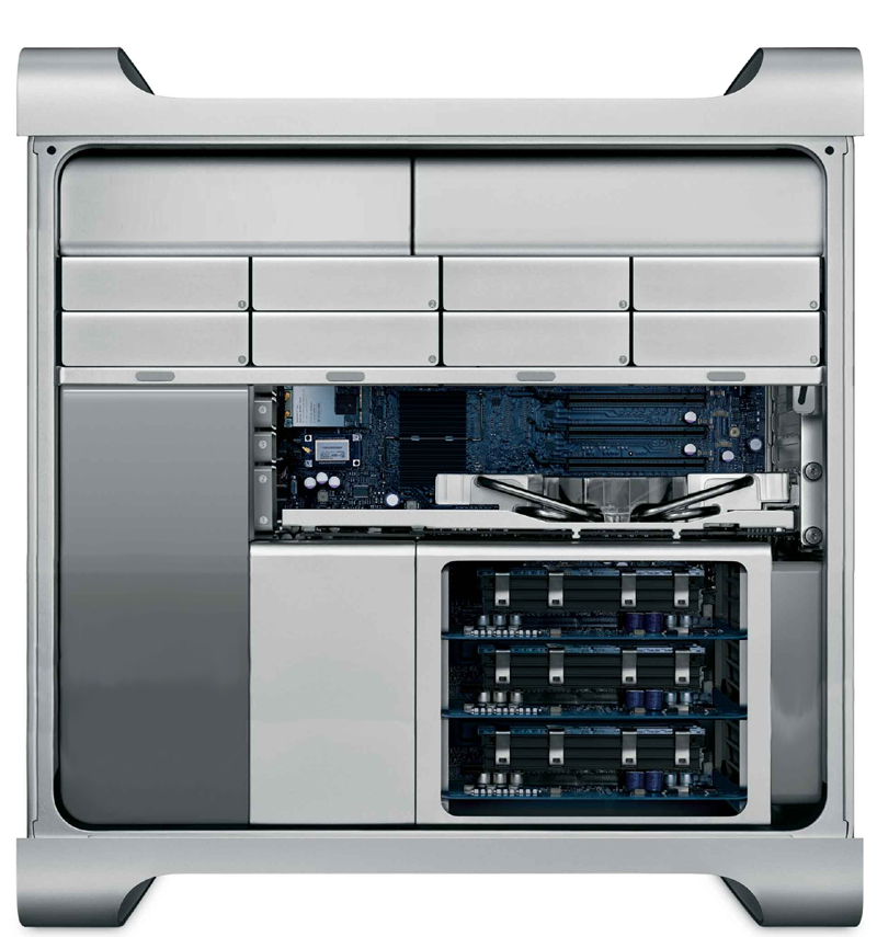

I'm not saying that this is actually what the new Mac Pro looks like but sort of a concept? I got kinda bored...
12 memory slots on 3 risers
8 internal hard drive slots
1 optical drive (kinda like the older G5's)
Why do we need three risers? Six DIMMs per processor means six slots per riser.
And since they're not FB-DIMMs, we can keep the riser cards the same size because we can push the RAM slots themselves closer together since the DIMMs don't need leviathan heat sinks.
I'd much rather have a LONGER case than a taller one...
I was just kinda bored so I was messing around. Just a basic concept though. The case is still pretty much the same size because the second optical drive is absent. There's 3 risers because if you cram 6 onto each one will really kill the air flow especially with those heat spreaders on them. Or there can be 3 processors then if that would work.
But like you said not using them you probably could use 6 though on each riser. Since they don't need those heat sinks. But would really crampen them up.

6 slots per CPU is the limit in the DP boards for Gainestown/Xeon 5500 Series.
You can go with larger DIMM's, but I certainly don't want to see the cost. 🙄 😉
(Too scared to look, but the 4GB DIMM's are already available. Check out Crucial. DDR3 ECC Unbuffered). 🙂

A 6-slot DDR3 riser would need 1,440 pins on the connector. I don't think the whole multi-slot riser thing is really going to be done with DDR3.
Well, then, how will they fit everything into the case? 😕
Unless they make it... *gasp* LONGER! So the darn thing doesn't look like a tiny square! 😀
It's not 1440 pins for a 3 channel riser. 😀
Hint: 1366 pins to the Xeon 5500/Core i7 parts, and not all of them are used (NC). 😱
NC = Not Connected, and are reserved for future designs.
The memory controller has connections for 3 channels, and the DIMM's share the connections for it's channel. The on die mem controller has a selector to handle the additional DIMM/channel.
So half (720 pins). 😀
Quite doable, at 360 pins wide. 😉
The current MacPro design is fine, just a little bit dated. The basic appearance is 6 years old, longer than the 4 year lifespan of the G3/G4 case shape! I'd guess (like TS does so frequently) they will redesign it to more closely match the iMac/MB/MBP/24" display appearance.
4 drive bays is very good, 8 is massive overkill for 90% of MP buyers. FW800 was made specifically for those that need lots of extra storage and eSATA PCIe cards are common. I'd personally much prefer dual optical drives over more internal HD bays.

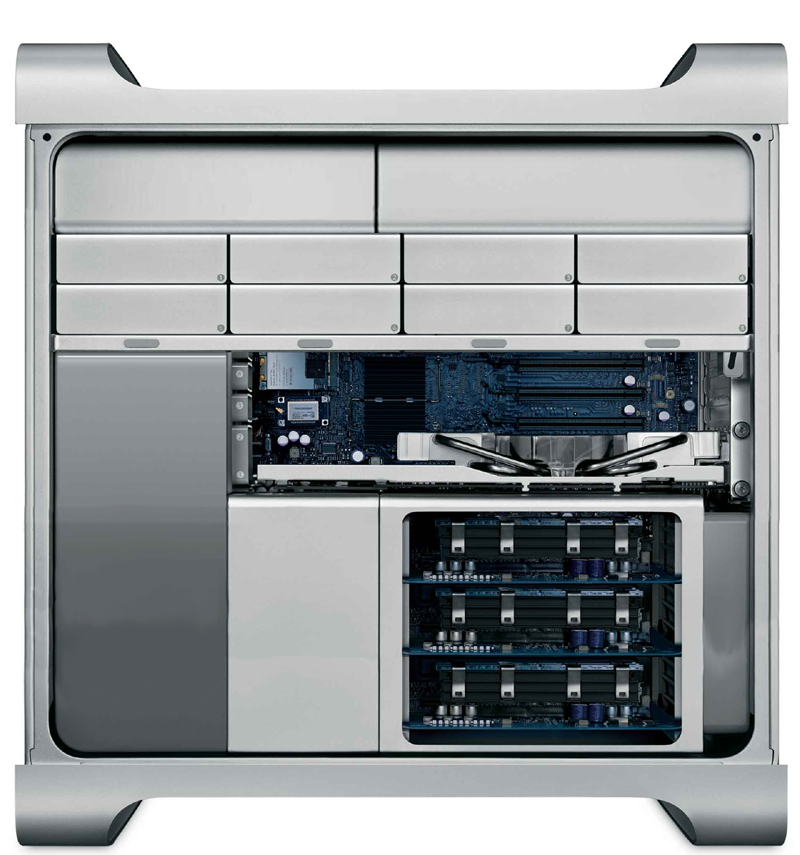

How, exactly, would I gain access to the upper row of disks? 😉
Don't get me wrong; it would be great to have 8 slots, but I could make due with two and an external storage case.
It sucks that every external storage case is insanely expensive though 🙁
