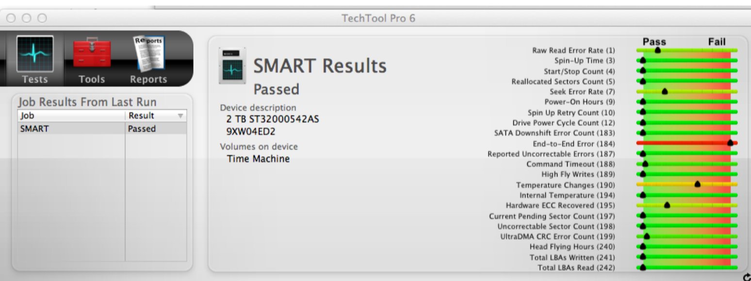

If this is the original hard drive, it's a wonder it lasted this long. I service over a hundred if these for schools and all have had the drives replaced. Not one was good when I replaced it though not all were showing symptoms. This is a typical SMART graph of drives from that time with problems. Notice that this shows Passed.
Although this is a Seagate, the WDs often used on the 2009–2012 iMac are just as bad.
Hopefully, you have a good backup. If not, boot from an external drive if you have one and run Disk Utility as many times as it takes. If you get the same error 3x in a row, give it up. I've run DU up to 50x to get to the point where I can recover the data from a drive.
