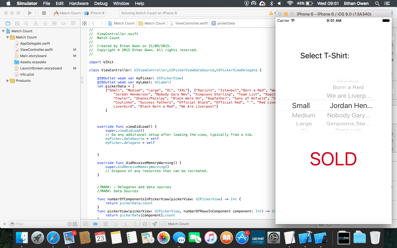

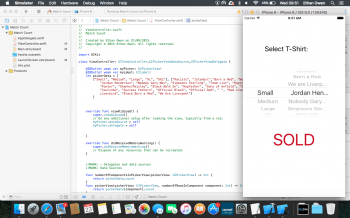

Sorry for bouncing between threads but I think this is the better one for me to continue our discussion. Here's what I have so far:
When pressing the 'SOLD' button, the item selected above should have a 1 added next to its listing in the report. In the screenshot shown above, when the sold button is pressed +1 should be added onto the current amount of that item sold in the report. How could I implement this? I know how to tell Xcode to +1 to a running total but I don't know how to tell it to remember the above selection when doing so.
Also, one thing thats really bugging my OCD is that no matter what I try the content won't centre on the page! Let me know what parts of code you want me to copy/paste (if any), I'll be more than happy to post it.
Thanks for your help so far!

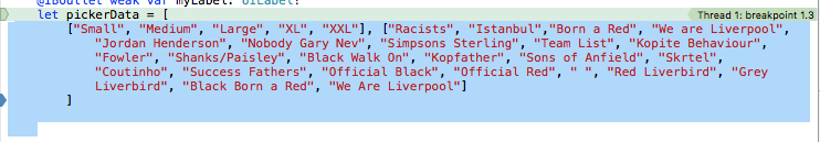

Im now getting a new error preventing my app from launching. I have tried reversing any modifications I have made with my code but its till now working.
Here is a snipped of the part I'm having trouble with, and a screenshot of the error:
Code:
let pickerData = [
        ["Small", "Medium", "Large", "XL", "XXL"], ["Racists", "Istanbul","Born a Red", "We are Liverpool", "Jordan Henderson", "Nobody Gary Nev", "Simpsons Sterling", "Team List", "Kopite Behaviour", "Fowler", "Shanks/Paisley", "Black Walk On", "Kopfather", "Sons of Anfield", "Skrtel", "Coutinho", "Success Fathers", "Official Black", "Official Red", " ", "Red Liverbird", "Grey Liverbird", "Black Born a Red", "We Are Liverpool"]
Screen Shot 2015-09-23 at 10.31.04.png Screen Shot 2015-09-23 at 10.31.17.png

Do you see the part where it says 'breakpoint?' Your code is stopped at a breakpoint.
Since you're going to have long names for the products I would make the right side of the picker wider and the left side narrower. Use S, M, L, XL for the sizes.
Your app needs a data model. This is where your counts are stored. One simple way would be to have a dictionary where the keys are 'product name-size' and the values are NSNumbers. Create a data model class. Add a incrementProductCount(name: String, size: String) method.

A break point isn't an error, it's something programmers use to help with debugging. Did you by chance accidentally click the small grey area between the class viewing area and the area where you write code? A small blue arrow will pop up in that region and will cause the app to "pause", not crash (though it will look like it crashed since it will stop responding), so you can look at what the internals of the app are doing. Those breakpoints can be quite easily set when you are trying to look at an inline error or warning. I find their placement very annoying.

I can see the tip of the blue breakpoint marker on the line that is the end of your array. Click and drag the breakpoint away from where it is and let the mouse go. The breakpoint should disappear in a puff of smoke.
