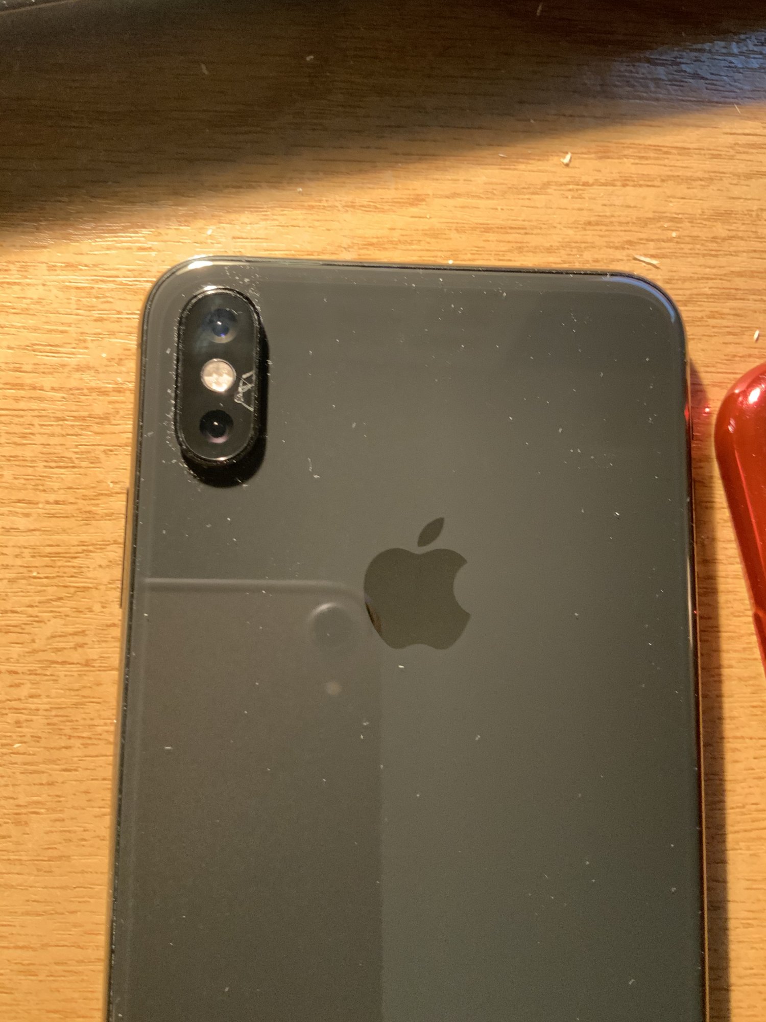

My rear camera has a crack in it, and I have a load of scratches on the front screen.
I usually upgrade my phone every year, but before I trade my phone in, has anyone had both the rear camera / screen repaired / replaced without AppleCare, how much am I looking at paying out to get my iPhone back to its former glory before parting ways with it?

I don't think the scratches will be a big deal as long as they’re not cracks. The cracked camera glass on the back is a bigger issue as it can’t be replaced easily. The only method I’ve seen that is cheap entails chipping the damaged glass out piece by piece until it is completely removed. The catch is the tiny shards of glass can damage the lenses or mess with the OIS so you have to be extremely careful and make sure all debris has been removed. Replacement glass for the camera is available on ebay or other market places. Apple will not repair the camera glass, they will only replace the entire phone at great cost. A 3rd party repair shop will most likely repair it with the method I described, not sure what they would charge though.

Thanks for your reply, here is a pic of the damaged camera.
The front screen scratches are not bad, there is one you can catch your nail on, the rest are micro scratches.

Ok, so what you would do is take a heat gun or good hair dryer and heat the camera housing. You get a hobby knife or a flexible steel spudger from ifixit and gently go between the glass and the steal bezel of the camera housing and slowly chip the glass away until it’s gone.. Then you clean the entire area with isopropyl alcohol to remove any lingering debris or adhesive. Get a can of compressed air for cleaning keyboards and blow any dust or crap left over. Then you drop in the replacement glass which could only be a few bucks at the most and your done. I’ve seen jerryrigeverything do it in a video he made:
