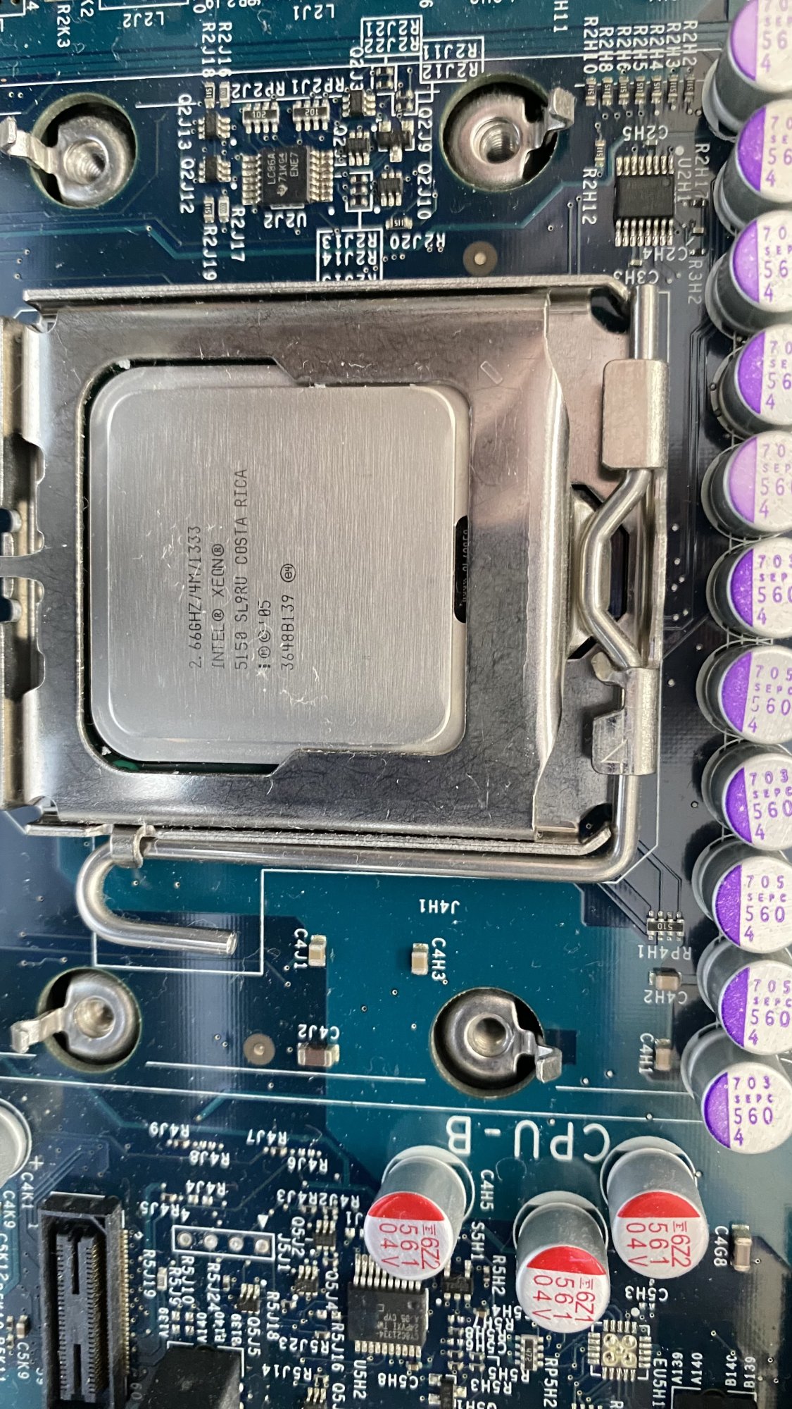

So, I have swapped out Logic Board, Ram, Ram Trays, CPUs, CMOS Batteries, Drives, quite literally everything in this Mac Pro, and it still doesn’t work.
On both the motherboards, with two different sets of Xeon CPUs it says that there is a problem with CPU B with the red light on the Logic Board. How?
The system started to go haywire once I swapped the drives in it, and slowly degraded after a week in to a state of basically none functional. It booted to a black screen and a blinking cursor on the top left.
I tried everything and the system only came up with a CPU error once I changed the CMOS battery, what do I do from here? Should I replace the power supply? Buy new CPUs or buy a new Logic Board?
The original Logic board was flashed to 2,1, and I have been told by the seller of the new Logic board that it also has been flashed. The only symptoms of life that I got, where when I used the old CPUs on the new Logic board. It chimed, went to a white screen, and showed a CPU failure on CPU B once again.
It’s a Mac Pro 1,1 / 2,1 from 2006.
Thank you, hope someone can help or find this at least interesting.
