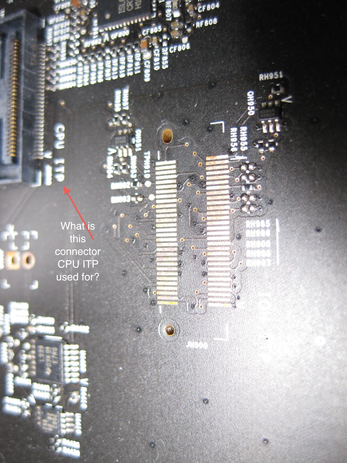

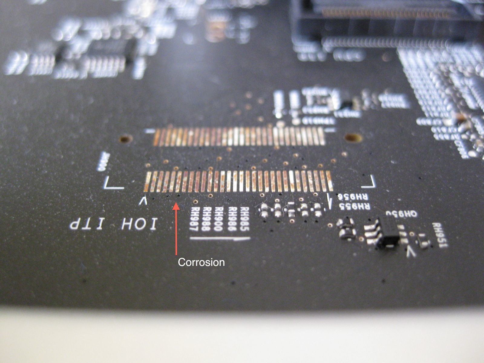

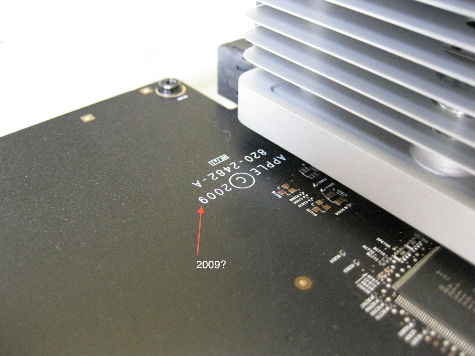

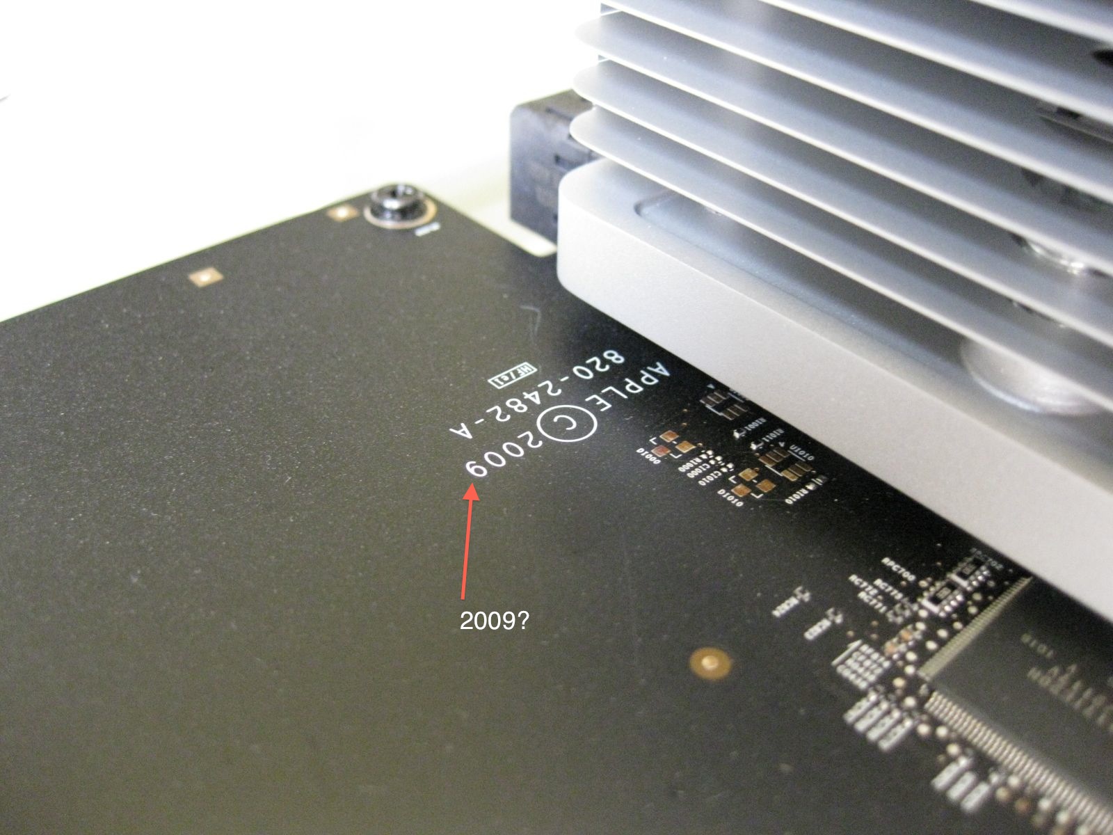

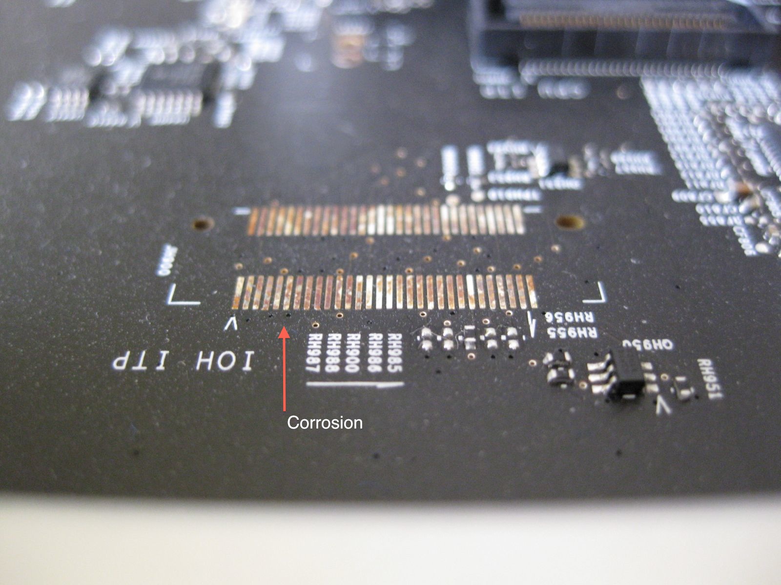

Additionally while I was poking around I found something interesting, the CPU board has a copyright date of 2009 on it. I found this strange because I though that these 6-core cpu's would require a new board design. The reason I bring this up is because some of the areas on the board had corrosion or something similar. See pictures. Should I be concerned about this?
I know I am being a little neurotic, but I spent $5000 on a computer I do not planning on replacing for the next 5 years and just want to put these worries to rest.

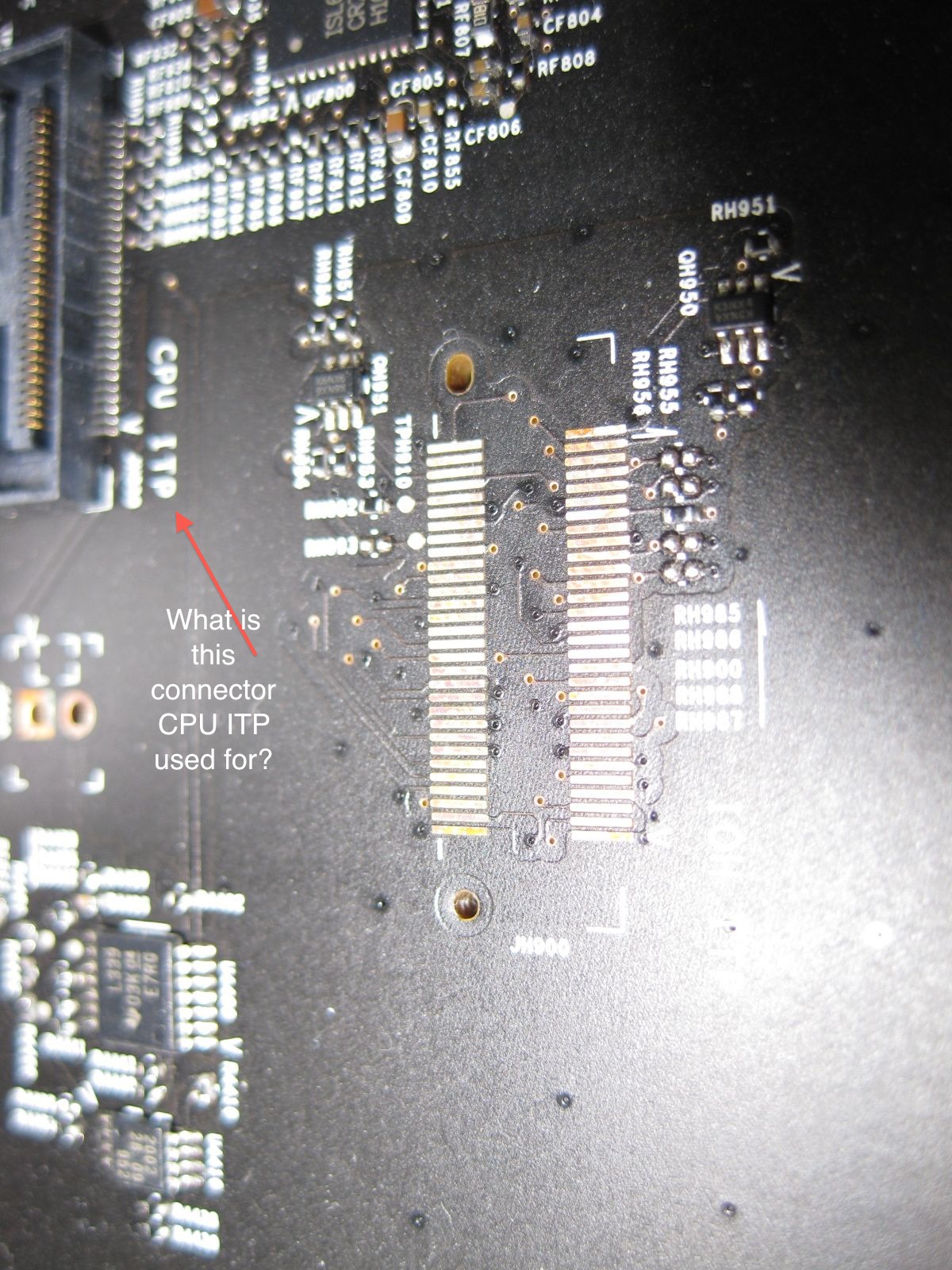

Also, does anyone know what the connector CPU ITP is on the CPU board?

The ITP connector is used for debugging board components.

In regards to the copyright, the year is simply when the design of the board itself was copyrighted. The same reference design can be used despite fitting new components onto the board.
As far as the corrosion, it may not be corrosion at all. Brown color does not automatically mean it is corroded. Have you ever soldered before? Using too high heat can discolor the solder. Chances are, you aren't looking at corroded metal but instead discolored metal as a result of the manufacturing process.
Unless you can tell that it is absolutely corroding, I wouldn't worry about it.

🙂 Cool thanks guys. Yes, I should of known that it could not of been corrosion. You are right about the solder, I am almost certain that is what it is.
