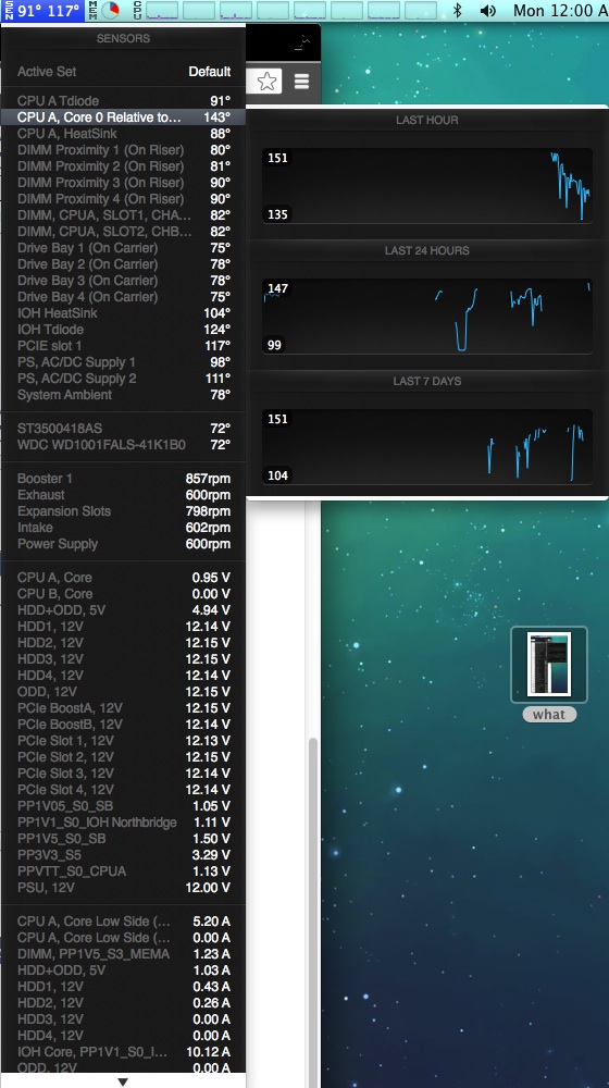

Just a Quick Question im on a 5.1 quad core 2.8 mac pro with istat and im wondering why my CPU Core 0 "runs at 136 degrees at idle" is always 30-35 degrees hotter than CPU A Tdiode wich runs at 98 degrees on idle and CPU Heatsink wich runs at 93 degrees on idle?

It could be any one or a combination of many things including:
  1. the accuracy of one or more sensors,
  2. the difference in placement of one or more sensors,
  3. the scheduler bias of one CPU over another,
  4. the heat sink fins are dirty in one area more than another,
  5. the thermal paste was applied differently on one or the other,
  6. the airflow volume favors one over the other.
and so on.
If I were to guess I would accuse numbers 1, 2, and 6 as being the most responsible - especially number 6. 🙂 And you should be able to tell if it's number 6 I would think... After awhile number 6 will cause a number 4 condition to appear.

This sounds like it may be thermal paste.
Im coming towards the end of my applecare and i want at least one thing to get replaced never had too🙂
Here are the readings im getting
Any suggestions on what i should do?

it says CPU A, Core 0 Relative to Prochot

Back in the Pentium days it was a CPU pin which would go active on "Processor Hot" ... perhaps Intel still uses that term (and pin) today?
The extreme temperature you are seeing only on one location, assuming all continues to run OK, sounds like a faulty sensor to me.

Perhaps the Relative to ProcHot is the number of Degrees F or C that you are FROM the maximum allowable temperature (TJmax?). My Prochot number DECREASES as my Tdiode increases.
That would put your T Diode's maximum 'safe' temperature at 234F (or 111C) more or less (91F + 143F). I presume that this is the temperature at which your system would shut itself down to prevent damage from overheating.
I always understood that anything above 100C was too hot.
If all of this is the case, then the high number that you see (for Relative to Prochot) is possibly a good thing.

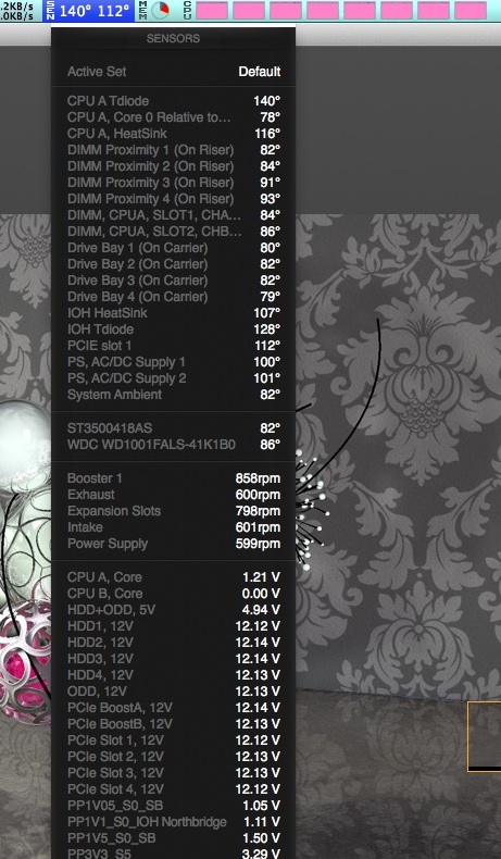

Try stress-testing the CPU and see what the 'CPUA Relative' temperature does. Open Terminal and type: yes > /dev/null &
Do several of these until your CPU cores are being heavily utilised.
To stop the testing, type: killall yes
When i stress the cpu and the temp rises the prochot goes down. I understand now thats how much more degress the cpu can handle...does anyone else have that feature i have the latest update to istat wich i think is 4.06
What sort of temperatures did you see in iStat when stressing the cpu?
What was your CPU T diode? And what was the Relative to....?
Here are my Cinebench results.
My temperatures are higher than yours, so I am the one that needs to be concerned.
You topped out at 60C with no increase in fan speed.
I only STOPPED at 72C because the CPU fans were going faster. And because the test was short.

I am paying close attention to my CPU temps because I've just replaced my W3520 processor with a W3570.
I am concerned that my choice of thermal paste and/or my method of applying it may be contributing to these higher temperatures.
I used Noctua NT-H1 paste.
I would like to see others in the forum who've swapped CPU's in their quad-core Mac Pros post their CPU temps and share their choice of thermal paste.
I'm beginning to wonder if Apple's thermal grease is particularly optimised to work with their heatsink. And that applying any other random thermal paste will not yield the same quality of cooling.
