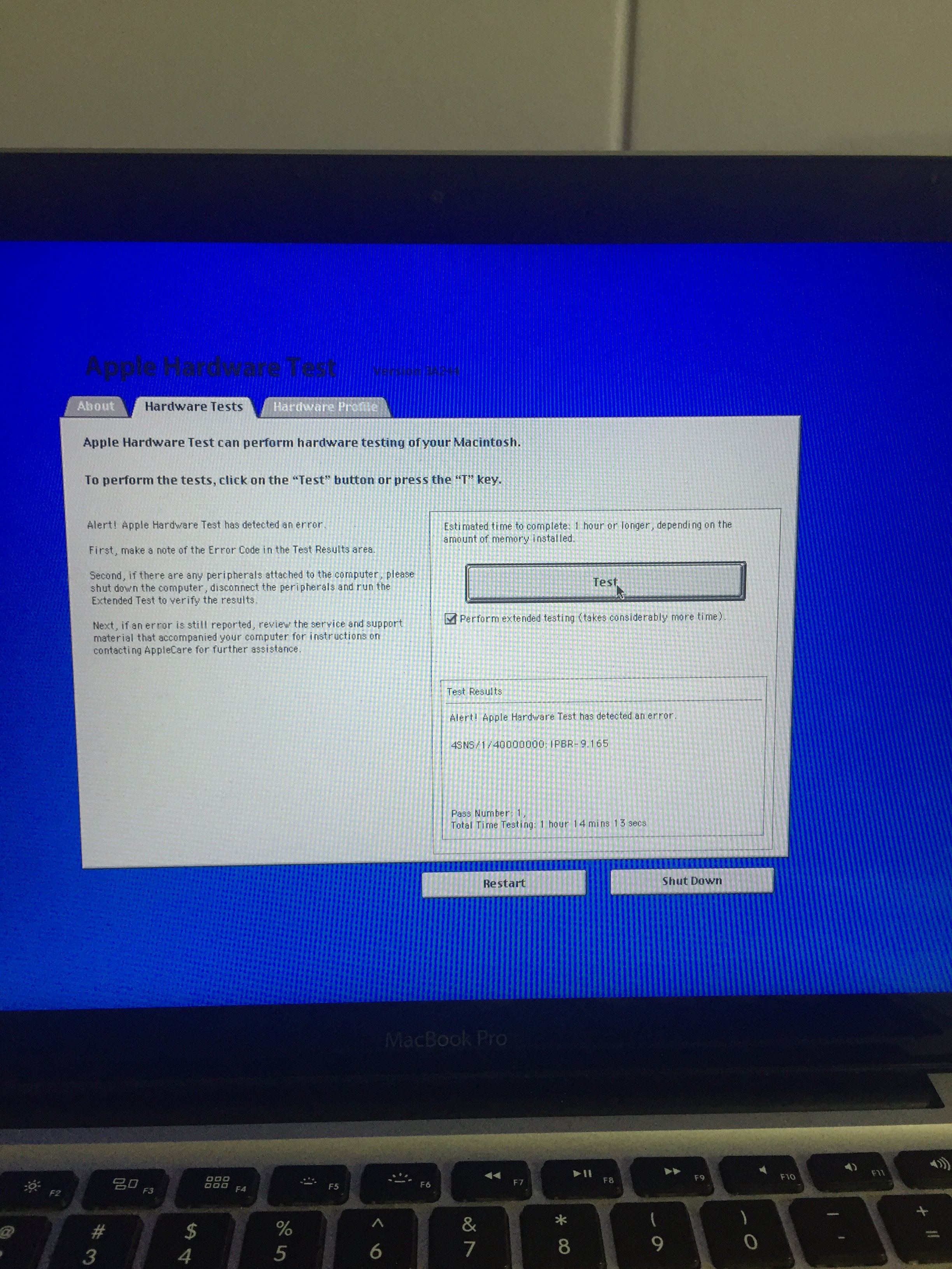

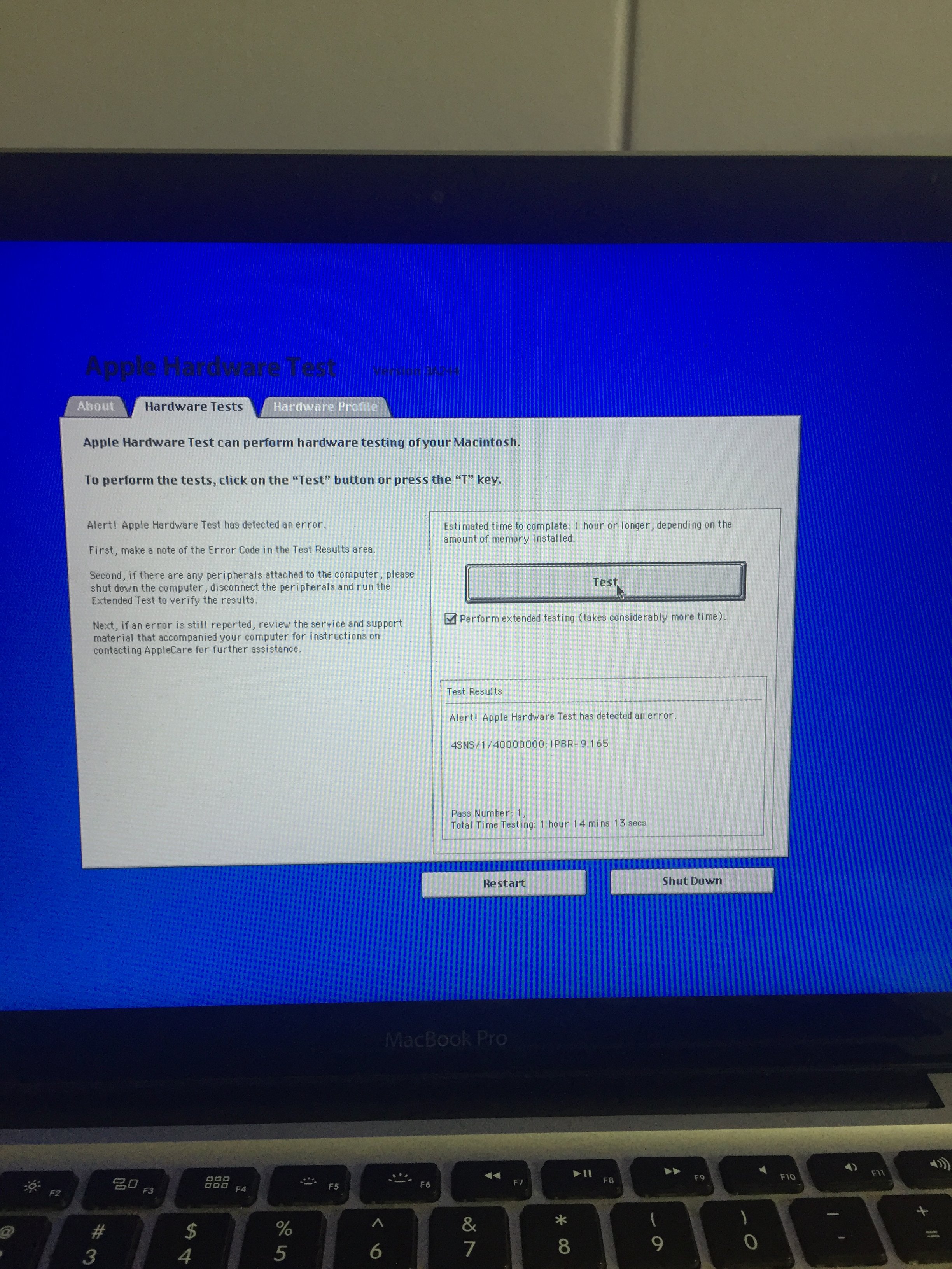

Yeah it's an error accessing the network before the online AHT. I tried it on a different network and it worked. The result is attached. So I guess it is indeed a hardware issue.. Do I have to replace the motherboard?
What was the error? The attached picture was too small to read, at least for me.
IPBR means that the sensor that reads the current on the Power Bus (PBUS) is not being read. Any time the SMC cannot read a sensor it "protects" the hardware by running that kernel task, using up all your resources. There used to be a plist hack but that was on older pre-2012 models I believe. You either need to have someone fix your logic board (who knows what they are doing) or get it replaced by Apple. Apple won't repair the board... they only swap boards.
Usually sensor failures are related to liquid spills but not always.
That seems to be it. Thanks so much for your input and everyone else, I guess I know where to go from here.
